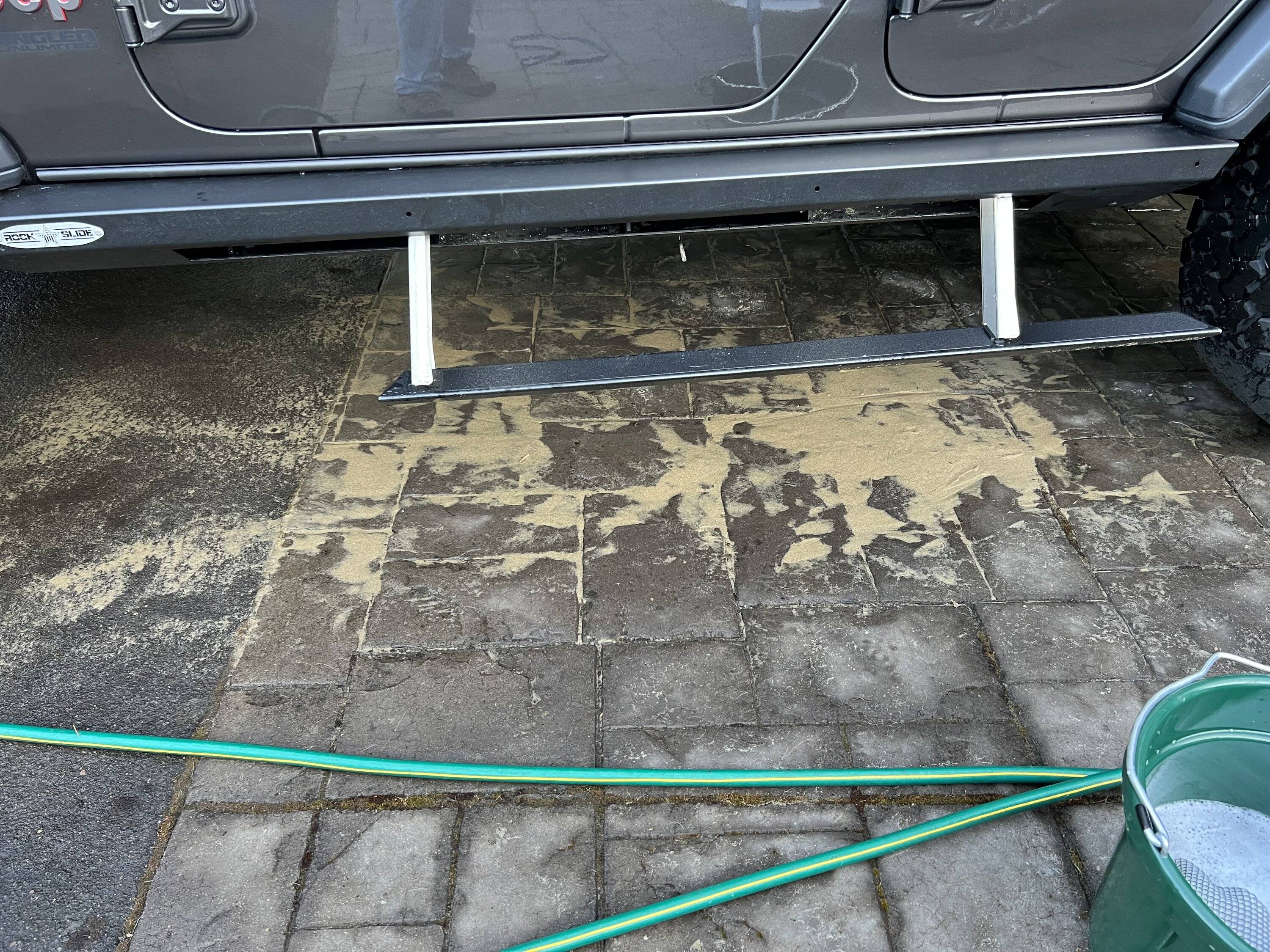

The RSE customer service has been very good, and the design and construction are good, but these steps will continue to require attention and regular maintenance as long as you own them. Depending on your use, they may require a LOT of maintenance.
If you run on the sand/beaches the steps will get packed with damp, salt-laden sand. If you don’t drop/open the steps and rinse them thoroughly, which takes at least fifteen minutes per side, you’ll be leaving salt and grit against your wiring, motors, and articulating joints. That won’t end well. It’s a similar scenario if you run on snow and ice laced with salt or mag chloride. Mud isn’t great either.
If I go to the beach I’ll spend at least a half hour rinsing the steps out. Then I let them dry. Then I lubricate/maintain them according to the RSE instructions. That’s no big deal on a warm Sunday afternoon when you have nothing better to do. It’s more of a chore when it’s 20 degrees outside, the steps are packed with snow, ice, and salt, and you don’t want to hook up the hose, freeze your ass off, and turn your driveway into a solid sheet of ice.
The sand in the picture below is what was left on the driveway after a few hours on the beach followed by a 250 mile drive and a 30 minute rinse. Most of the sand was washed out of the picture. That sand and salt can’t be allowed to work back and forth against the guts of those steps.
