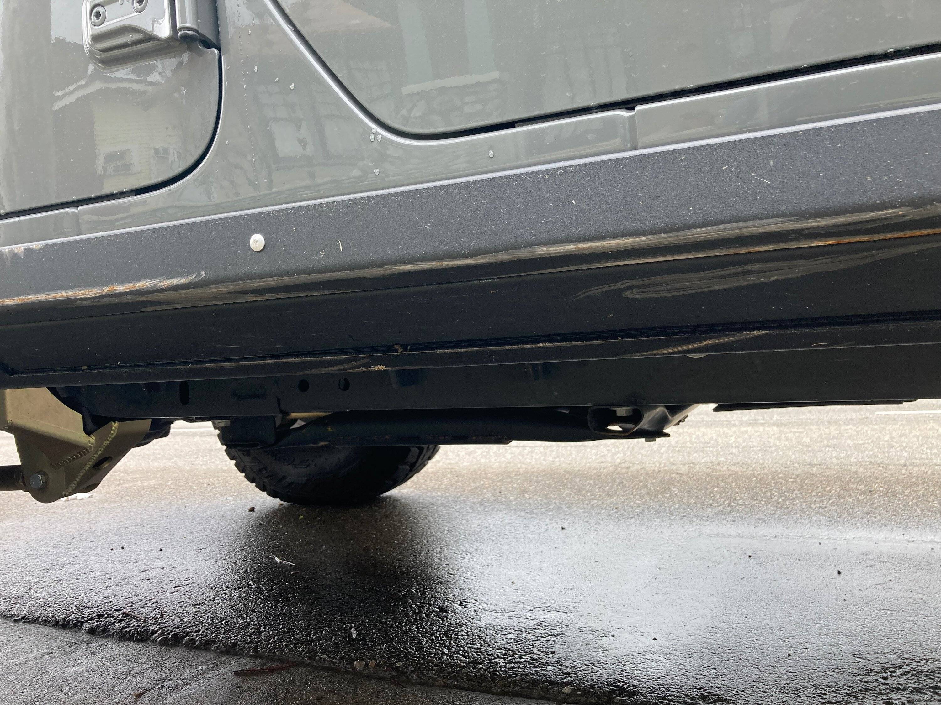

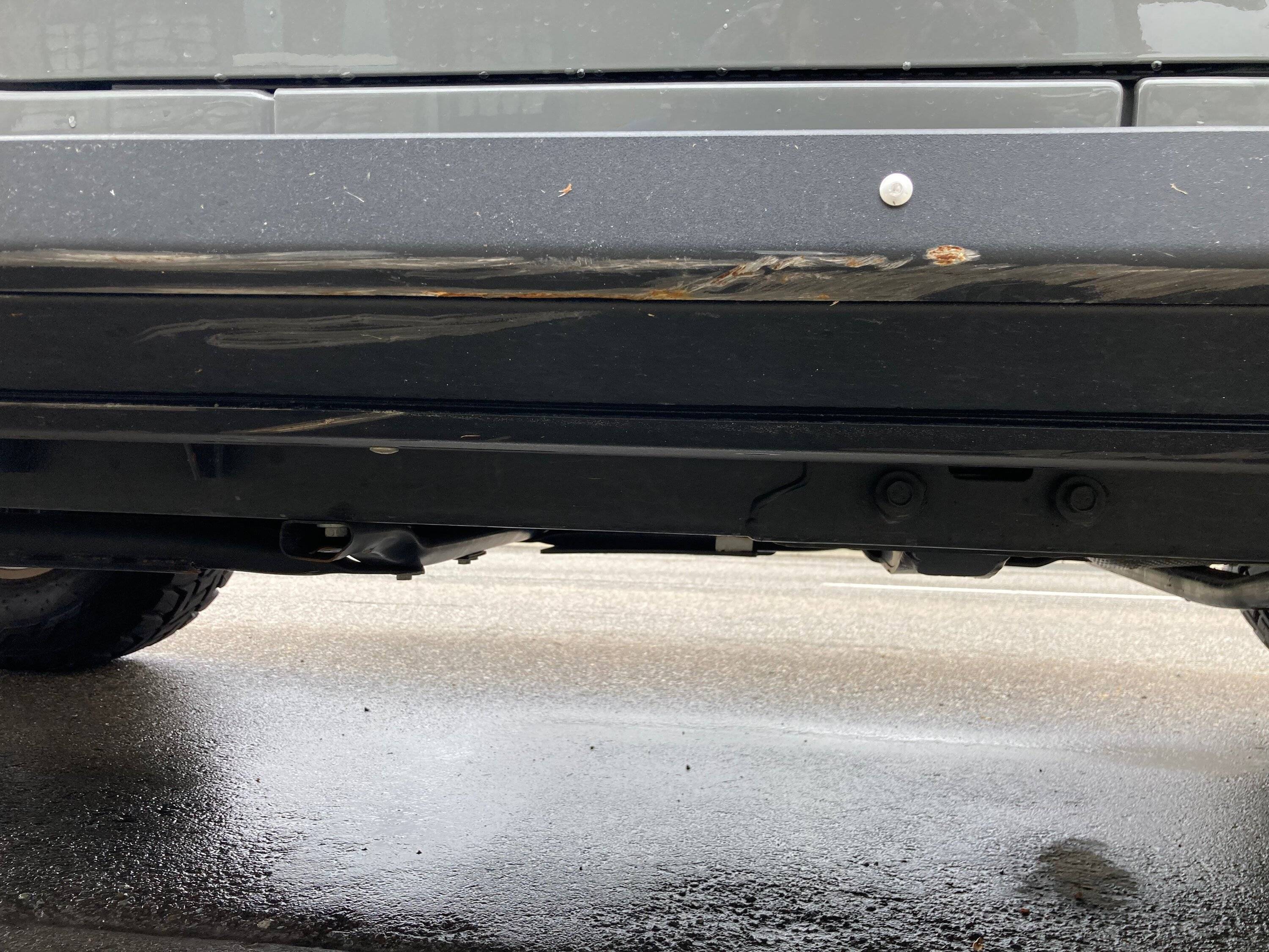

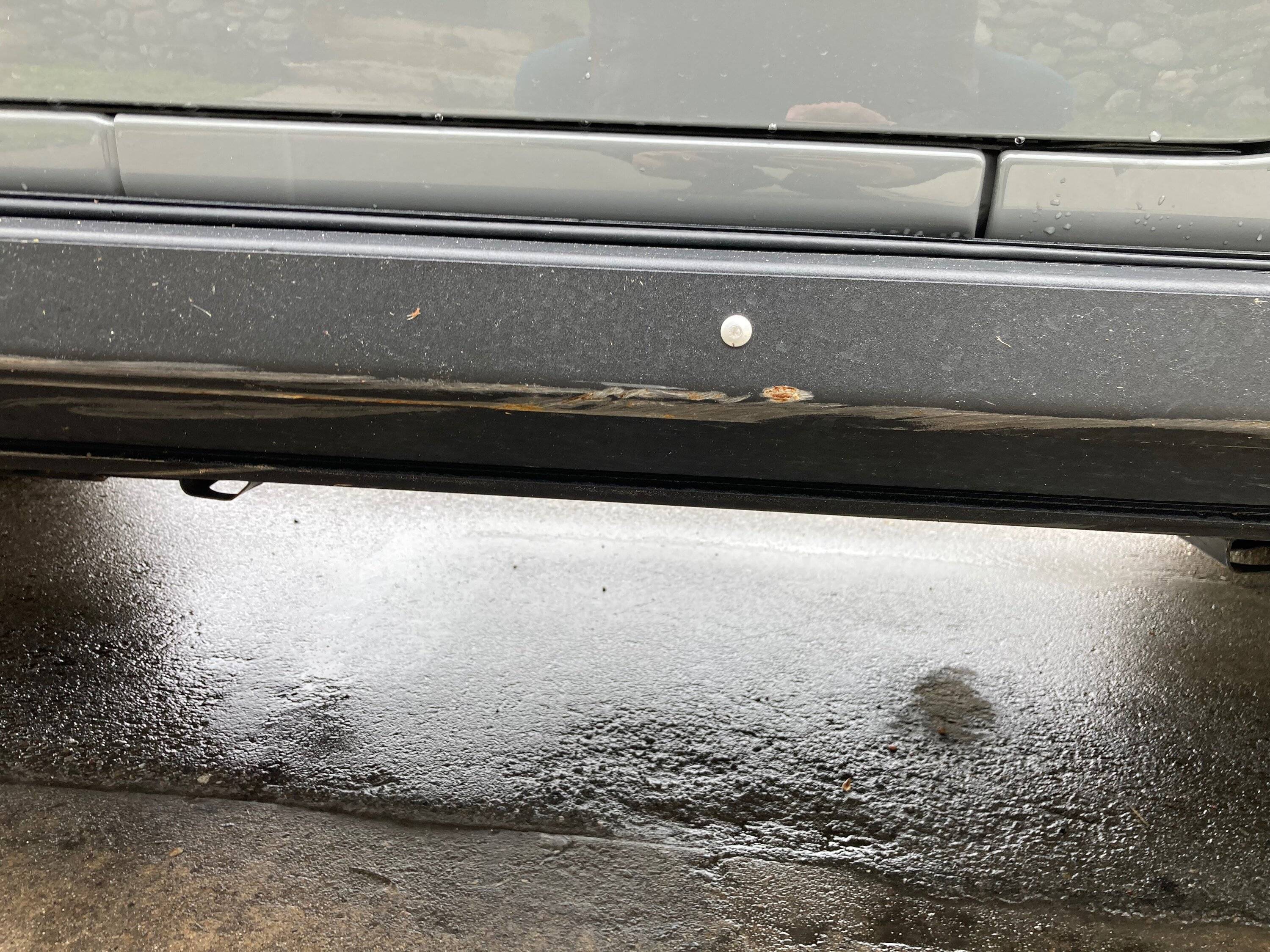

I have them on my 21 JLURD, with a 3.5" lift and 37s, my wife also needs the boost to get in and I have found them very helpful as well at times. I would absolutely buy them again, I also got the additional skid plates for them and recommend those too, they handle slider duty very well.

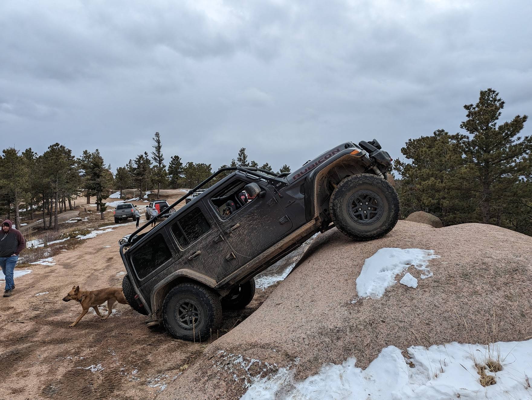

They work exceptionally well. There have been many times where they came in handy to be able to exit / enter when doing stupid stuff like this:
Jeep Wrangler JL Opinions on Rock Slide Engineering Gen3 Step? PXL_20230115_221217617
I've had them blow a fuse once while on the dunes in Oregon. As always: bring fuses.
If you plan on doing more extreme stuff then get the protective skid plates.

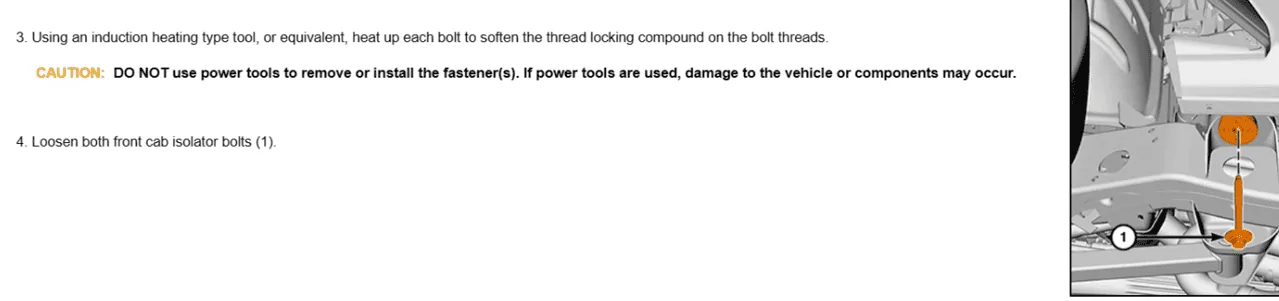

WARNING - buy yourself an induction heat tool for the body bolts that must be taken loose. FCA uses a full pint of LocTite on those body bolts. It can sometimes be done without heat, but not on a cold day. And it's a hairy risk to those bolts!!!. You can buy a cheapy induction tool for about $200 on Amazon, or do like I did - wait until you BREAK A BOLT and order a $450 dollar good one and wish you had bought one before.
Anyway, struggling with back and forth, 1/16 turn out, 1/16 turn back in, back and forth, finally got the body bolts on the JLU loose enough to install the step brackets.

Thanks for all the detail. I've read about body bolt nightmares in other places. Seems like I need to get another tool. Oh, darn! LOL!!
This is from the FCA "how to" on removing the cab bolts........... wish I had seen and paid attention to this before I did my JT. Sadly, it's going to cost me big-time now, likely more than the tool would have cost to begin with, not to mention the ton of time already spent getting those cab bolts loose.
