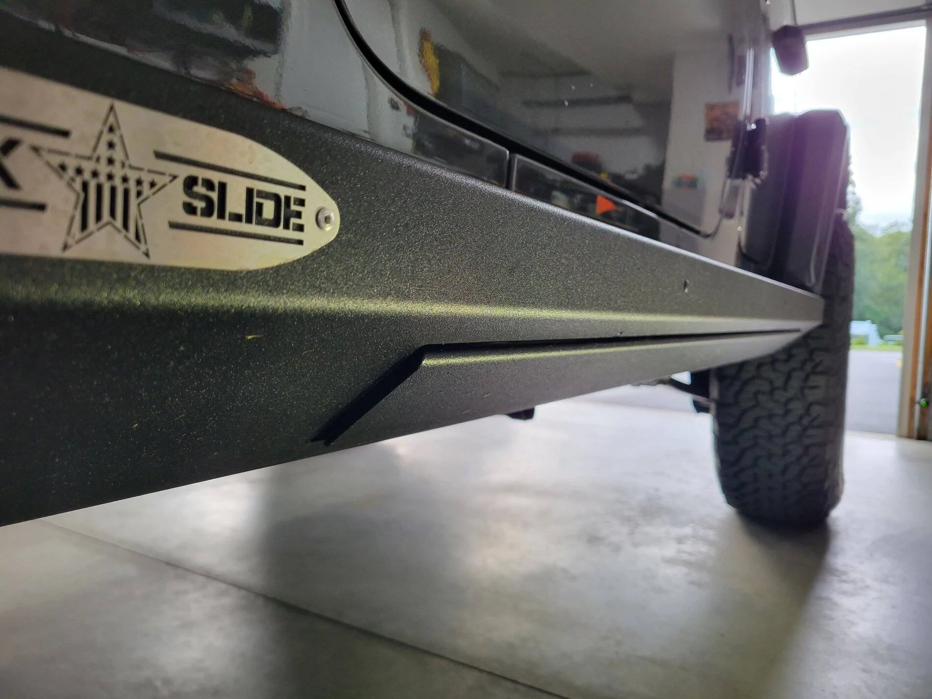

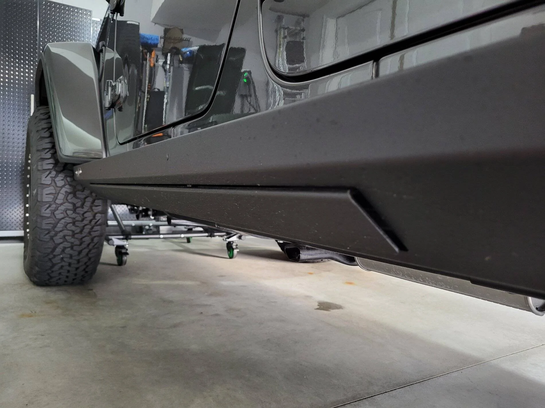

My experience with the new Gen 3 install......
I revisited my previous comment after a couple critical replies to it. I really wanted to give these steps a try on my Jeep. So I ordered a set after evaluating all the comments again.
They came very quickly, with the LED light set following a few days later. Packed very well and all the hardware and instructions were very clear.
I did have some previously installed tube step/sliders to remove first. So now I have the original Rubicon rock sliders and some tube steps sitting in my way. (Jeep parts, right?!)
The wiring harness was a bit of a chore. It was a struggle to get the fuse holder through the small gap between the firewall and fender/liner. Getting the driver side plastic trim removed was also a bit aggravating and I seemed to have broken a couple very small tabs that capture the trim in place. It did snap back in and seems secure. More about the trim later....
I wanted to tackle the 6 body mount bolts next. They are tight, no doubt. I used a long 1/2" breaker bar and worked them back and forth, no more than a quarter turn at a time. I did not need to use any heat on them. My JLUR is a '21 model and had the big washers captured onto the flange of the body bolt hex head. Once I was satisfied that I had them well broken loose, at least 3 full turns, I used my 1/2" impact to spin them the rest of the way out. Took the bolts to my bench grinder and with the washer against the side of the wheel, a quick spin was all that was needed to get the washer free on the bolt. These washers have to be free to allow the slide step mounting brackets to go in place. I covered the fresh grind marks as well as the threads with a liberal coat of anti-seize. They were not any trouble to get started back in place (someone had mentioned once they were difficult??)
I supported the steps on my roll around motorcycle lift which made it fairly easy to get them into position for the mounting bolts to slip through the holes in the pinch weld. The passenger side seemed a chore, but I guess I just had to get the angle right. The driver side slipped right into place much easier. (always easier the 2nd time!)
When I placed the door sensors, I carefully drilled about a 5/16" hole through the flange of the B pillar trim and then routed a slot from the hole with a Dremel for the sensor harness to pass through without being pinched. I don't know that this is necessary, but it seemed like a good idea. The rear door magnets seemed a bit problematic to get to stick to the foam. I ended up using a bit of Weldwood contact cement to get them to stay. Maybe because it was pretty cold in my shop that they didn't want to stick to the foam.
I also installed the optional light kit and I think that is a real nice addition, it looks great in dim light. They don't really light up the rear part of the step, but the front is very well lit up.
So far, everything deploys and retracts as it should and is pretty quiet. I sprayed all the moving parts with some good quality lube and will continue to do that. I don't live where we get much snow, so I won't have to deal with slush and salt buildup unless I travel north. My wife can get in now, so I am done with fooling with a step stool for the time being. I had already backed over one of them this past year after forgetting to put it away.
All in all, very satisfied with the quality and the look. I hope I have good luck with the functionality.
