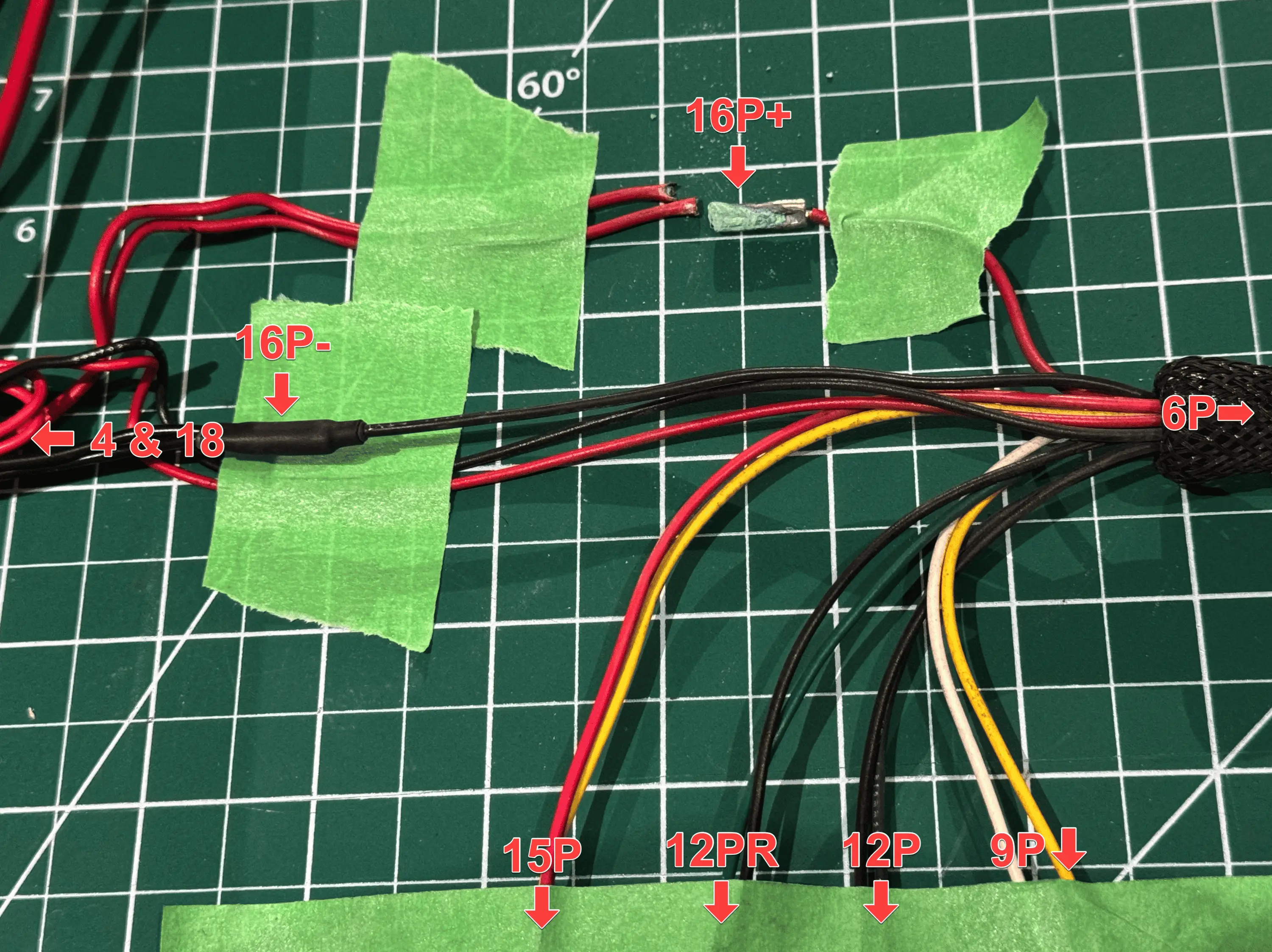

Just wanted to add an update here. Got my step sliders installed in mid-June 2022, they worked great until Mar 2023 when the passengers side started closing with quite a clang. RSE sent me bump stops which settle the issue for a few weeks. Then the passenger side started having conniptions. It would cycle open and closed several times on opening or closing the passenger side doors before settling the appropriate open or closed position. Once or twice it did this while the vehicle was in motion (doors closed of course). I tried pulling the fuse the reset the system, but with no success and eventually the passenger side stopped operating completely. Driver side still worked.
I got too busy to troubleshoot or follow-up on it, but fast forward a few months into Nov 2023 and contacted RSE, they initially thought it was a bad controller, they sent me a new controller/motor assembly. Unfortunately that did not resolve it. After a little more troubleshooting, they sent me a replacement harness. Replaced the harness and all is good again (equals happy wife).

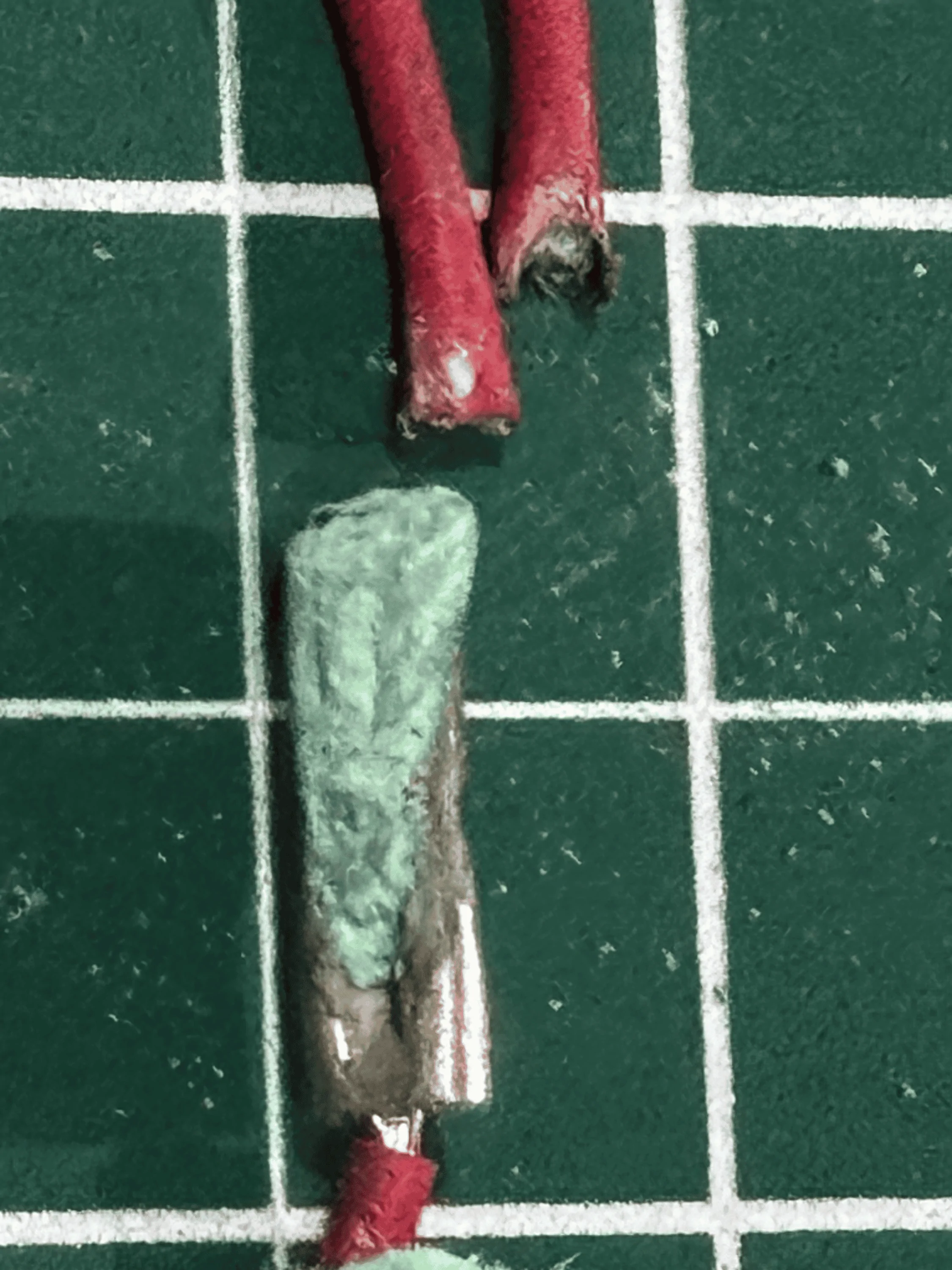

I dissected the old harness and it turned out there was corrosion in one of the crimped butt connections supplying +12VDC to the passenger side controller. I figure this bad/contaminated crimp was made during the manufacturing of the harness as this butt connected was well seal within an adhesive shrink tube.
It been working great since the harness was replaced, hopefully no more problems, but if something happens, I sure know how to test the system now. Kudos to RSE for their support, they gave me a wealth of information about the system.

@WorldExpy where on the harness was the butt connector? I 'm still chasing issues and would love to be able to find it without tearing it all out/apart. Was it close to the controller board in the step?
@jc99, The butt joint hidden withing the braided loom of the wiring harness and within a heat shrink tube. It's around the where the main power +12VDC & GND splits to the Driver and Passenger sides of the wiring harness. See the image below:
Jeep Wrangler JL Rock Slide Engineering Gen 3 Slider issues 1706032601150
From my image below (of the deconstructed cable), the numbered references (in no particular order):
  • #18 (H) - Ground (Bundle of 4 black wires (2 for driver side/2 for passenger side)
  • #4 (Protected side of Fuse holder 'I') - This is a bundle of 4 red wires, +12 VDC (2 for driver side/2 for passenger side)
  • #16P+ - Two of the red wires from #4 connect via this butt connector to supply power to the passenger side. This was the bad connection.
  • #16- - Two of the black wires from #18 connect via a butt connector for ground to the passenger side.
  • #6P (A) - Connector to the control board passenger side.
  • #9P (C) - Aux LED
  • #12P (E) & 12PR (D) - Door Sensors Front & Rear
  • #15 (B) - Motor Power.
I'm not an electrical engineer, so I'm not sure why they doubled up on the wires going from the #4 & 18 to join them at #16+/-. Whether it was to carry more current if needed (in this case could have used a heavier gauge wire) or redundancy, I'm not sure the reason.
Jeep Wrangler JL Rock Slide Engineering Gen 3 Slider issues 1706033904464
This is a close up of the corroded connector. Since it was sealed in heat shrink, I would think this occurred at manufacturing.
