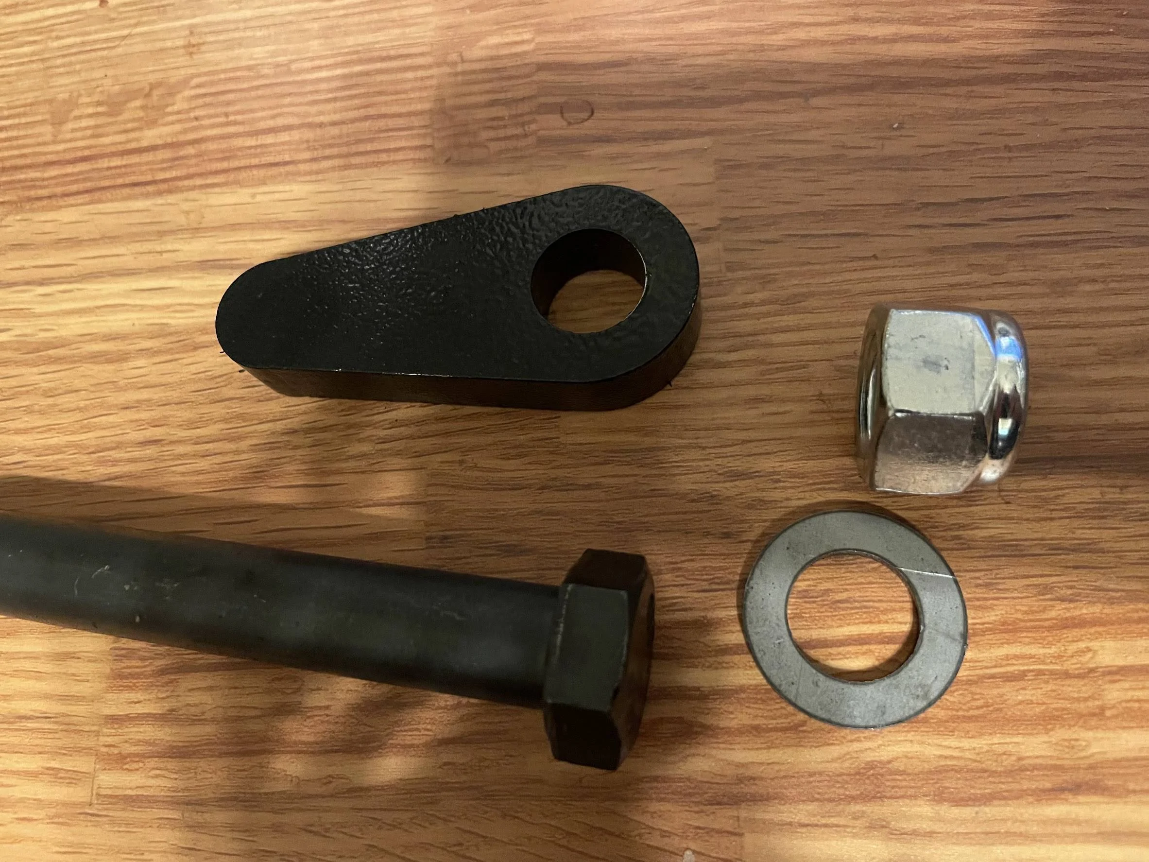

This is a picture of the distinct pieces in my somewhat recent kit for the front:
Jeep Wrangler JL ROCK HARD 4X4 Front Control arm skids. IMG_4683
The bolts are pretty heavy and say JH 10.9. Washers are kinda rough. Nut has what looks like NH 8 on it. Are they the same ones people were having issues with?

Is this the hardware list that was posted above? Worth putting off the install today for a few days to get that hardware? I'd like to do this only once and not run into any issues..
You don’t need to replace them, but I did. That bolt is strong, but it will rust. Those washers will deform under 190 ft/lbs of torque. The nut is fine, but I replaced it with a gold zinc one anyway when I replaced everything else because it’s a nylon lock nut and I felt better using a new one after having been torqued down that hard. It’s class 10. And it matches the other hardware. I reused the original shims, mine weren’t loose and I didn’t need to use extra washers.

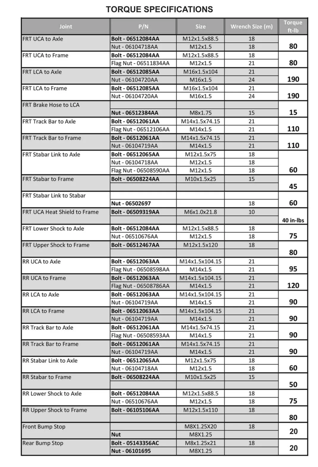

It’s really a result of the opposite thought process happening, bigger/stronger hardware is more expensive, so the engineer (with a factor of safety) will target the smaller hardware that can take the required loads and clamping force. The specified torque varies a little even for the same size/grade bolt, but in general the torque spec will follow the size pretty closely.
In the stock suspension:
M10 is 45 to 50 ft lbs
M12 is 60 to 80. (Front UCAs)
M14 is 90 to 120 (Track Bars, rear CAs)
M16 is 190 (Front LCAs)
