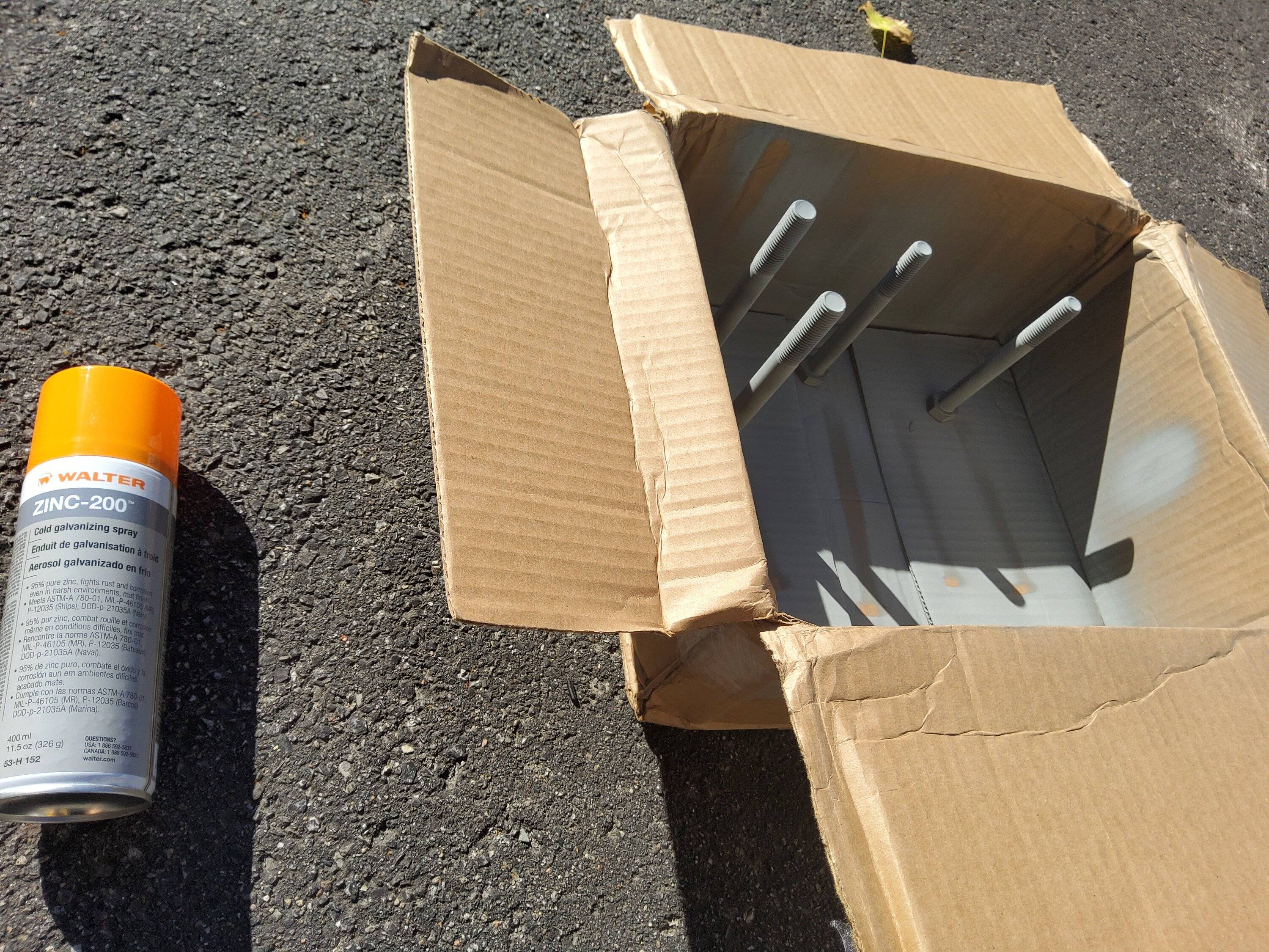

About to install these myself today. Went to fastener place to see if I could get stainless hardware but they couldn't source them (completely different story) so the guy reccomended Cold Galvanizing spray for rust proofing. I hadn't heard of it but gave it a try. Cleaned them up with some thinner and dried them off, 1 coat is all that's needed but I gave an extra, just cause. .
Apparently same shit they use on Navy boats? Anyway, extra bonus is that it is almost Sting Grey so I am totally telling people I colour match all my bolts. ;)
If that doesn’t work out as well as you hope, buy yellow zinc class 10.9 fasteners. I replaced the original hardware with that and it’s been great.
