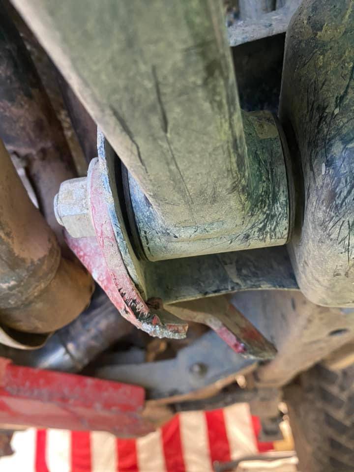

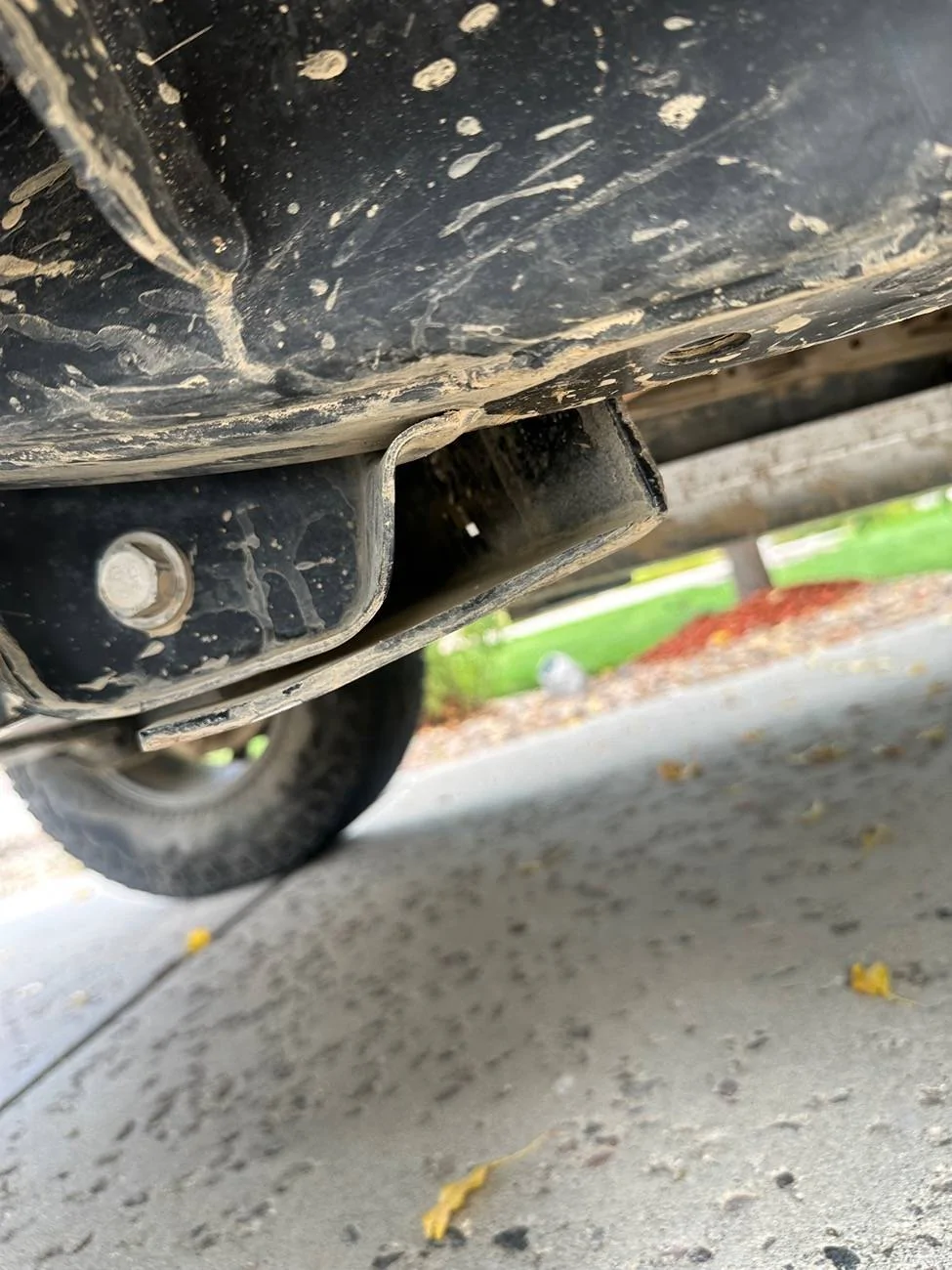

Hello everyone I was wondering if maybe somebody could point me in the right direction, currently I’m running the rock hard 4x4 upper control arm skids but after a few trails they are getting chewed up pretty bad.
They are bent and not protecting the mount anymore (at least on the drivers side)
I’m looking for an alternative to this skids plate that would be more durable as my other skids are holding up just fine, anything from other manufactures I’m open to suggestions.
Jeep Wrangler JL Upper control arm skids? Alternative IMG_2362
Jeep Wrangler JL Upper control arm skids? Alternative IMG_2364
Drivers side bending away from mount⬆

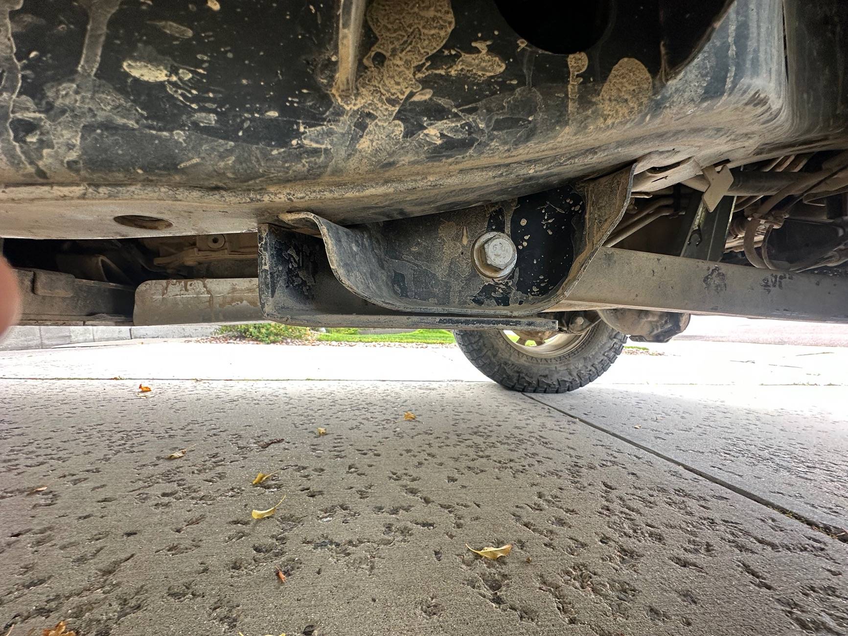

Passenger side for reference still tucked close to the frame but I fear the same thing could happen on that side. I favor putting the hard obstacles under my drivers side that why it’s more chewed up

Most of their stuff is quite good and those are listed at 1/4" thick... You must have been having lots of fun!

I mean most definitely but I’ve only been on like 4 trails with them, they should have designed them to bolt on to the other side as well instead of just one side and maybe curve up better to the control arm

I have several of their skids but skipped these particular ones for just this reason. Acts like a small pry bar to twist the bolt. It'd be nice if they redesigned these, plus the front control arm axle skids where they resist the clamping force required to stop squeaking.

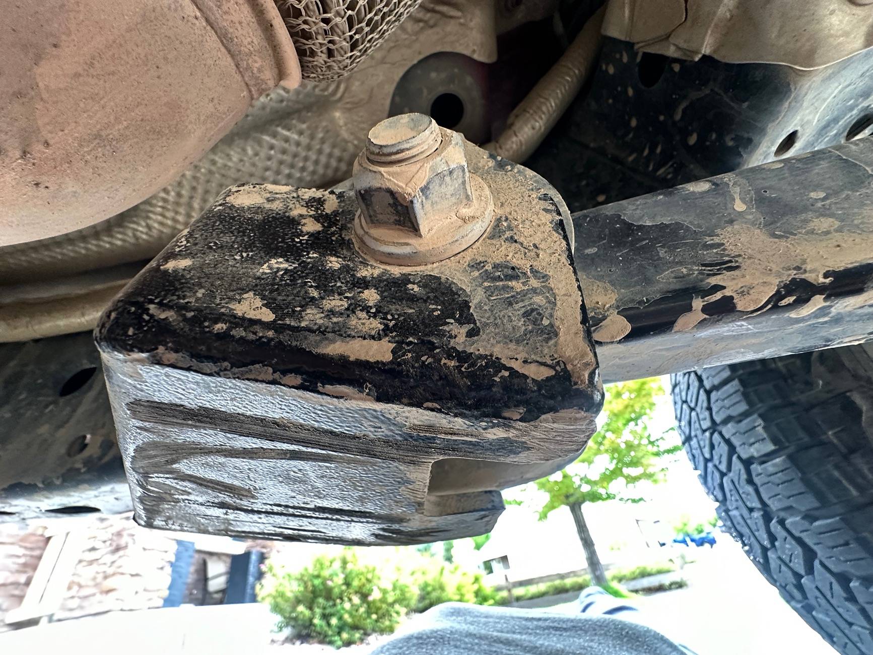

Shredded this one !
