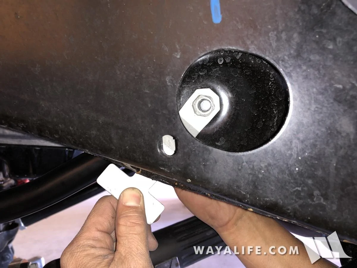

Just brought home our 2019 JLUR today. Looking underneath I saw tabs that appear to connect to upper control arm through the frame on both sides. Any thoughts on what these are?
Those are flange nuts. They put them in tight areas where you can't put a hold back.

Sorry I should have circled it on the pic, I am asking about the T coming out of the frame.
Take a look at the other end of the "T" and see if there isn't a nut attached to it.
That’s the same thing the other guy was referring to. There is a nut on the other end of that tab. When you replace the control arms you hold onto the “T” part and line the nut up with the bolt coming through. Basically exactly the same as was on the JK

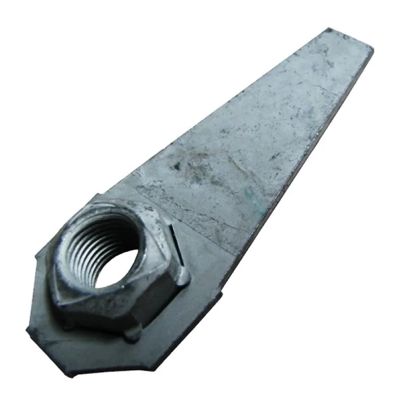

That's what I'm referring to. They look like this:
