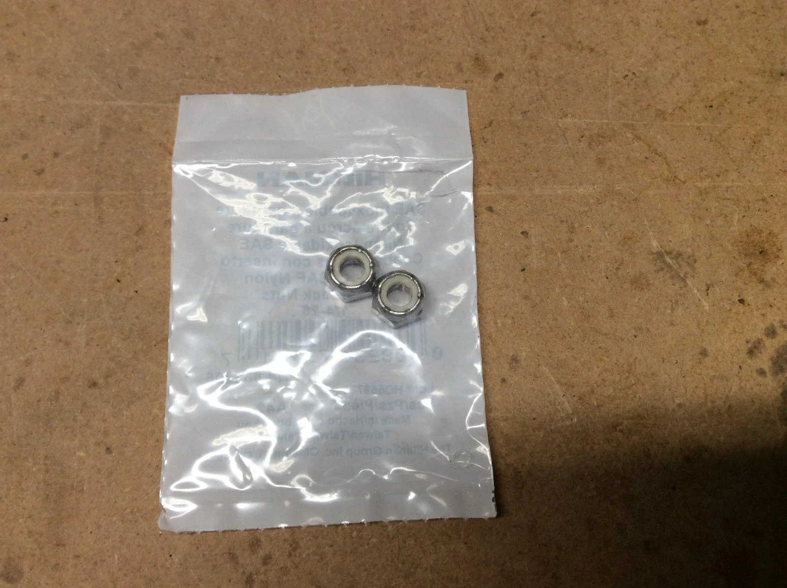

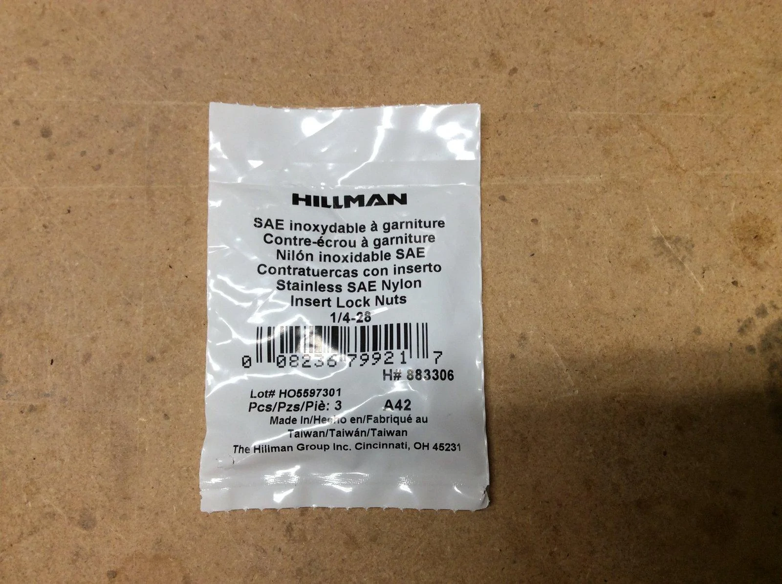

I used the black 10MM nuts that I took off of the Rubi Rail when I removed it first. They fit perfectly.
I tried those and they didn’t work for me for some reason. The threads didn’t match up. I did find that 1/4-28 stainless nylon lock nuts worked though. Grabbed them at Lowe’s.

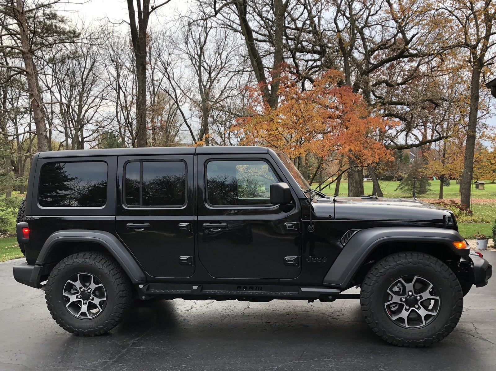

Add me to the club @ROAM club
Forgot to give proper shoutouts to @thundermuffin for the awesome write up that kicked off this thread.

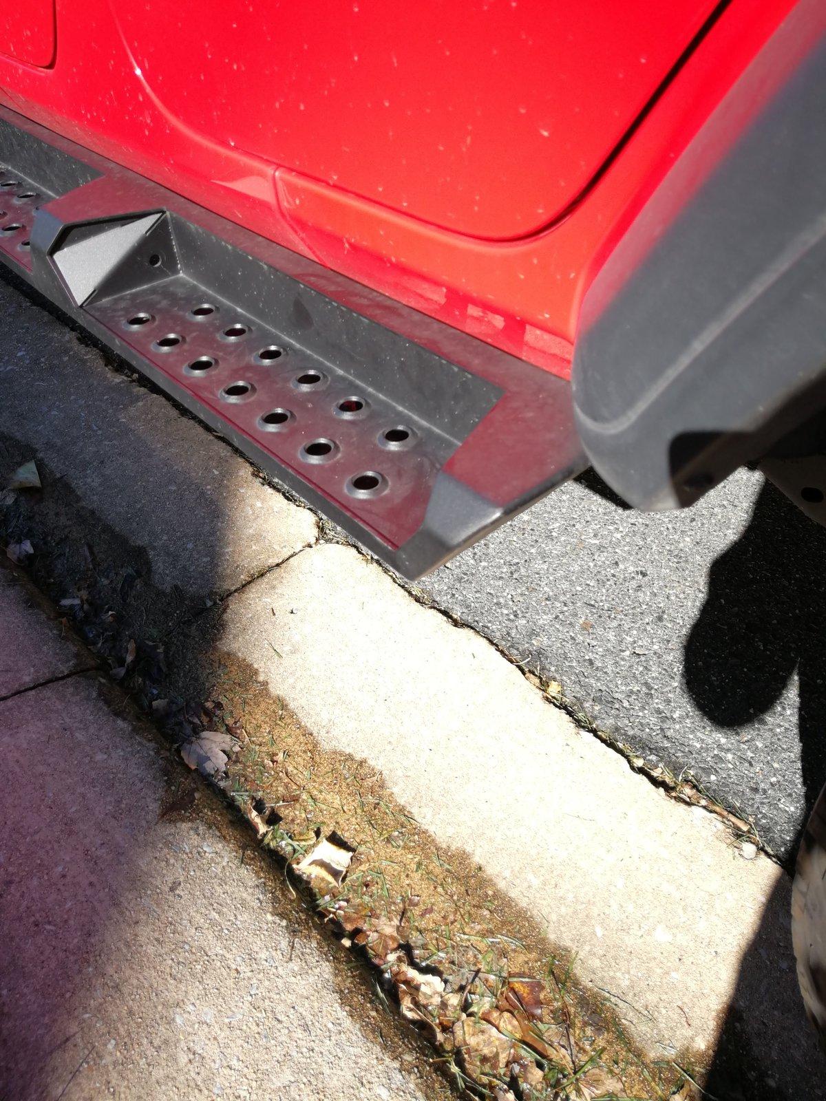

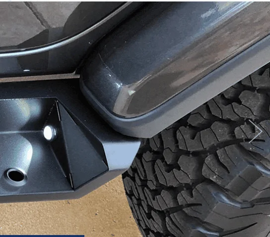

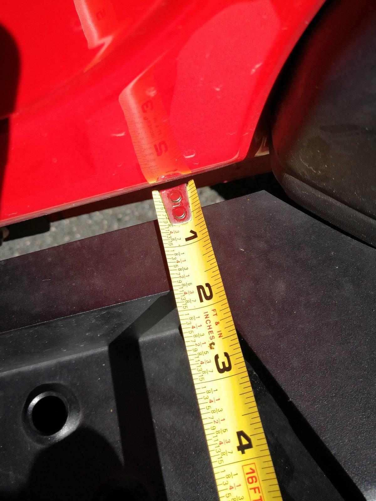

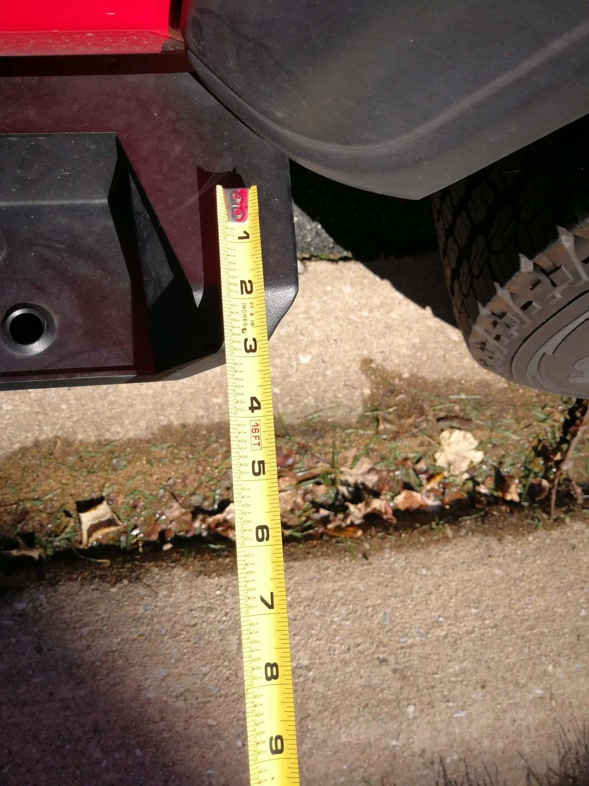

Could someone please help me to understand what I did wrong? :headbang::headbang:
I have a hard time of lining the end of roam rail flush against my rear fender. I really like others with a flush install, but mine stuck almost 2 inches out of fender. I can only move it inward for another half an inch before touching the paint.
Tagging @TTEChris and @thundermuffin for some expertise.
Much appreciated for any tips!
Looks like you have a sport/Sahara? If so the rear fenders aren't the same as the Rubicon fenders so the way they align with the steps will be slightly different.
Thank you so much for this information. Saved me a lot time and frustration:like::like:
Mine is a sport also and Rubi / Sahara definitley looks cleaner.
I don’t have the in/out gap you have to the punch body/pinch seam though. I could get to 1/8” if I want too. Actually, I could get it up against the body if I wanted to. I definitely have the same gap as you on rear fender.

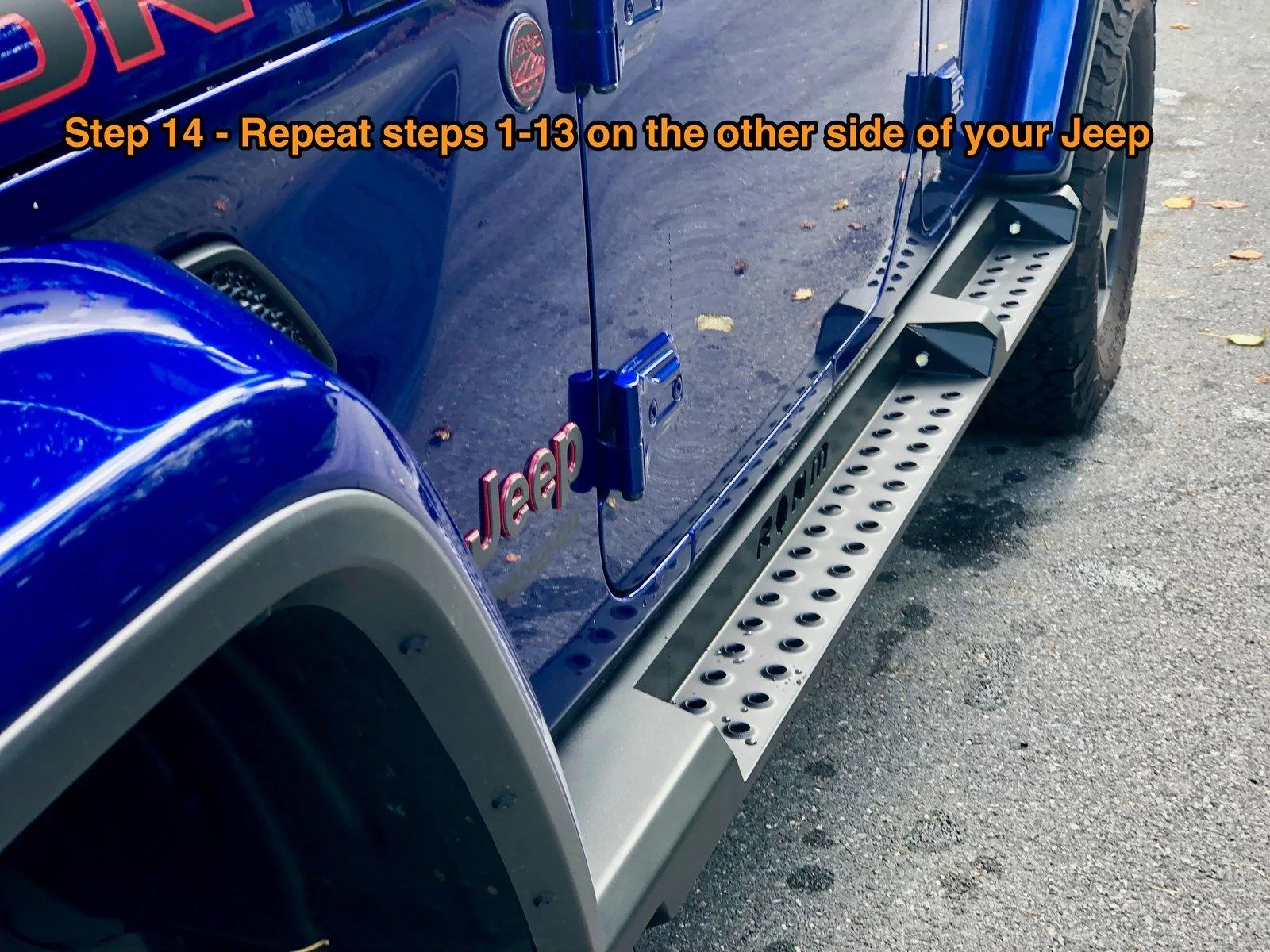

Just put my Roam Steps on today. With the help of this thread. I painted the plates red.
