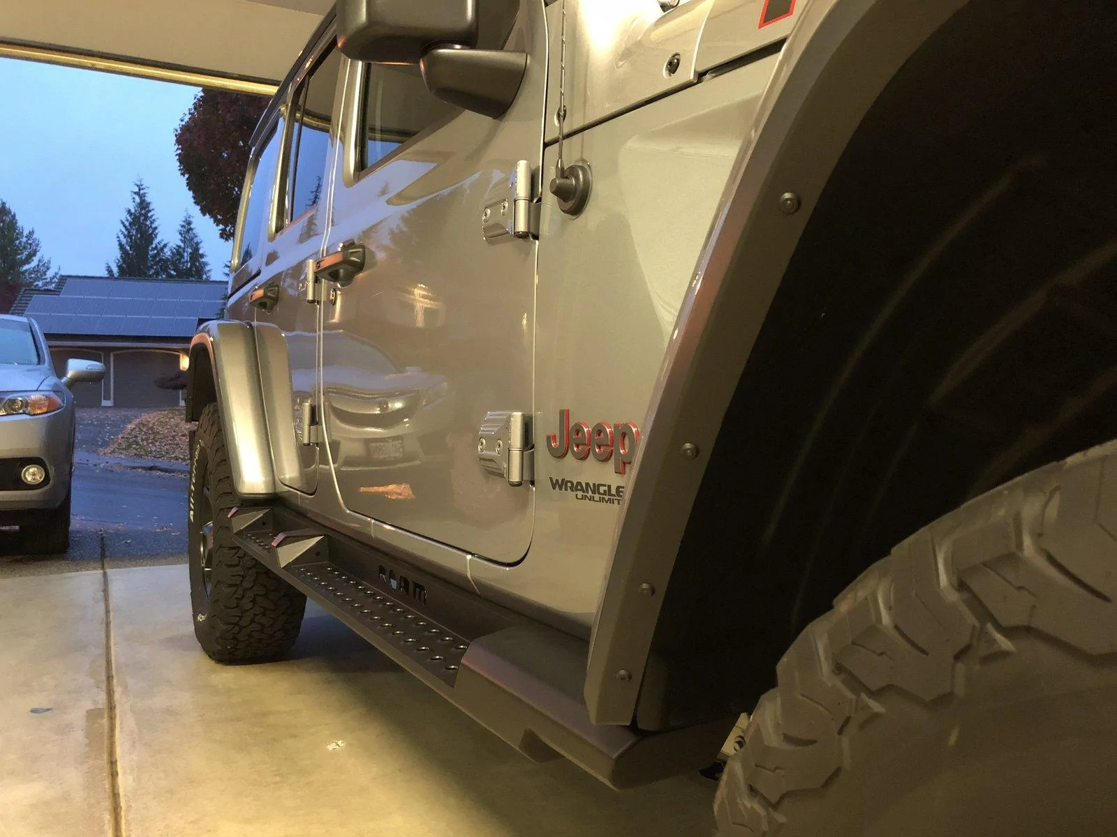

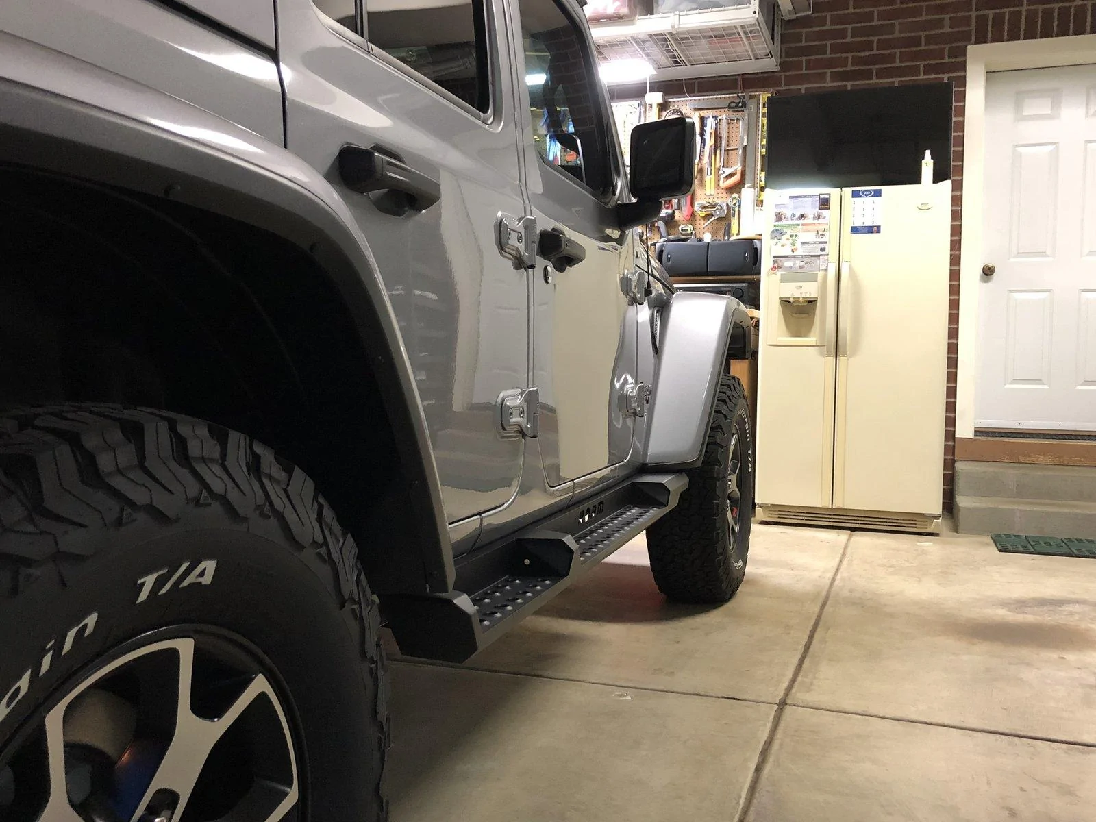

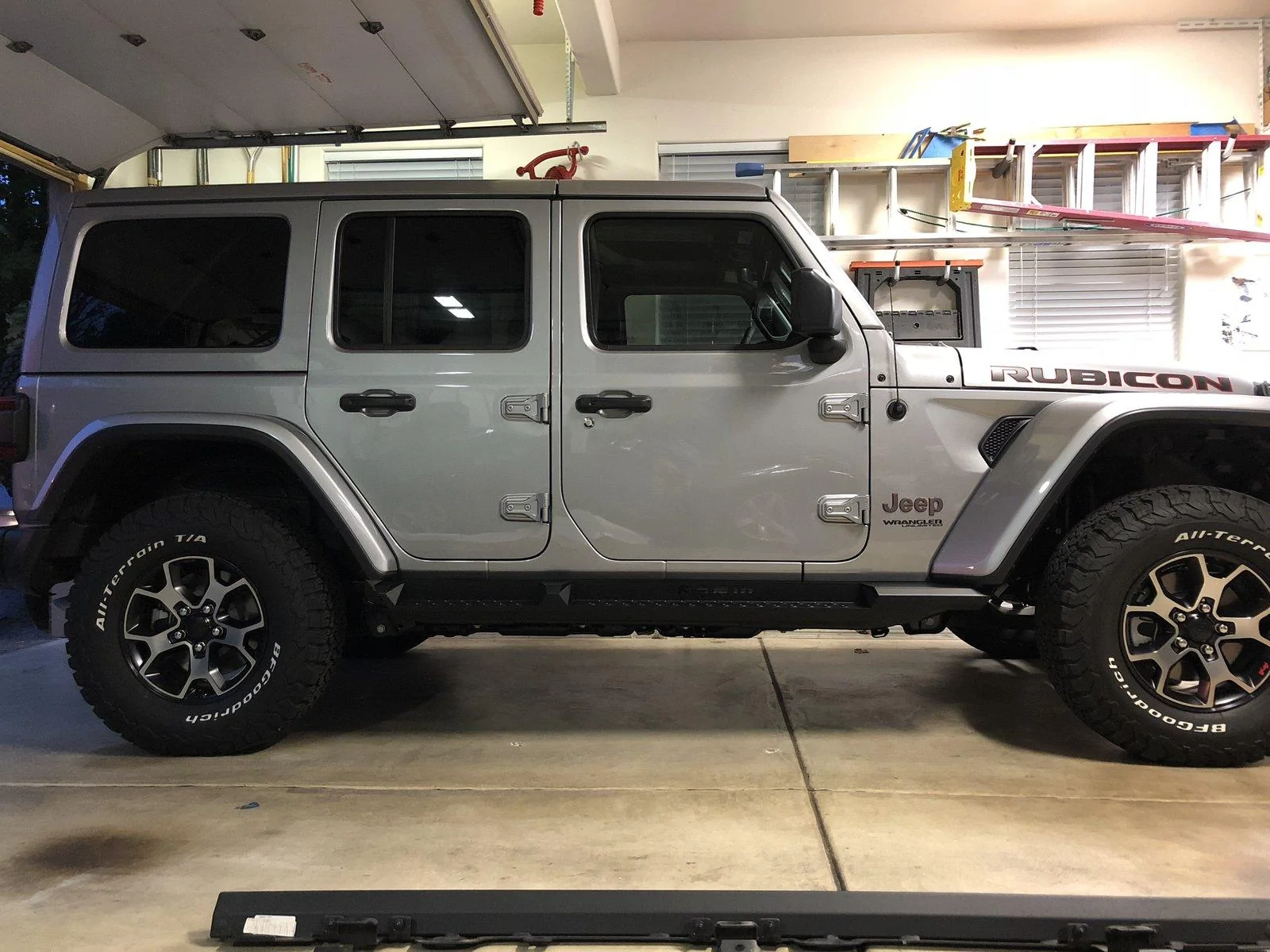

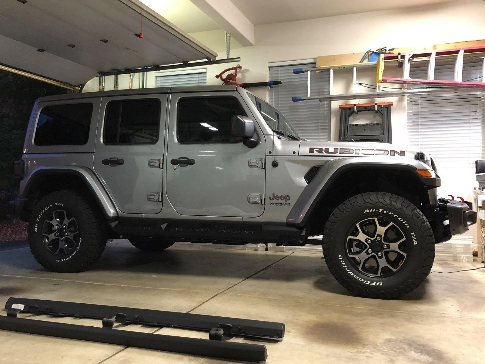

Received mine today and mounted them up (sans lights for now - will tackle that project on a weekend; I predict lots of cursing, even though @TTEChris ā€˜s tutorial will be super helpful). Box arrived in really good shape and all parts were well packaged. There were a couple spots on the steps requiring touch up, but I think that had to come from pre-shipping handling, as the packaging really couldn’t have been done any better. No instructions like everyone else. Thank goodness for this thread, and also for @BWWJL ā€˜s handwritten bolt ā€œkey.ā€ They look great and are really solid.
Like others though, mine didn’t come with nuts to attach the black plates behind the ROAM logo. Anyone know what size bolts/nuts those are? I couldn’t find a match in my bins of various random nuts.

I used the black 10MM nuts that I took off of the Rubi Rail when I removed it first. They fit perfectly.
