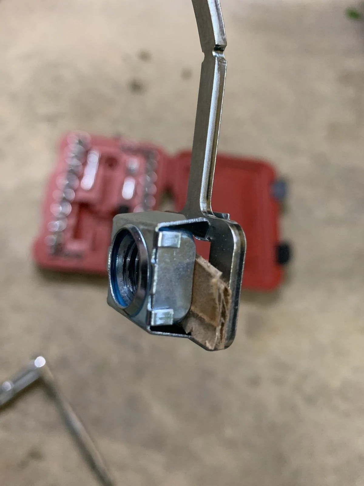

This is a good write-up, but I’d like to contribute to it just a bit. Probably nothing you couldn’t find out on your own, but here-goes.
Jeep Wrangler JL ROAM Front Bumper Install B85793D3-7E5B-42E9-AE33-82F5F61BE0CB
The handle-nuts look like this after you assemble them. Stuffing a small piece of cardboard between the nut and the handle made lining up the shorter bolts a little easier. These bolts are a little bit on the shorter side of convenient, but they work. I did have to massage the bumper back and forth on the frame rails (with everything loose) to get them to catch.

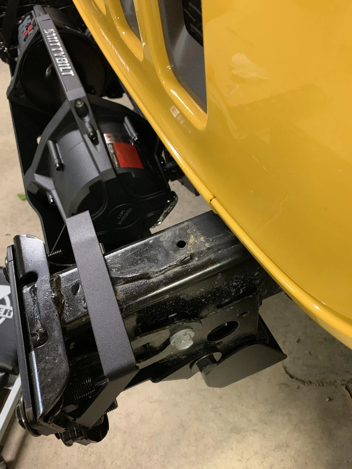

Small update. I went and bought a winch yesterday. Same Smitty X20 10k that other proprietors of this bumper have turned to - and I have encountered a couple issues.
The first thing I noticed was the clutch lever interfering with the small line as indicated in post #12 in this thread. I got around this by “clocking” the gear-end of the winch 90* clockwise, which places the lever directly behind the winch - and easily accessible from the drivers side wheel well with everything assembled. The idea of letting it fight for position with that line over time made me a little nervous.
Jeep Wrangler JL ROAM Front Bumper Install 95A22322-21D9-45A9-A6AA-083BA5158481

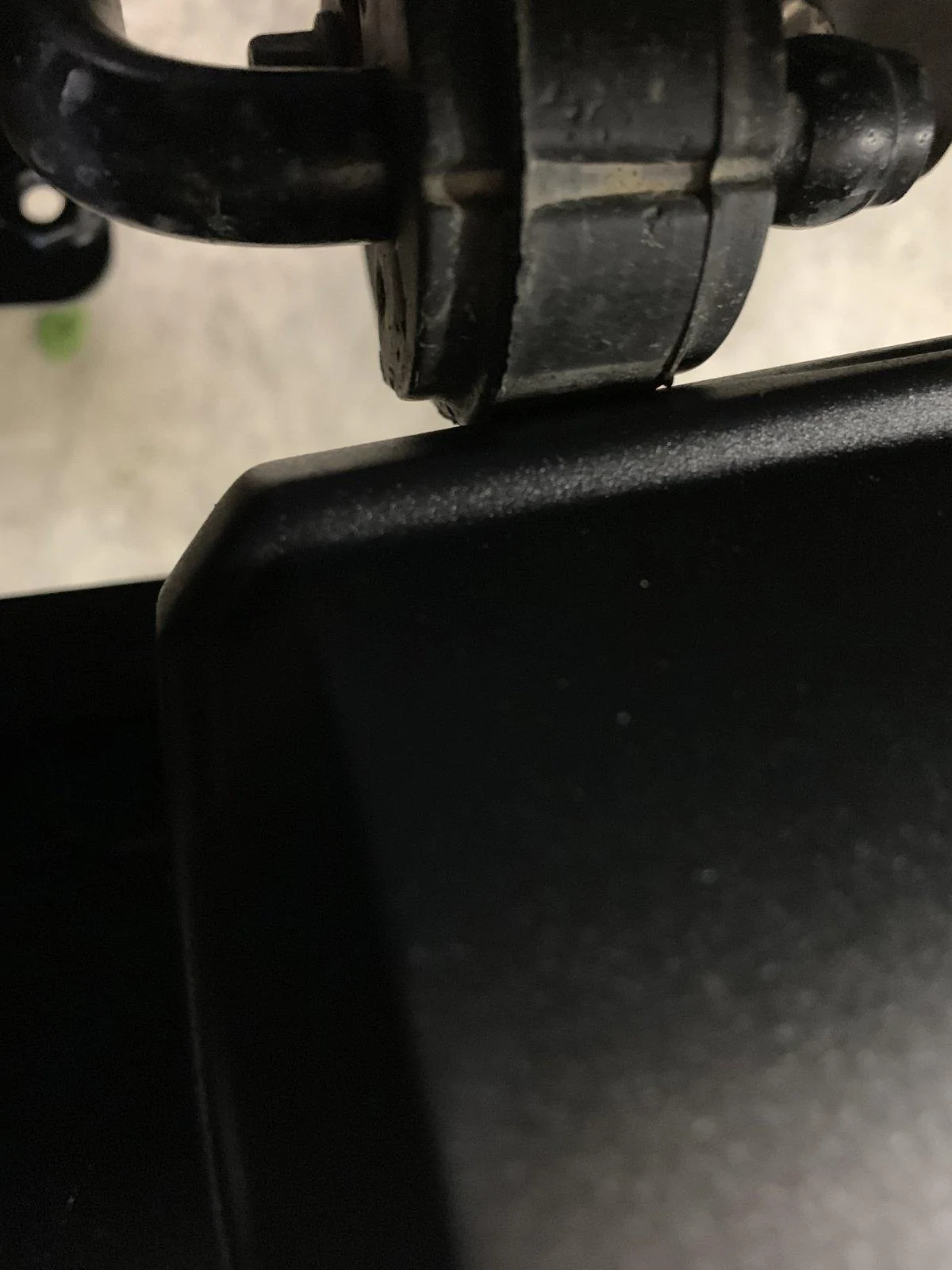

I had two other clearance issues with this winch. The motor-end is touching the isolator for the sway-bar motor (which probably won’t cause any issues, but I trimmed it down just a little bit with a razor blade anyway.
Jeep Wrangler JL ROAM Front Bumper Install A5844067-D78F-4278-87F4-BEDC5B5CD64D
My third clearance issue is with the holes drilled for mounting the winch to the plate - they are about 2mm too far apart from each other. I wasn’t sure about this one. I decided to “oblong” the hole on one side, because I could get in a bolt on the right side *or* the left, but not both. This could be a Smittybilt QC issue, by the way.
Upon final fitting of the bumper, I realized why the instructions say to only install the bottom two bolts to mount the winch...

Just completed this install myself with the Smittybuilt X2O 10k. I also had to turn the clutch lever assembly 90 degrees in order to get it to fit. It was all over the AC lines when engaged, and I even tried moving the brackets the lines were on to give it the clearance. I didn't feel comfortable putting the stress on them that that would have taken though.
It would be really awesome if the clutch lever could be turned around. When I pulled it, the design doesn't allow for that, though. I might play with that later on.
The only other issue I had was some sloppy slag on top of my frame rails that needed to be removed in order to get the nut plate into position, but the bumper fitment was very nice.

I did bend that line slightly(by hand) to keep the clutch lever in the normal position.
Thanks for adding the extra tips @Shepherd12 . I forgot that I also trimmed the rubber hanger with a razor blade slightly.
I didn't have issues with the bolts not lining up for the winch though... if I did, I would have just drilled the mounting holes slightly larger.
