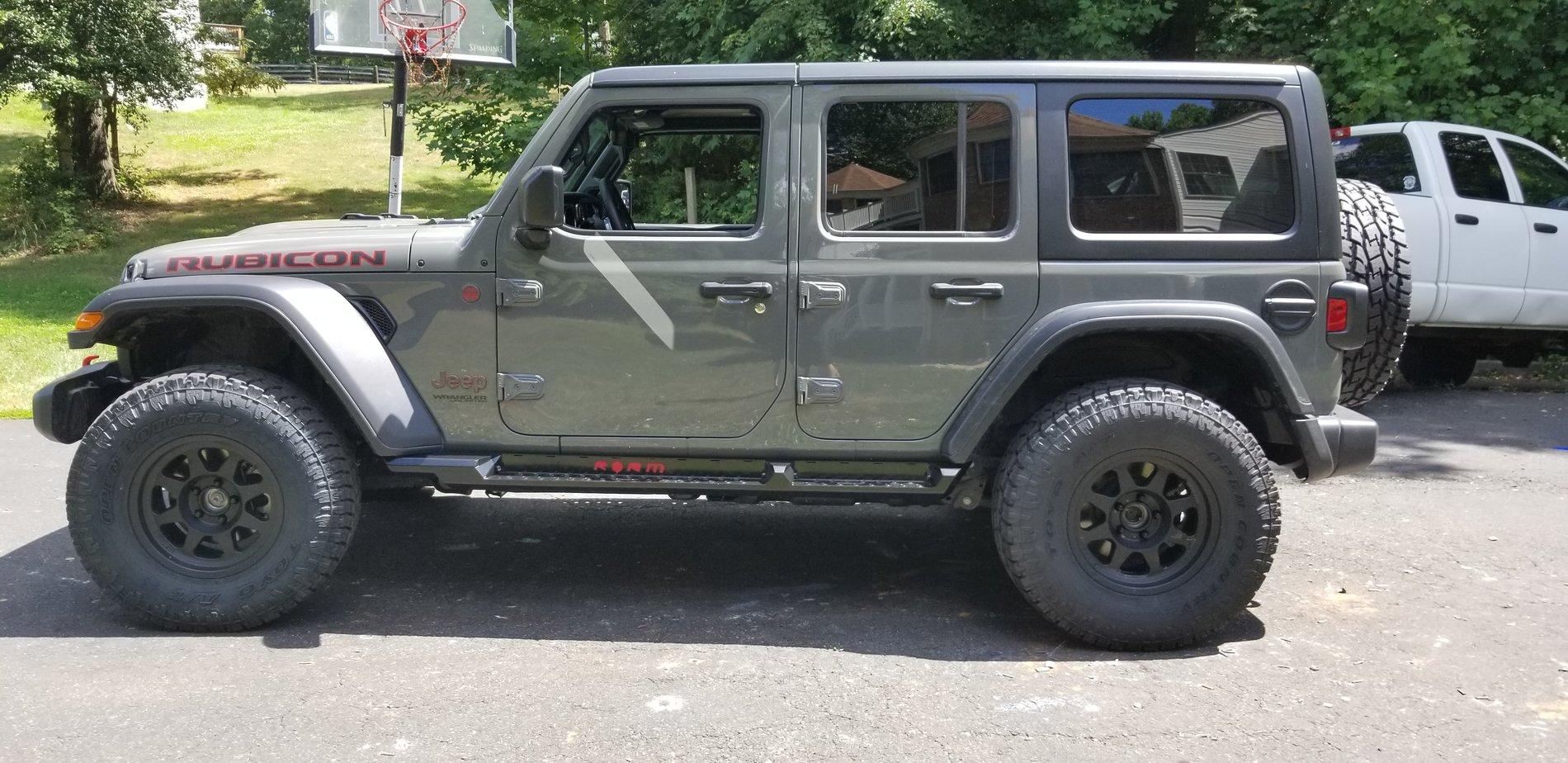

Put mine on a couple of weeks ago now. Install was straightforward. These things are pretty heavy!

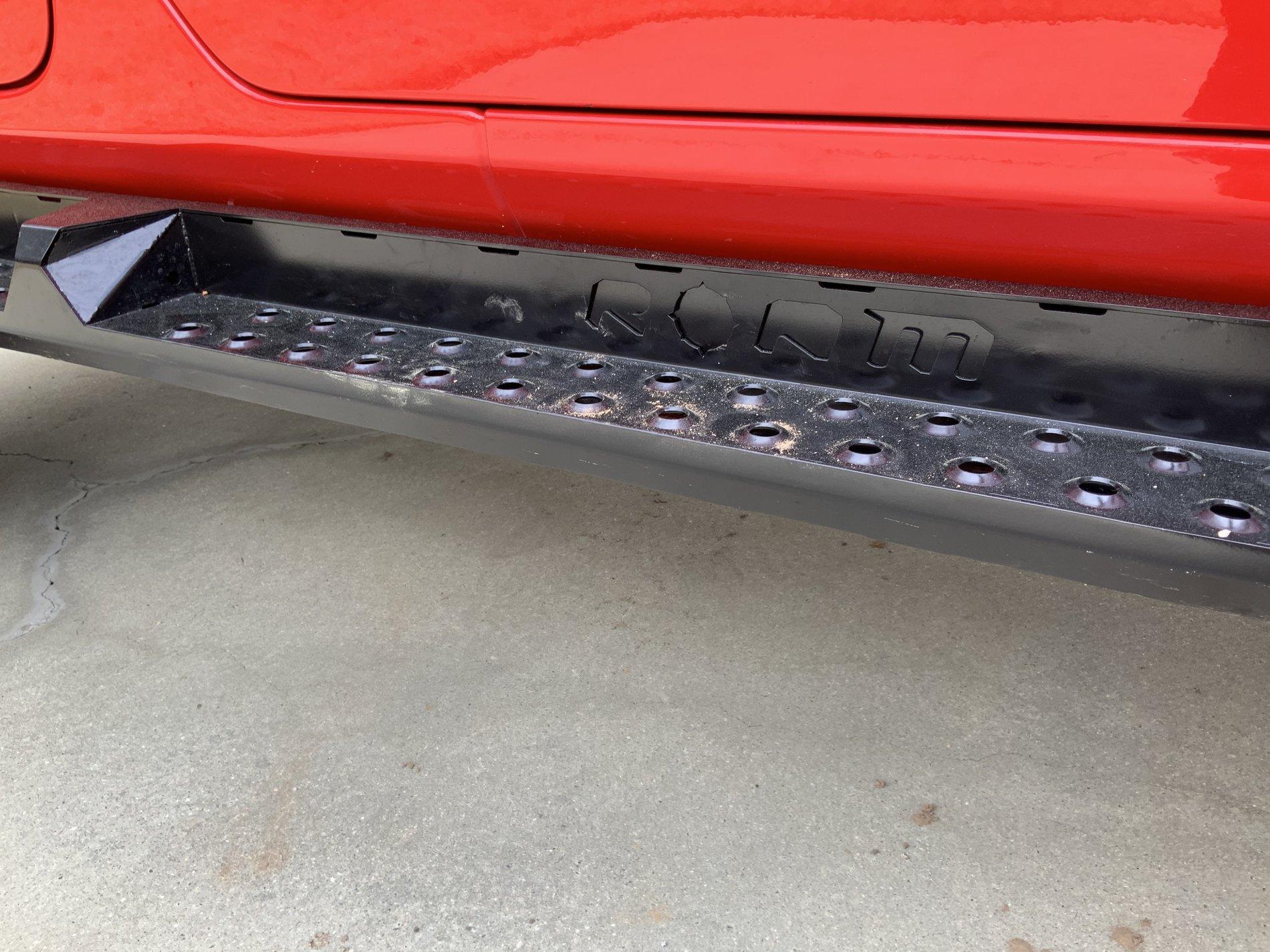

That looks good. What did you do to the Roam cutout? I can't see it. I just ordered my rails and was trying to find a solution for the cutout. They look to be well made, look good and function well, but I am not a fan of logos or badges, my only hesitation was the logo cutouts.
I did make any changes to it, See attached:

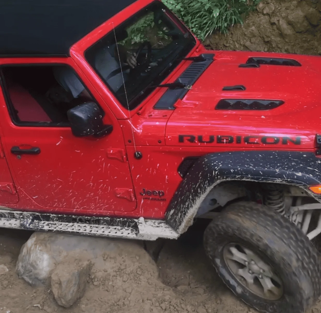

Anybody do any serious off-road activity with these? How are they holding up?
Token
Dave
Apr 11, 2019
289
473
Toronto
2019 JLUR
Yup. I’ve taken a good portion of the powder coating off of mine. They are about 50% Tremclad semi-gloss black now. LOL. So far they have held up great being banged around and dragged off stumps and rocks. Structurally still 100% sound. They have lived through a Caniadian winter, and still look great. I have no rusting issues, and even the included lights still work after being submerged plenty of times.. I honestly only have good things to say about the frame mounted steps.

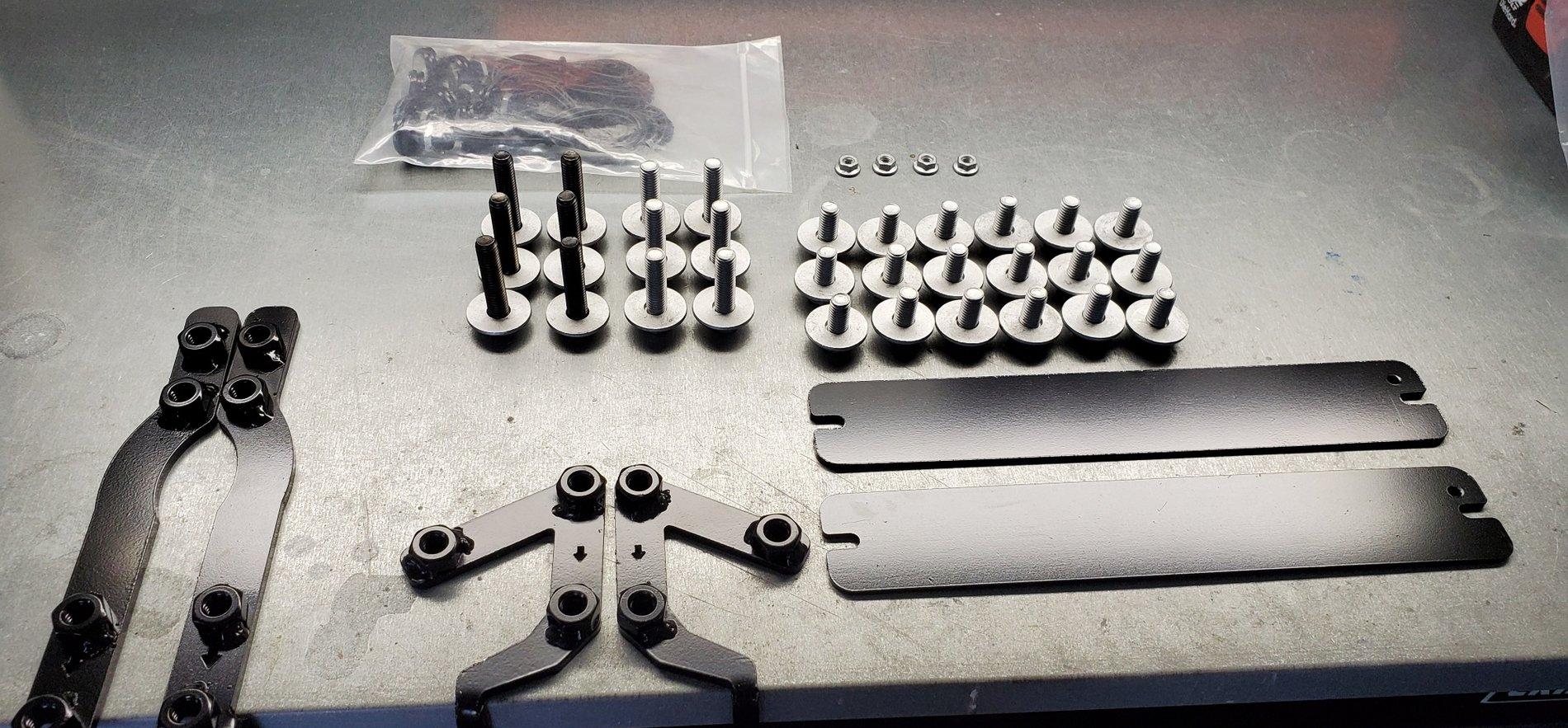

As I received:
  • 6 black long bolts for bracket #1 (a little longer than the 6 silver used for bracket 3).
  • 6 silver long bolts for bracket #3
  • 18 bolts to attach rails to the brackets (although it only called for 16).
  • Also not sure the torque required for brackets #2 & #4 using the factory body mount nuts.
Hardware provided:
Jeep Wrangler JL ROAM MK3 Rock Rail Installation ROAM Hardware
Thanks.
FlashGordon
Jan 22, 2020
49
94
North Dakota
2020 JLUR - Billet Silver, 2017 Grand Cherokee Altitude
Anthony confirmed today all the bolts are M10. M10 -> 44 Nm / 32 ft-lbs.
