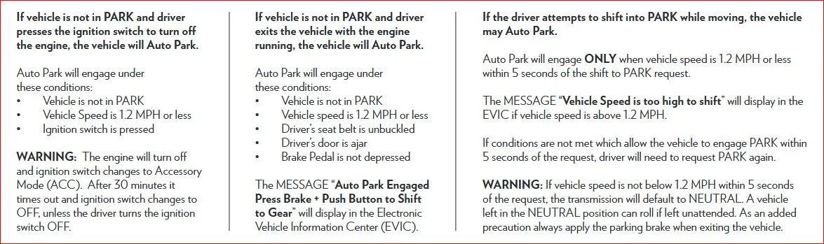

I’m sure @Rhinebeck01 will disagree. ?
From the Owner Manual:
WARNING!
If vehicle speed is above 1.2 mph (1.9 km/h), the transmission will default to NEUTRAL until the vehicle speed drops below 1.2 mph (1.9 km/h). A vehicle left in the NEUTRAL position can roll. As an added precaution, always apply the parking brake when exiting the vehicle.

The purpose of my post was only friendly teasing of @Rhinebeck01; I’m NOT disagreeing with anyone here. In fact, I appreciate learning the info presented.
