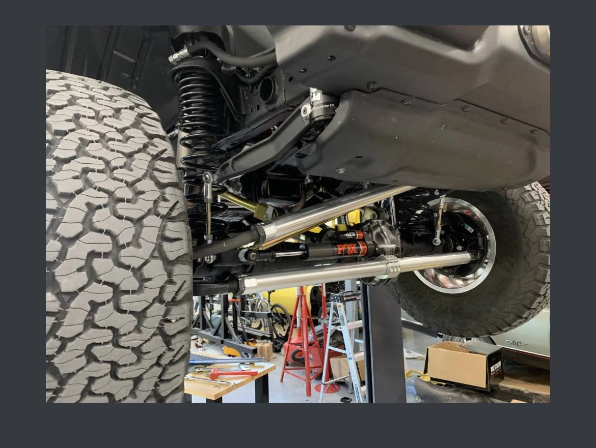

Happy with Metalcloak and glad I used their offering since a tierod that's any bigger would not have fit with my Dana diff cover.
Really? I have Dana covers too and was thinking about going with RPM or Apex.
This guy has the RPM with Dana cover, seems to fit okay.

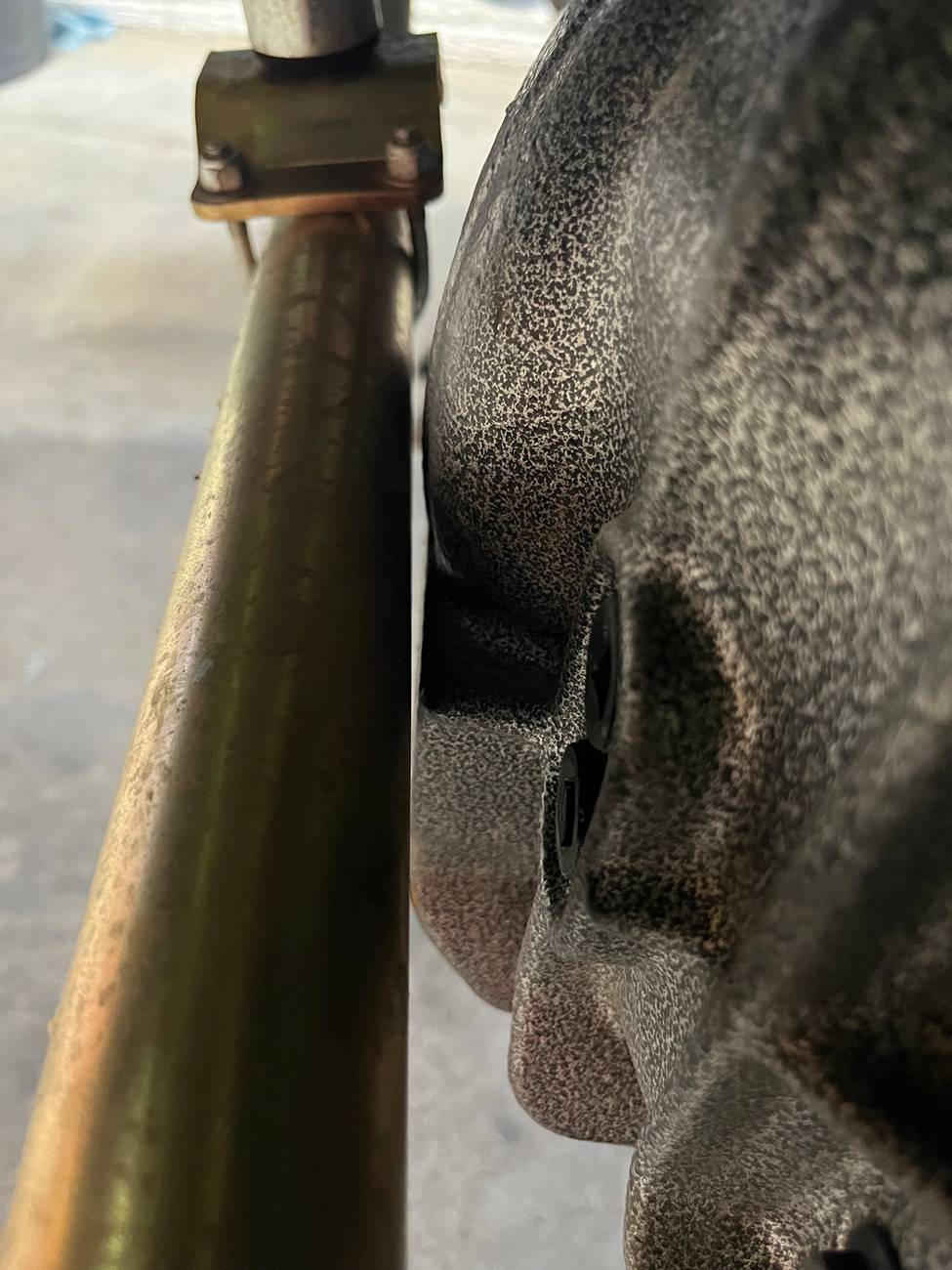

This is how much room I have at a full left turn. The photo makes the clearance look worse than reality, but its' still only about 3/16" at best.
