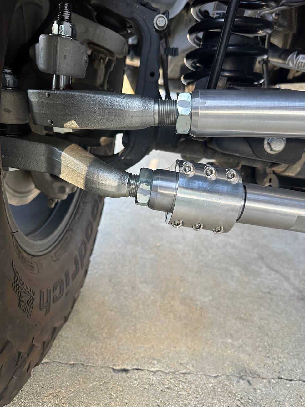

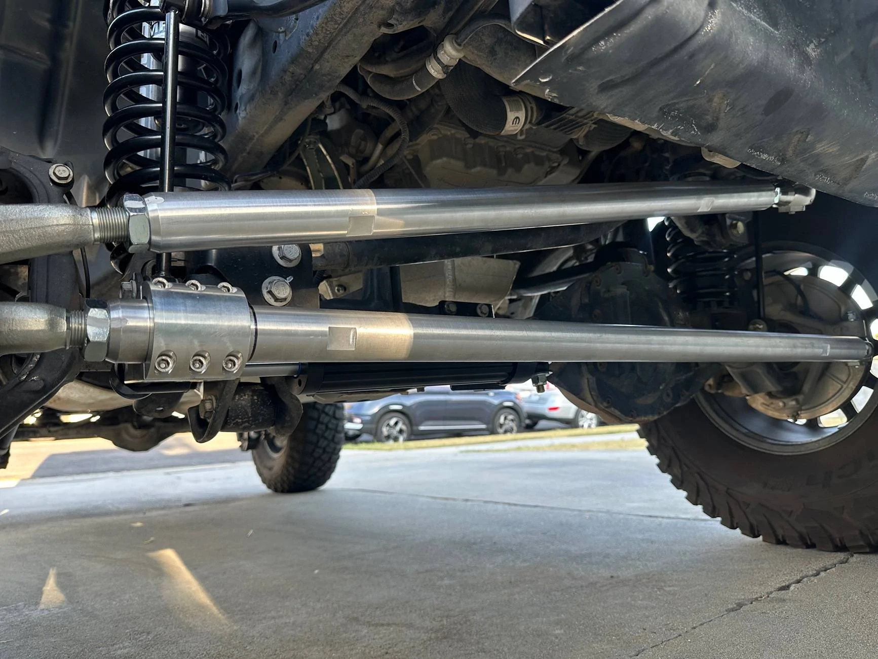

I just got the Rock Krawler one instead on my Jeep two weeks ago and so far I’m very impressed
. ran Gold Mountain & John Bull On Saturday and it handled great.
Did you have to use their steering stabilizer?
