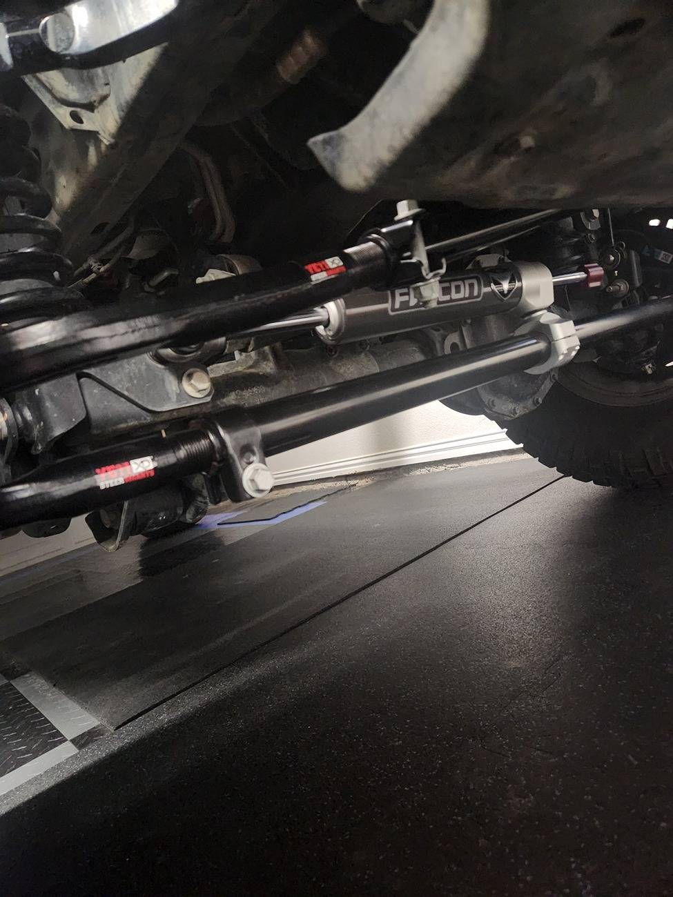

I did the whole Steer Smarts setup and it's great. Also did Dynatrac ball joints.
