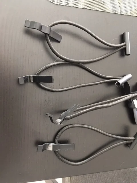

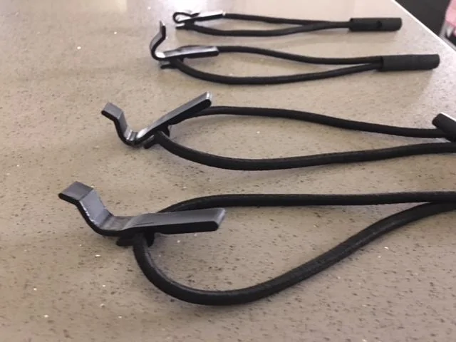

just had the new set go bad on me as well...
Wonder if two clips per bungie (side by side) would work as a temporary fix until they get their quality control issues squared away. Mine have stretched but not to this degree. My problem was the front bungies stretching to the point where the shade was resting on the sound bar. I know of at least one other member on here who has also experienced this.

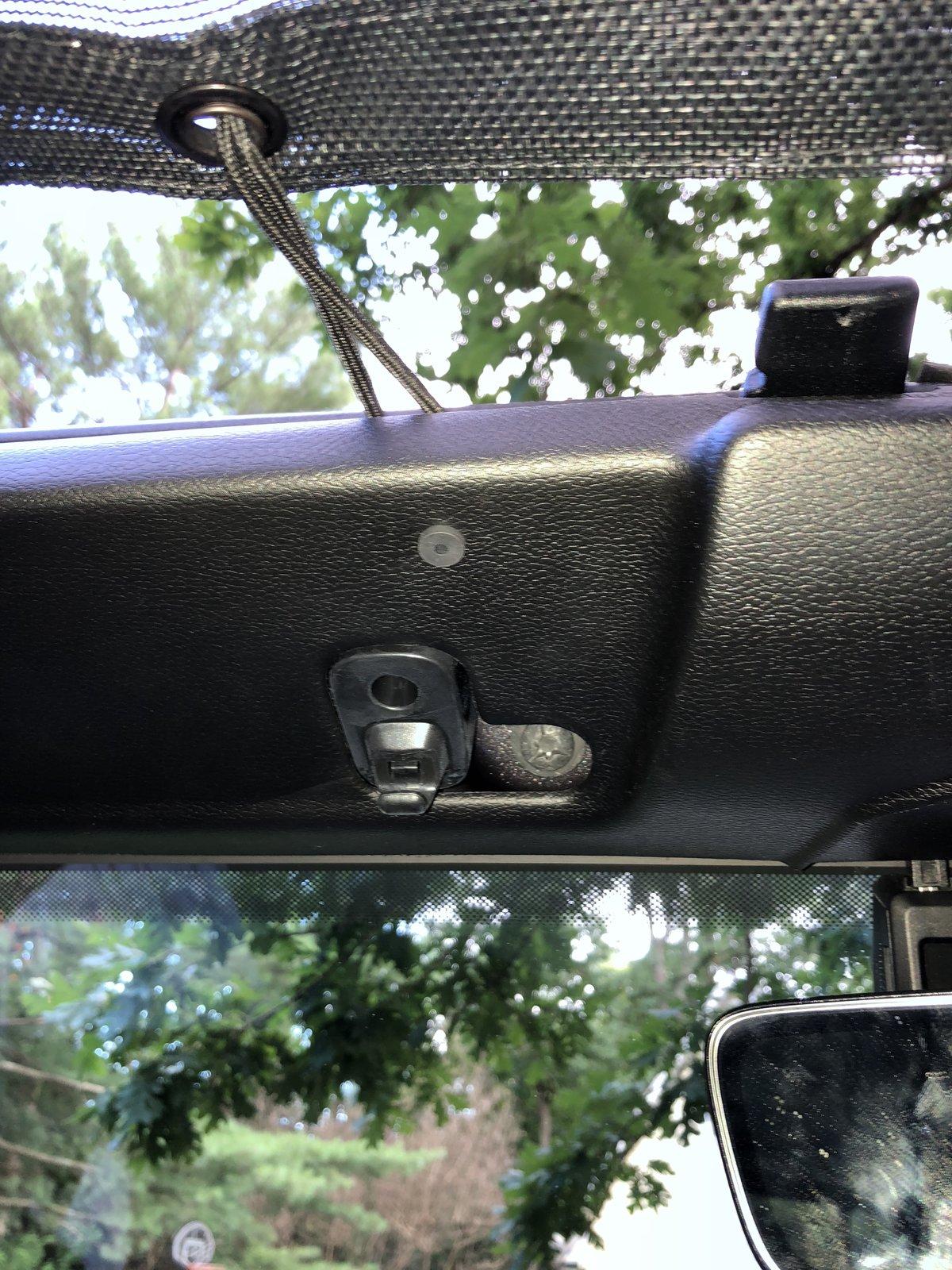

I think I'm done with Alien - this is the second set of replacement clips, so my third set in total, that have warped away and would no longer hold the shade in place along the front. Unfortunately whatever plastic they are using is not up for the task of holding the straps in place. Any other shades that are looking good and will hold in place more than a month?

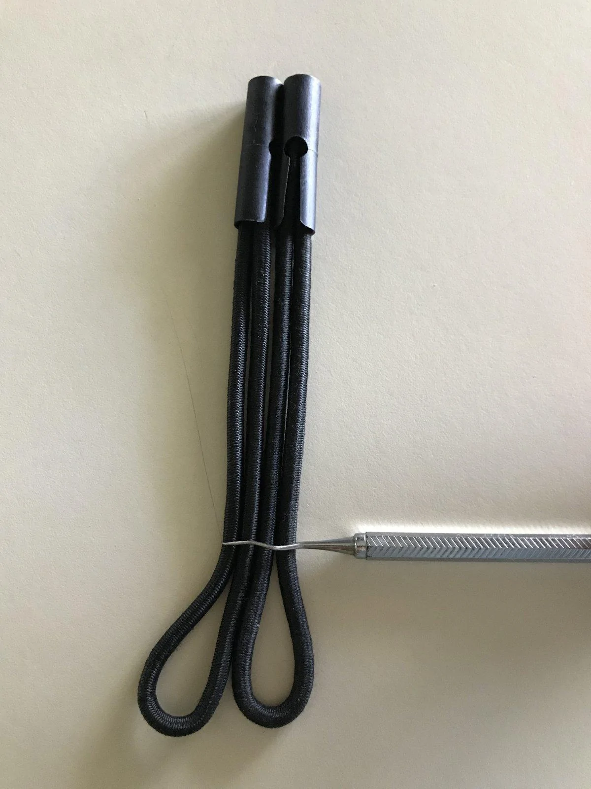

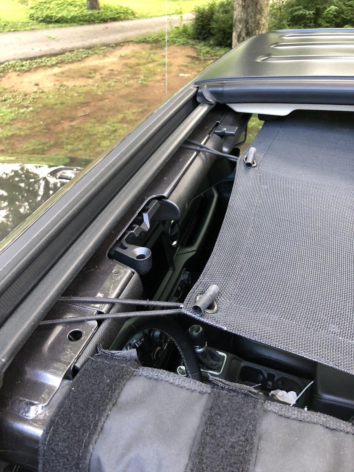

Im having the same issues and the replace also got deformed, can you advise how did you hook the bungees on the windshield bolt?
It's super easy.
1) Remove your freedom panels.
2) Remove windshield screws using your Jeep's toolkit.
3) Tilt windshield forward just enough to see the screw holes (about 2-3 inches).
4) With the shade detached, lay a bungee loop over each of the four windshield holes.
5) Return windshield to normal position.
6) Return windshield screws.
7) Attach shade to bungee loops. Done!
They know about the weak clips. Not sure why they're still shipping the defective ones and, worse, sending out defective replacements.
