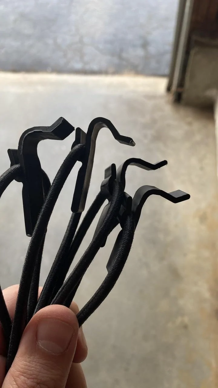

The clips in mine all bent after about a month too. The 2 on the edges popped right out when I was unlatching the freedom panels. Going to try looping around the bolt. The bungee balls all seem to be holding up fine.
