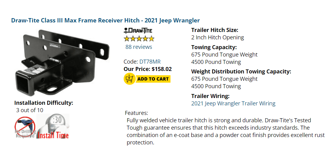

Every hitch I've seen has the same 3,500 pound rating, except the Max Frame from Draw-Tite:

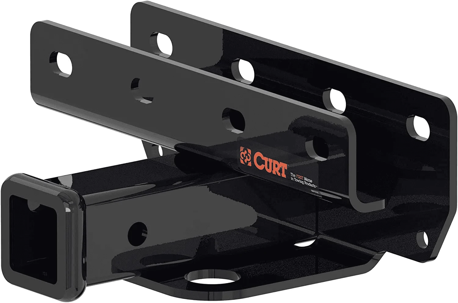

I installed and recommend the Curt 13392.
To accommodate fitment of two of the provided receiver hitch bolts, I did have to use a rotary tool with a coarse sanding drum to enlarge two of the corresponding frame crossmember holes. It required maybe five minutes to get both of them squared away.
The installation instructions did also suggest lowering the muffler to create necessary working space. With a bit of precision wiggling, though, the Curt hitch was positioned and secured in place without having to touch the muffler.
Note that you'll not want to exceed the vehicle's rated tongue weight and towing ability (as stated in the Owner's Manual), no matter if a particular hitch advertises a higher figure for either metric.
I installed this exact one on my 2021 Sahara I didn’t have to lower muffler, remove bumper or anything. No die grinding either. Did use a jack to lift it in place as it’s a tight fit on the existing frame. It’s a little longer receiver part than the model for the JK bumper which makes it fit perfect. Nice finish and quality. Got mine “used like new” on Amazon for like $60 bucks.
