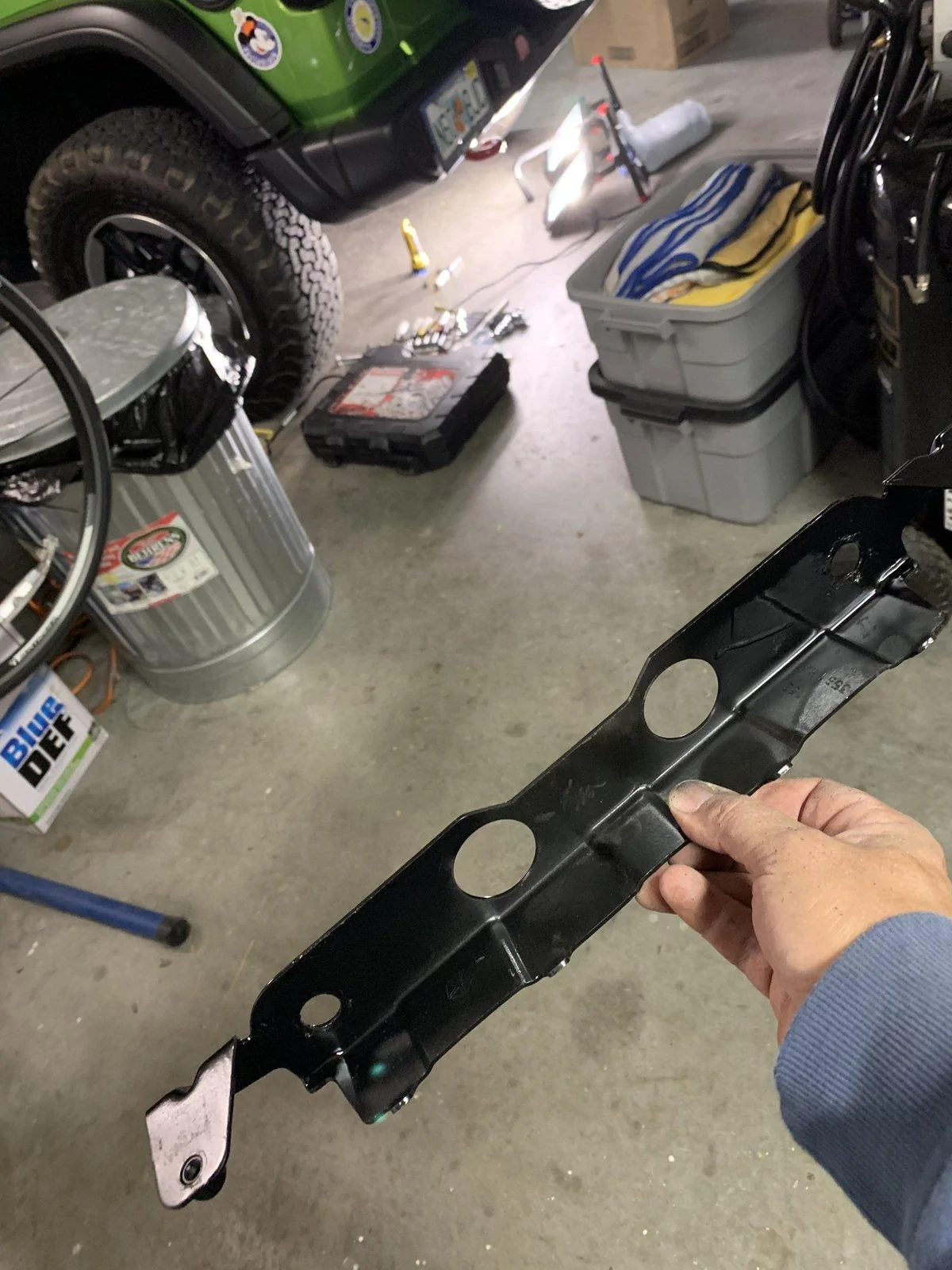

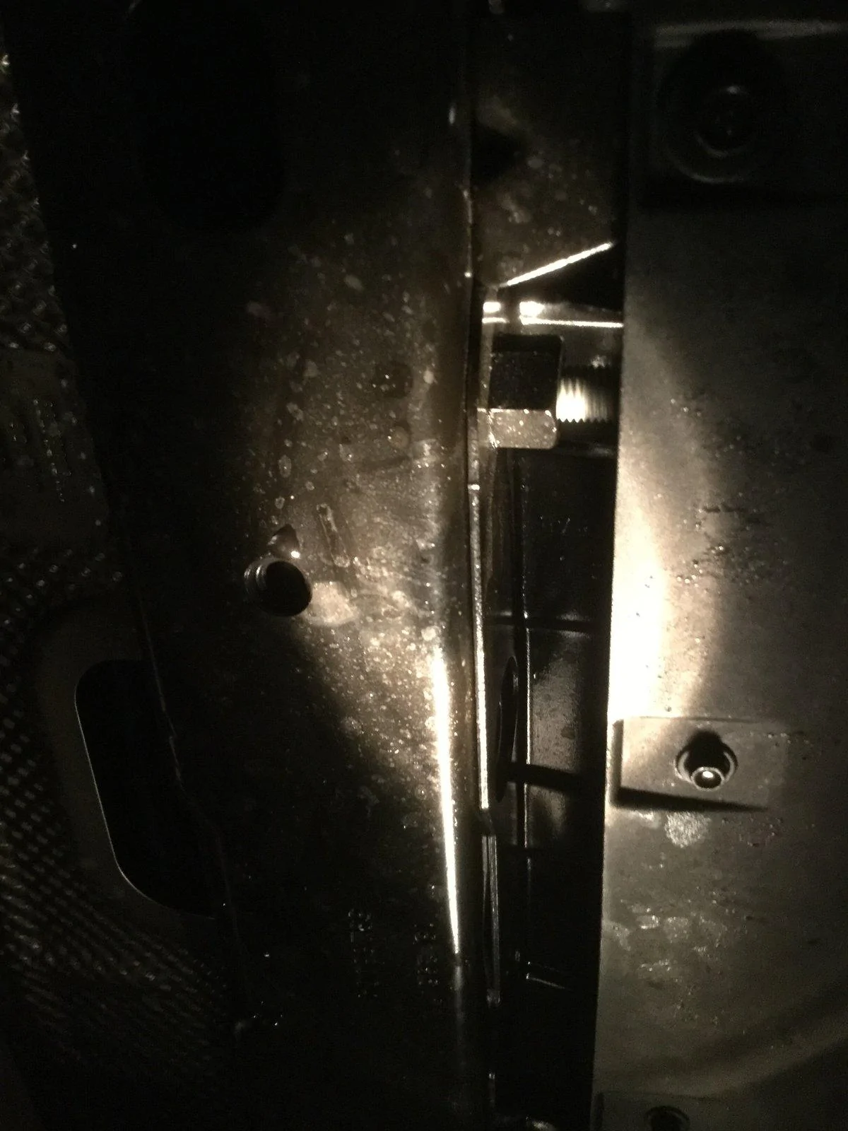

Question - So you left the bumper bracket in?... Meaning you used the 2 bolts that originally attached the bumper bracket along with 2 more for the Curt receiver? If so, did you torque all 4 bolts to the 110ft-lb recommendation?
I'm in a similar situation and found that it was easier to leave the bracket in than remove it but wasn't sure of the bumper bracket bolt were any less capable than the ones that came with the Curt receiver.

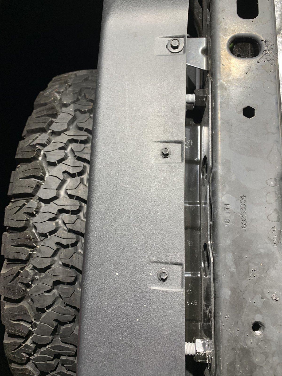

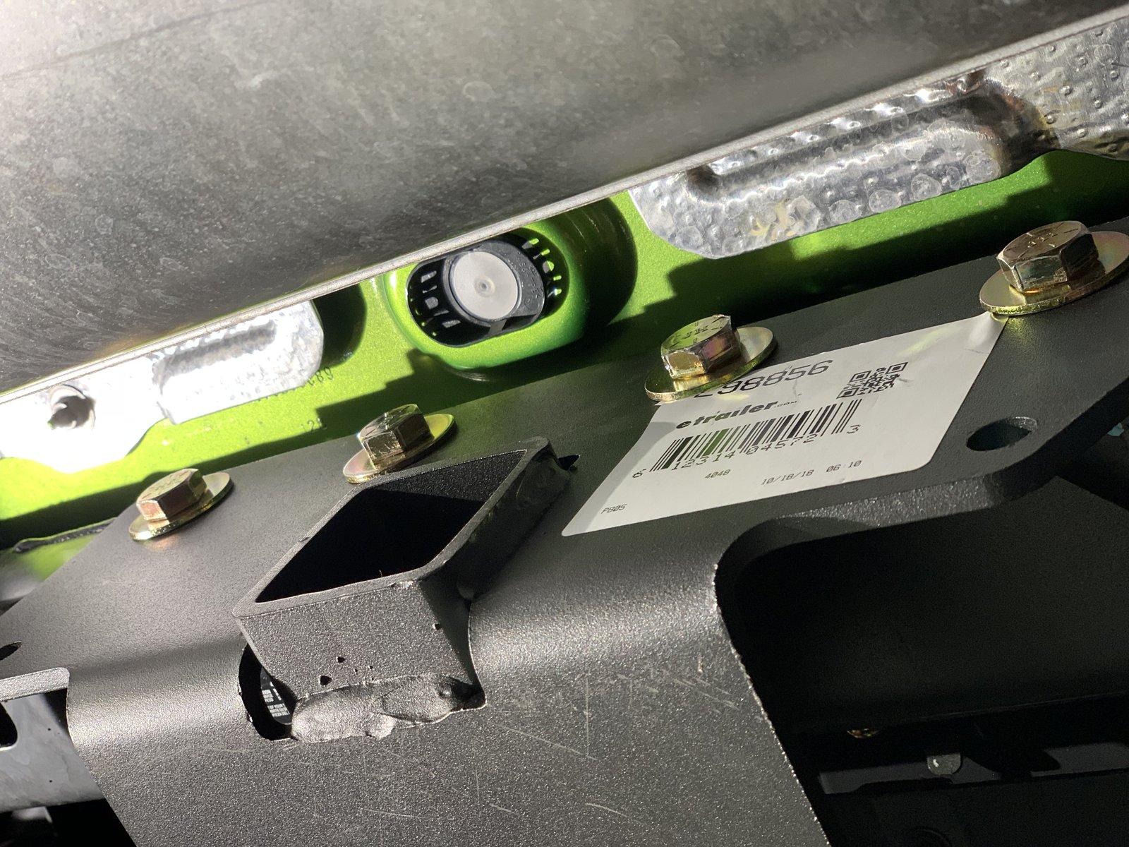

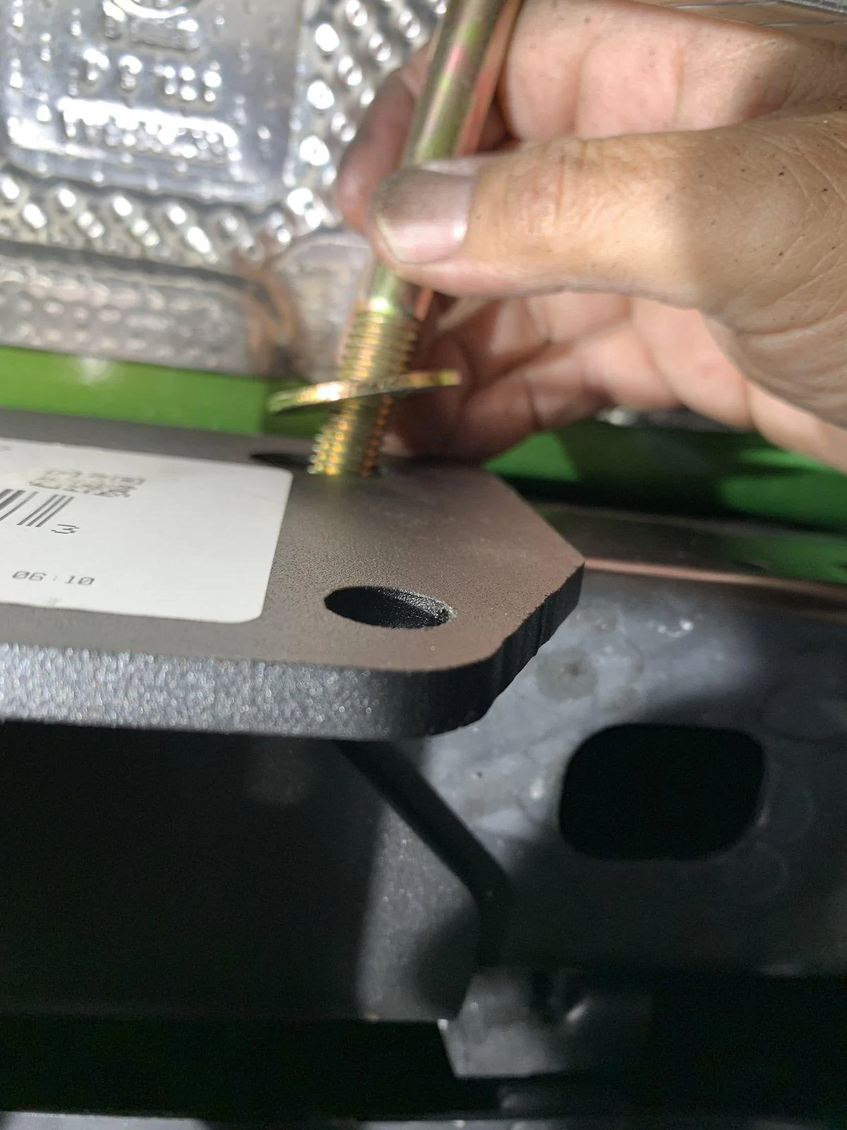

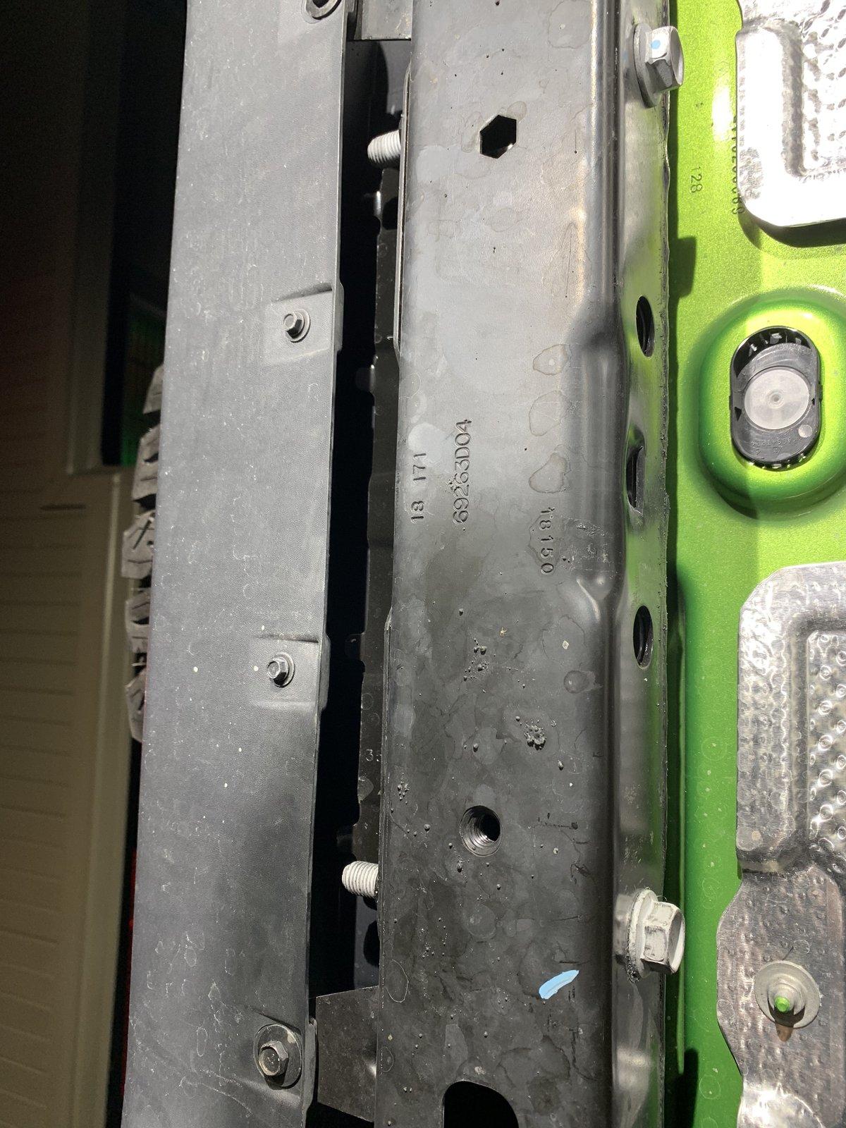

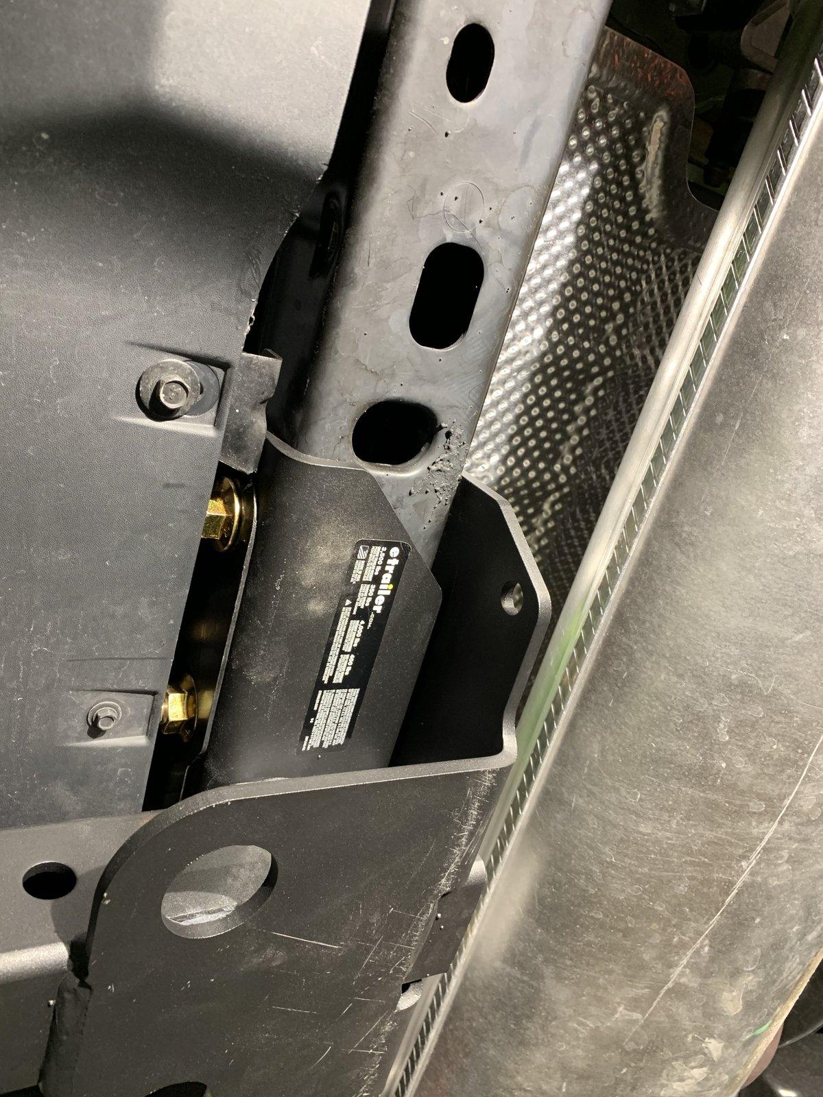

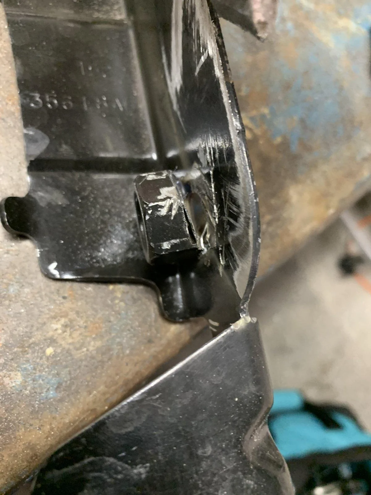

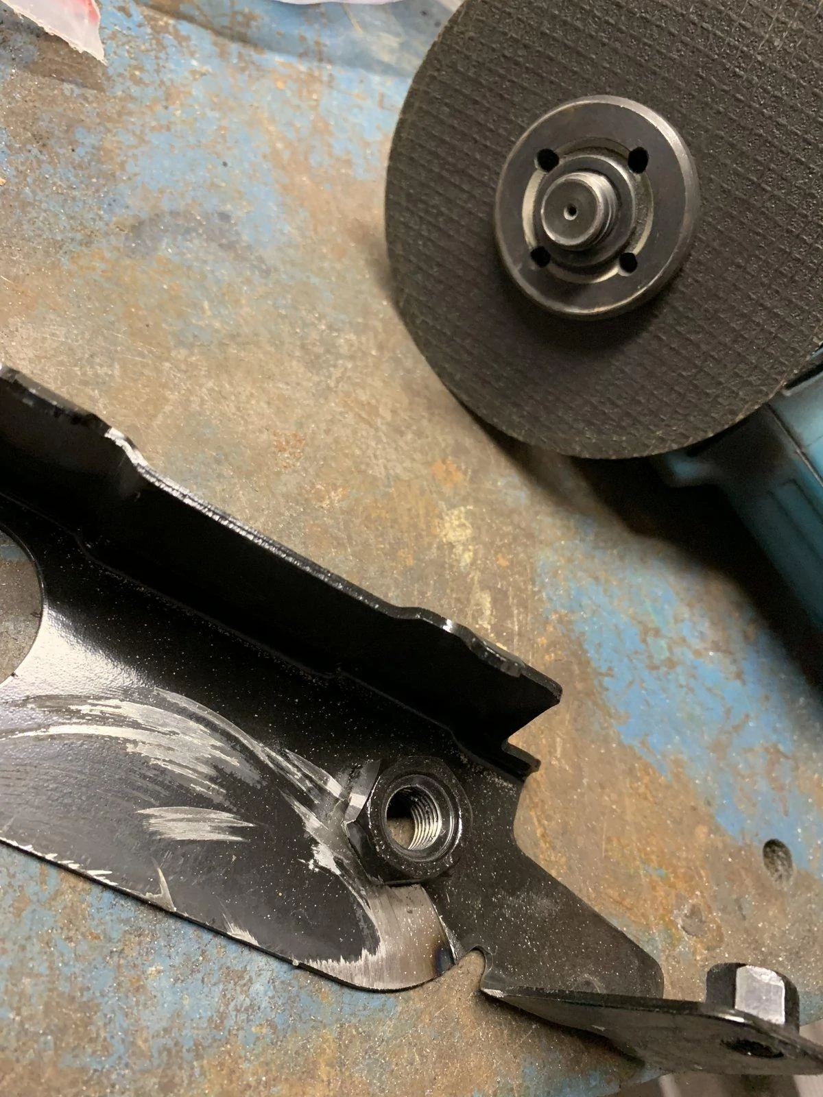

Just to report back, I installed a hitch receiver on my Sahara JL today and it really was a simple job. I took out the two bolts holding that bumper bracket to the bar, then used a tapered piece of wood to create enough space so I could slide the hitch receiver in between. That was easier than trying to manage the receiver with one hand while pulling the bracket away with the other. I went with the Curt receiver which is flat on both sides and fit perfectly. I really don’t know that it would have been as trivial with the Mopar or Rugged Ridge versions as they both appear to have nuts welded on the rear side, so making enough space for the receiver to slide between would have been tough.
