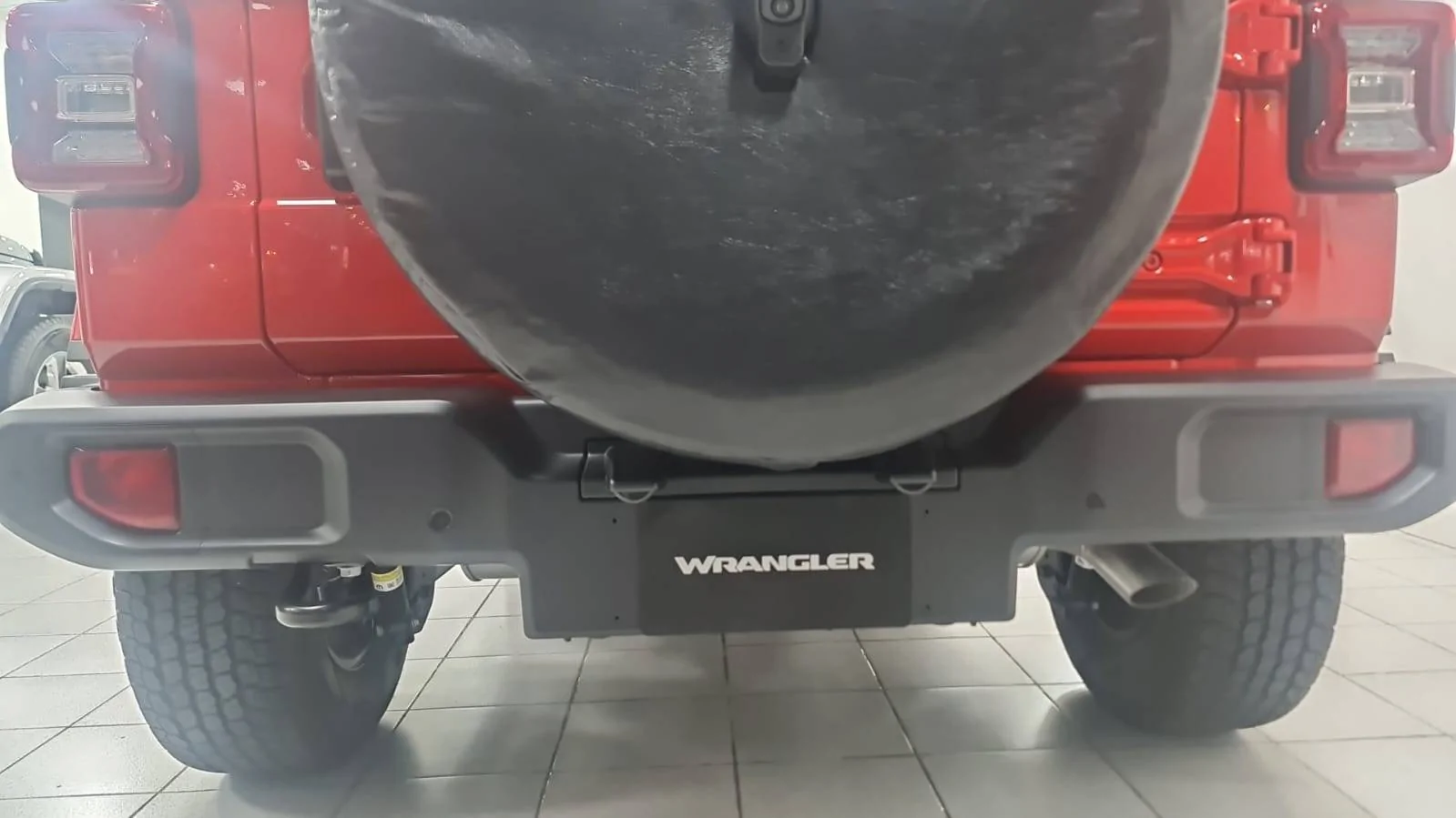

I went to the dealership and took a picture of a display sahara, I think the bumper in my region is different than most other countries? This number plate holder covers where hitch would be... Would the above suggestions still work or do I need to change the bumper
A good question. Yes, that's a foreign market bumper. Are you able to observe any other Wranglers in your area, to determine if or how receiver hitches were installed on their vehicles?
As pictured, it's difficult to envision how a hitch could be installed on that Sahara, or any other Wrangler that is encumbered with that rear bumper design.
