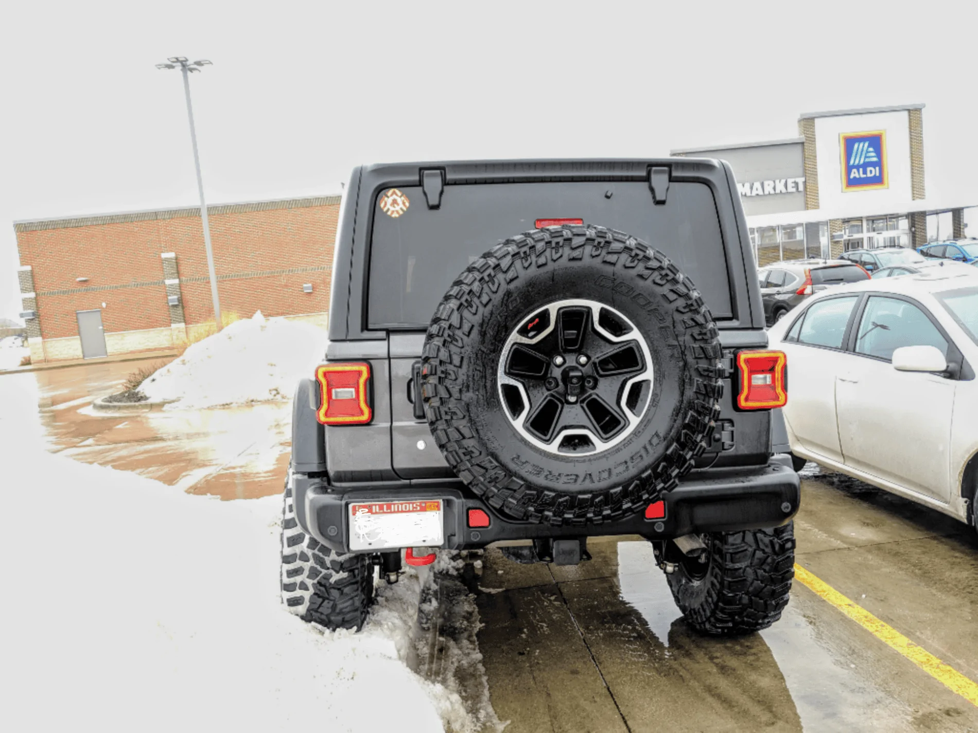

Had mine on for a year now and no sign of any sag or movement of any kind.
37*12.5*17 with 4.5” backspacing.
