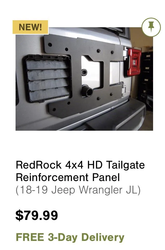

Here’s a new offering from RedRock... on extreme terrain parts. $80 seems very reasonable... and that might even give a good mounting place for a jerry can.
I saw this the other day... this seems far too good to be true, but other RedRock products have solid reviews. Anybody have any reasonable thoughts on this? I might give it a shot just for the price, I guess.
