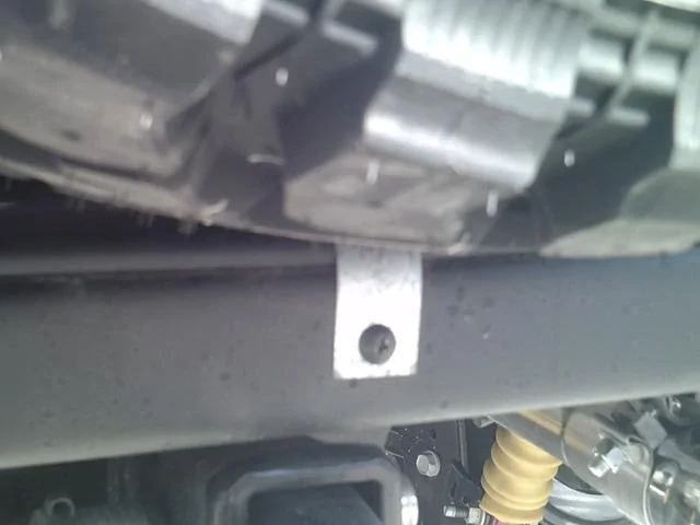

This takes the weight/strain TOTALLY OFF THE TAILGATE/HINGES/SPARE MOUNT--cheap
Jeep Wrangler JL Please Explain... Mopar Swing Gate Reinforcement SUNP0238_zpsccrjbuit
Jeep Wrangler JL Please Explain... Mopar Swing Gate Reinforcement SUNP0237_zps4krkvqzy
It's a tapered shim--free, cause I had it--

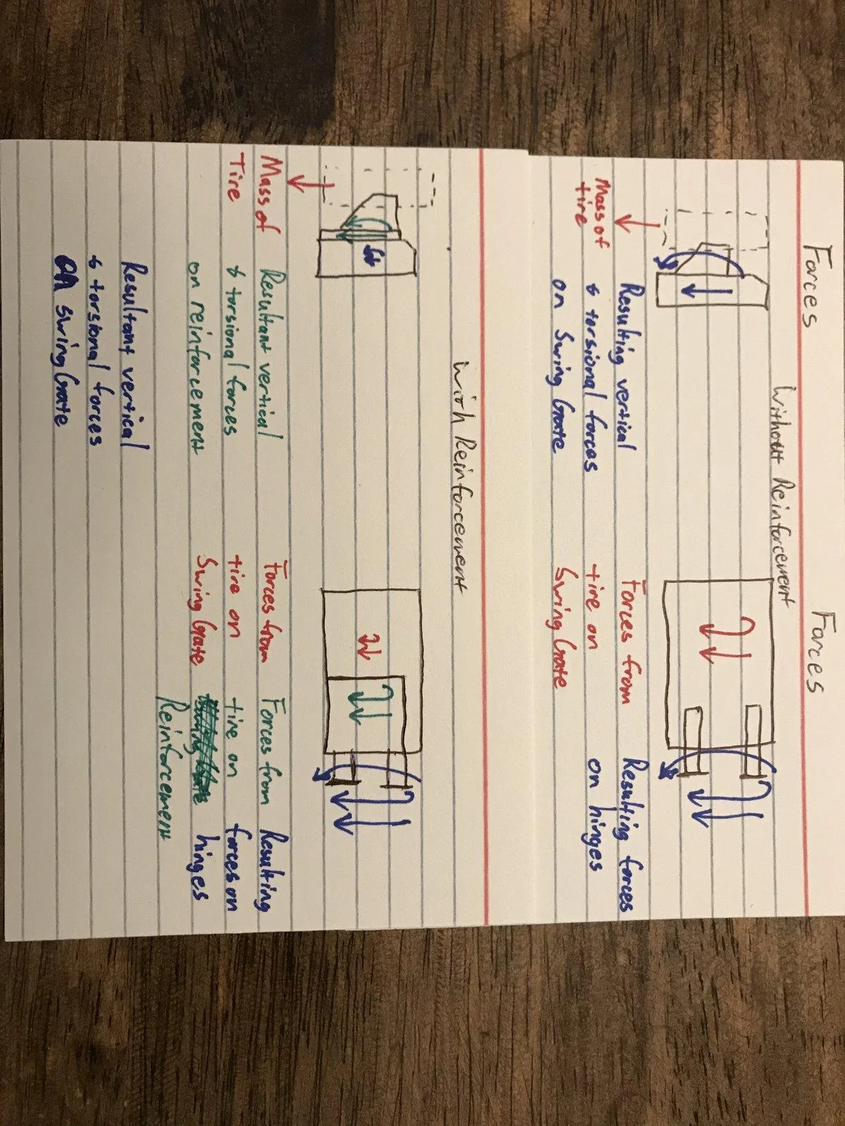

@nbtchicago, @Spank; here is a very basic diagram of the forces. As stated by others, the reinforcement isn’t for the hinges. It’s for the gate itself. It keeps a heavier wheel and tire from bending the swing gate. And spank is right, it doesn’t take stress off of the hinges...and I don’t believe it’s advertised to. However, the bracket is made to be super stiff in order to resist the forces generated by the mass of the tire. By being less flexible than the swing gate and connected to the hinges, it takes stress off of the swing gate. Kind of like how a dual rate spring has one rate to handle normal forces and a stiffer rate to handle what the softer rate can’t. The process is just kind of reversed for the reinforcement bracket. Think of it this way, if you have a flat piece of metal laid flat between two saw horses and push down, it bends easily. Now if you take a piece of angle iron, lay one side flat and push down, even a lesser gauge is harder to bend because the vertical side of the angle iron resists the vertical forces better than the flat side. As I stated earlier, it’s not an ideal solution as you still have the weight on the hinges as spank pointed out. This is why I said that IMHO, for the price (assuming you are planning to replace the bumper) it’s a much better option to buy a bumper with a built in tire carrier. Also...please excuse my bad handwriting...I’m an engineer...not a writer. OP...I hope I have answered your question and helped you make an informed decision.
