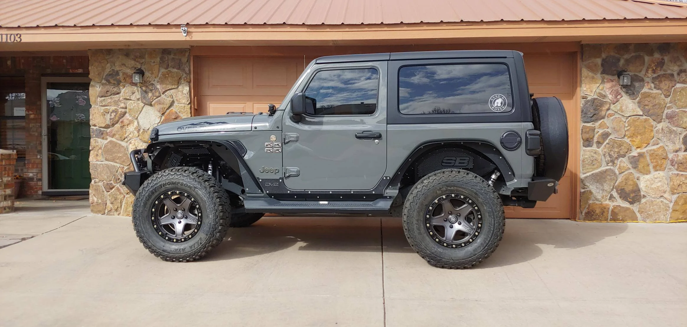

I put a 3/4" spacer on my Rubi springs (from a loaded 4dr) to level it out after adding winch/bumper, worked well. I then removed the front spacer and added Teraflex 4dr leveling kit (2" front 1.5" rear spacers) to run 35s (315/70/17s), this kept it level. Need to add at least Mopar lift LCAs to keep the caster in the 5-6 range though.
