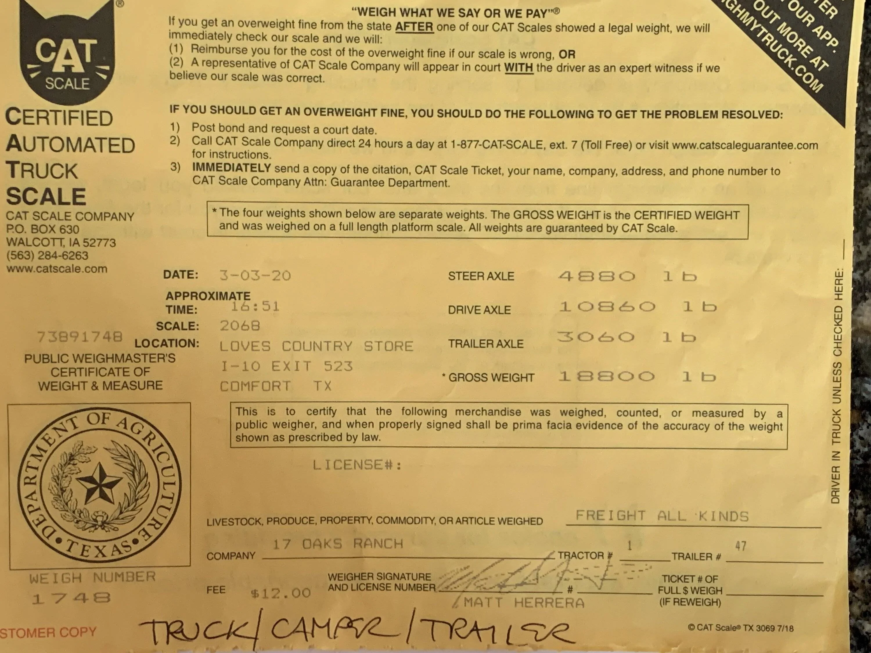

Not so much the weight of the trailer 1000 lbs, but rather the Tongue wt. Here is how I mitigate it:
1). With your trailer loaded if possible get a couple of stick on bubble levels. I use 4. One one each side atop the fender centered above the axle and if you a common V nose, one on each legs of the V.
2). Level up the trailer on a flat hard surface so that you can also back your Jeep up to it.
3). Back up Jeep to the Hitch at the front of the V. Hitch needs to have an attachment ball installed.
4). Where is your Ball in relationship to the height of the hitch at the V?
5). Ball to high? or to low. Measure the distance below or above based upon the center of the hitch.
6). Head to Wal Mart or Tractor supply or even Home Depot. They all got balls. Lets say the ball on the Jeep sits 2 in LOWER than the hitch vertical center. Go BUY a Hitch with a 2 Inch DROP...YES drop, because when you go to put you hitch on you will flip the hitch upside down and now its a 2 inch higher.
As for air bags, well the FIRST thing almost 100% of the folks that buy RV towables do is buy air bags. They hook up and note their truck now has a squat, buy air bag, fill them and bingo squat gone...makes sense? YA THINK? Not if you understand what air bags do.
They LIFT your vehicle by exerting up/down pressure on your axle and frame. 4 inch squat gone and all if good...NO its not, you just shifted tongue weight forward to the FRONT axle. This affects, Steering, braking, handling and leaning resulting in plowing.
I installed a set not to long ago, friend bought a 43 ft horse trailer. Up front was a custom 300 gallon water tank. That is because this a trailer set up for show horses. The tank was the passenger side and provided water to the shower on board and the shower for washing the horses. NOW we installed a set of airbags 7500 series and he leveled out his truck laterally. Now the weight is shifted to the light side and the truck handles properly.
They work great when employed to do what they were meant for, lateral leveling and I have employed them several times when I had 5th wheels.
Strongly suggest you go get your righ with trailer unloaded CAT scaled and comeback and Get CAT scaled loaded. About $12.50
Here a CAT Scale Ticket, my F 450 Truck, Camper and my trailer empty

I think you are missing my point.
I only said how I MITIGATE the challenge of pulling a trailer level. I see folks out there on road trailers NOSE in the air and nose down so far it sparks on every bump.
I personally rather use a mechanical connection, such as higher spring weights and adjustable shocks makes a great combo.
I have been towing horse trailers, hay trailers, 5th wheels and more since my days growing up on our horse ranch. I did not use airbags then and don't today unless I have a lateral lean issue.
Here I am rolling at 24-25 thousand lbs gross. I have 6000 lbs in the bed of my truck and 8000 lbs behind me with the trailer and its load. There are no Airbags on this truck. This truck the front axle is rated at +1, that is over OEM, the option package is Snowplow prep which gives me a 6000 lb rated front axle from the factory. The rear axle is rated at 16000 lbs with the optional Camper package and max tow capacity. My max goose neck towing capacity is 45,300 lbs.
I have run when it fit the need but they are last resort, solved with a mechanical solution if you can.
