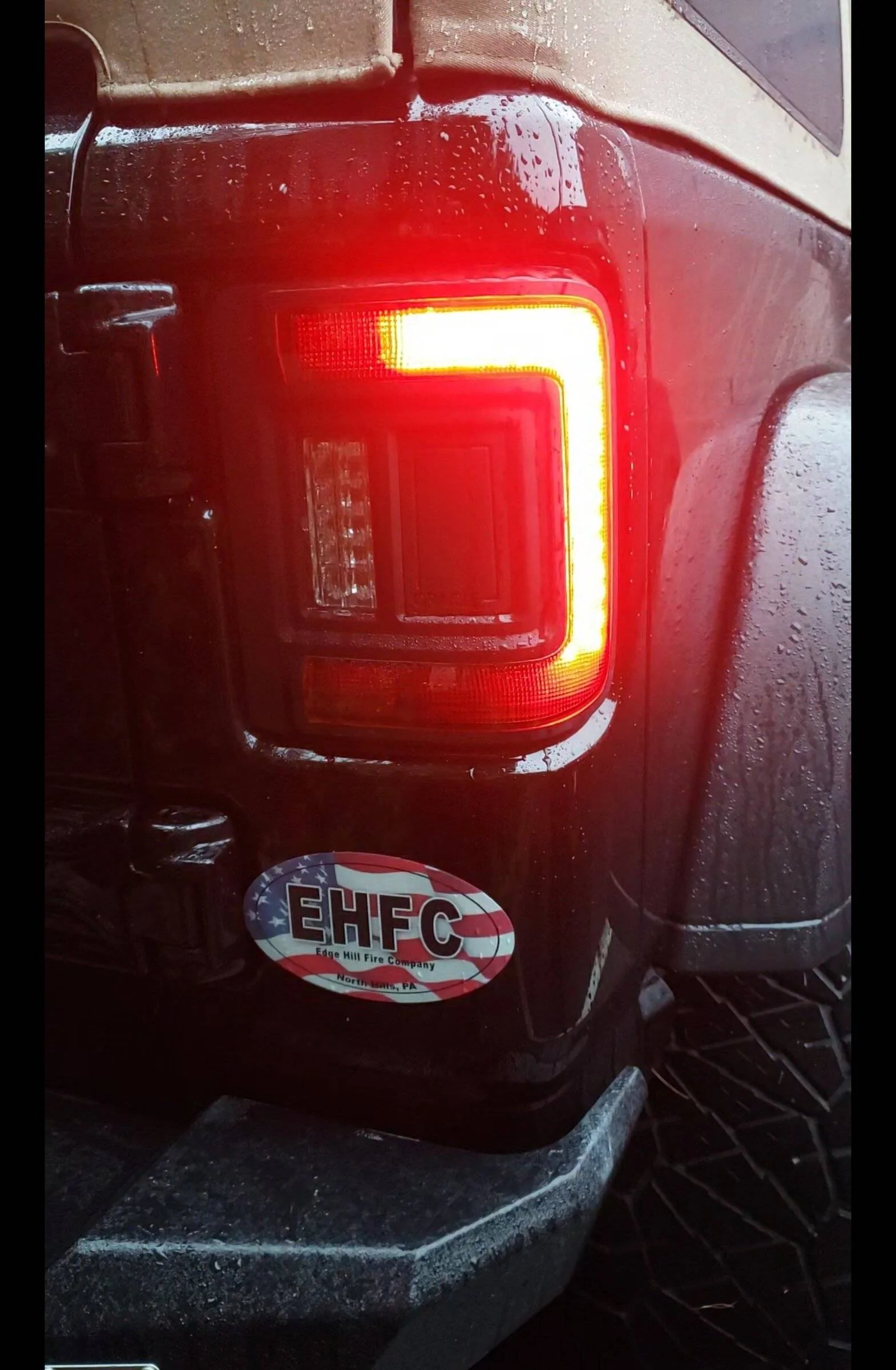

well we made it a month and a half and we've got the bottom 1/3 of a taillight out, looks like due to moisture. Anyone else experienced this?
Yes, I installed mine in February and noticed this just this past week. I sent an email to the Oracle email address that was provided a few pages back in this post.
