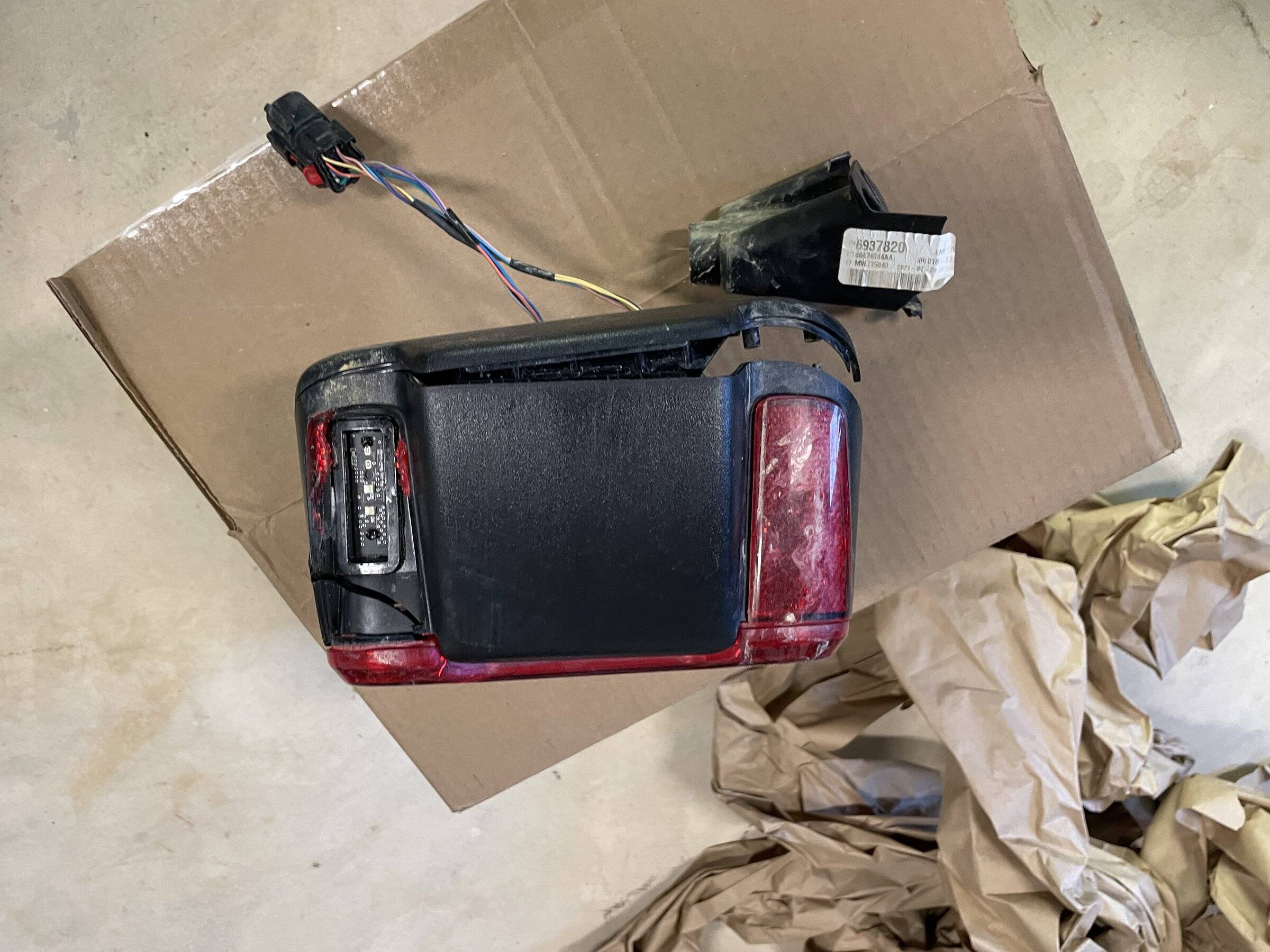

Looks like we’re joining the club. Took out the factory passenger on Windrock 16 this weekend. BSM still works, but no lights, wasn’t a fun 4 hour trip home with no right turn signal.
Local dealer said national back order and $750 for the one light!

Well, lights should be here tomorrow from Northridge, but I'm glad I watched the install video last night.
Didn't realize that the "brackets" are a separate part and not included with the oracles. I believe mine is broken in half. Ordered just the bracket from the dealer last night, and woke up to a "order canceled" email due to "national backorder". Damn.
Every used light on ebay comes with no bracket, most of the new aftermarket brackets are from China with 2 week shipping. Found a couple that are new OEM in the states with one left, fingers crossed it's actually in stock.
FYI if anyone has the same issue, PN (looks like they are universal regardless of LED/BSM):
Driver: 68376497AA
Passenger: 68376496AA

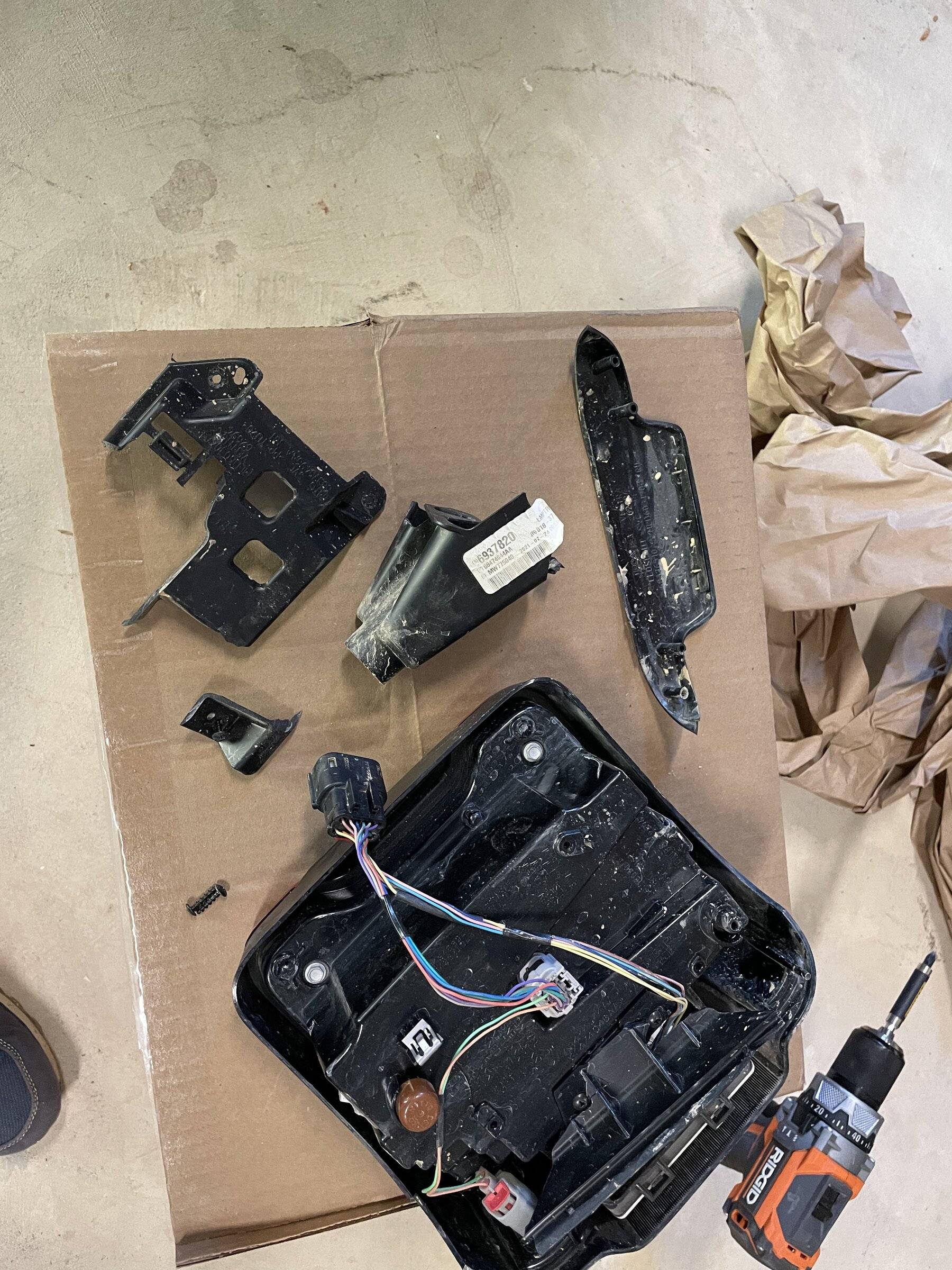

I'll post some pictures of what I did to the stock one when I untape it and pull it apart, I think I also have some gopro video of the section where it happened. The rear slid sideways and tagged the side of a tall mud "rut" on a hill climb. That caught the outer edge of the assembly, and broke all but one of the clips, took out one of the side mounted reflectors, cracked the black plastic part of the housing on three sides, and sheared the bracket.
I always thought the plastic sprung bolt that holds them in was supposed to act as a weak link and give way to save the light, but doesn't look like that happened in my case. Maybe the horizontal pressure of the impact didn't allow it to work.

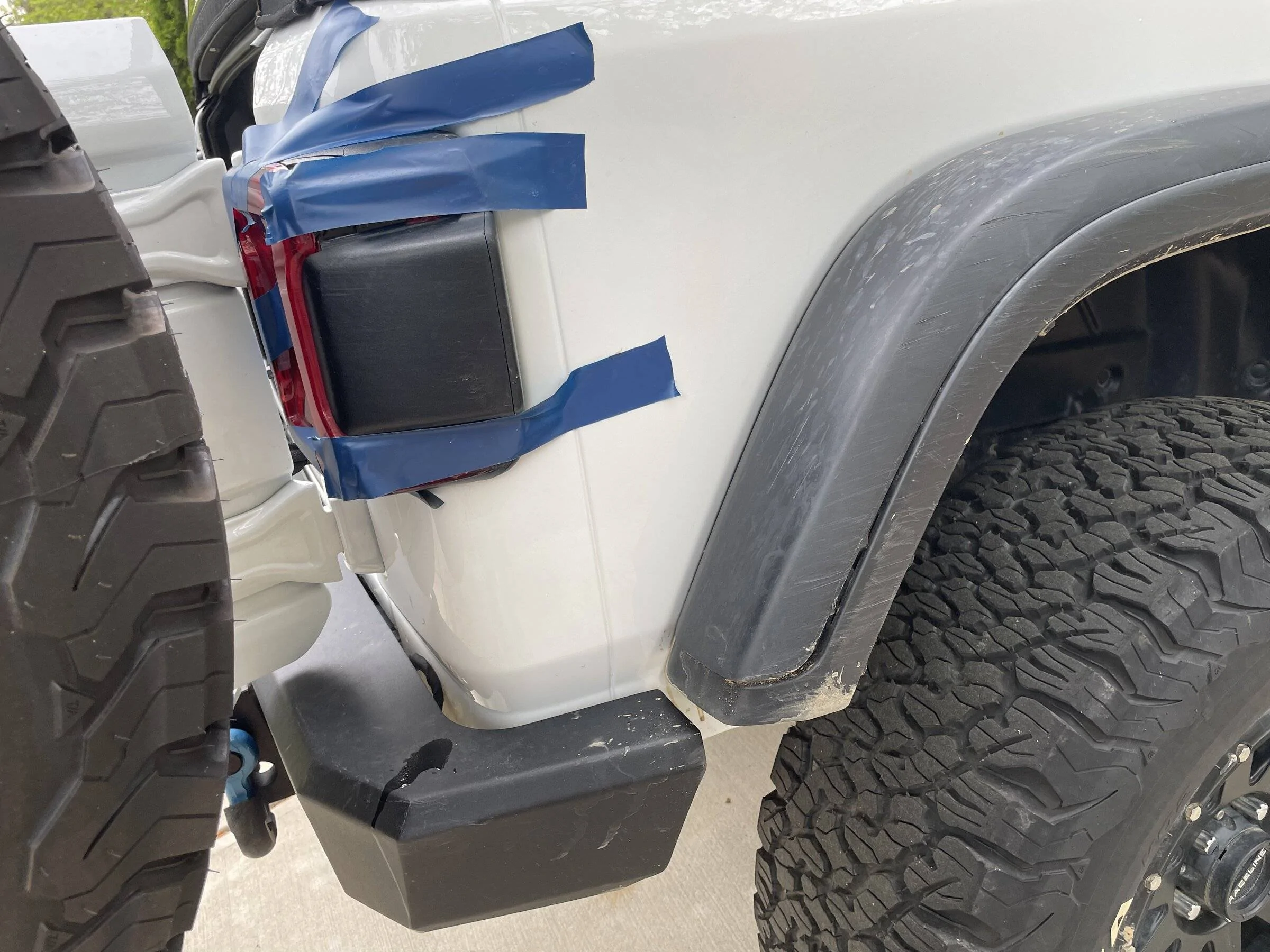

Still waiting on the bracket, so it’s rigged on right now (internal cable ties, exterior tape). Still got to get the other side on and test out BSM.
Destroyed the tail light, but impressed with the Oracles so far.
