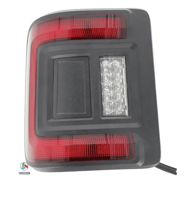

https://mythreedom.com/products/jl-oracle-panels
The "Beauty Groove" panels I installed have worked out well. So much nicer then seeing that fugly Oracle logo on each tail light.
Fortunately, I do not have BSM on my JL ... and no water intrusion issues so far with the pair of Oracle flush mounts I have.. Kept my stock LED tails just in case...
