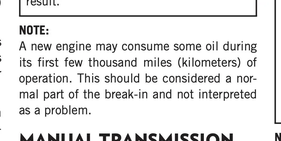

No noticeable oil burn in my 2019 3.6. I do notice the amount showing on the dipstick can vary wildly if you don't follow a consistent method of checking it, and the owner's manual goes over this.
Warm the engine up fully. Park on completely level ground and turn it off. Wait 5 minutes. Then check the oil. If you check it right away it'll likely read low, and if you check it with the engine cold or sitting off for a while longer than 5 minutes it'll likely read high. I would only compare measurements taken using this method, the level can vary enough with temperature and time to give you a completely false idea of what's in the engine, as the engine holds a bit of oil in the upper areas that takes time to return to the pan.
I've gotten good at estimating it in a hurry if I check it quickly while refueling. I expect it to read a bit lower when checked without waiting 5 mins, but still register at the bottom of the stick.
Also, this, from the manual as well:
Jeep Wrangler JL Oil usage.... Screen Shot 2022-10-10 at 3.33.28 PM
