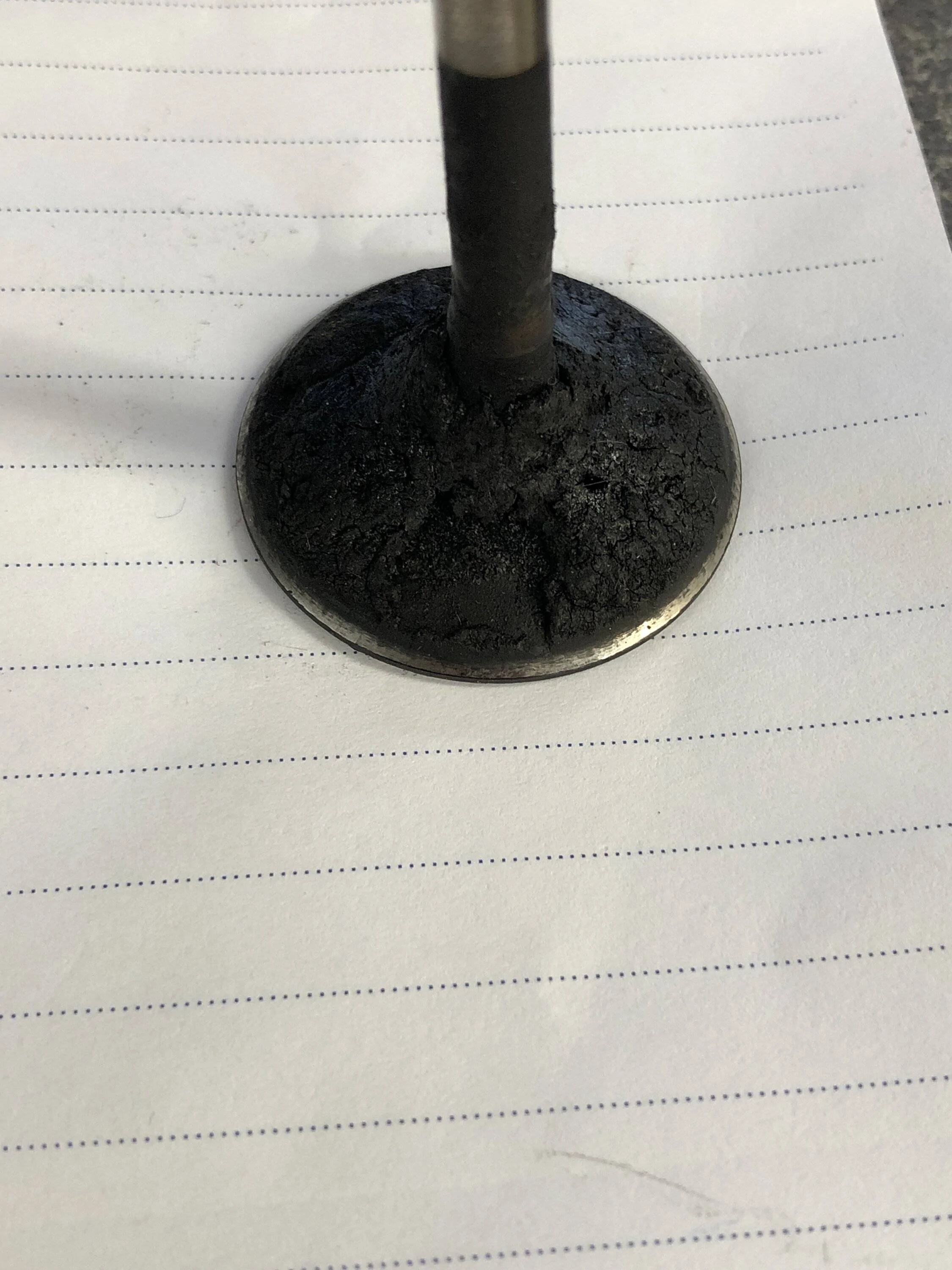

this is a bit misguided. Carbon buildup on direct injected engines is much, much worse. The only reason “cheap gas” contributes to carbon buildup is because it does not clean as well as top tier gasoline. On DI engines, even top tier gas doesn’t hit the back of the valves.
here’s one we pulled out the other day. A GM 2.4L intake valve.

I should have worded it better. I just meant the gas won’t clean the valves on direct injected because it does not wash over them like it does in fuel injected applications.

Oh yeah, it's been known for years that DI causes major buildup.

Yep. It’s why I’m glad I don’t have one. I know they are more efficient but still.
