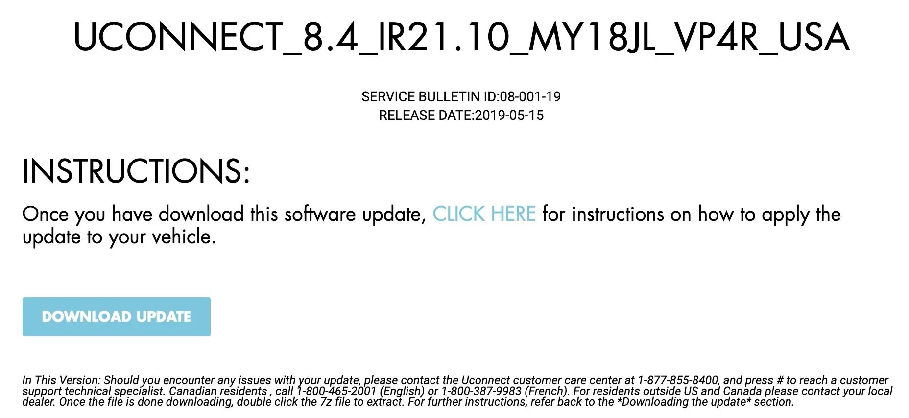

So interestingly enough....I took the jeep in for a couple things including this today...Got it back and still no ORP!!!! Tech already gone so i have to call back tomorrow(I am sure they didn't do anything even though they say they wrote that they did)......Fast forward an hour, and i think hey lets see if the uconnect sight says i have an update available....and sure enough it does, oh and guess what, it is the software update from THIS TSB!!!!So now I sit downloading it and getting ready to fix it my self....
Moral of the story...It is now (possibly)available on the website based on your VIN!!!

was it the TSB one?
Yep, that is the one. Going to try to upgrade the Jeep now. Where you successful?
I was successful, except when checking my current software version now it went from 17.xx to 18.xx, not the 21.10 or higher it stated in the update. I tried to do it again and it said no update to the current software. Great news though, I now have the off road app which is what my only goal was.
I’m going to clear my Zip drive, download the update again and try to upgrade again to see if it will update to the 21.10 version.

Anything special that needs to be done? I clicked on the instruction link but it wouldn’t display anything. I downloaded it to a hdd that had FAT formatting and the uconnect system wouldn’t recognize when I plugged it in.

Yes, try it again. You need the instructions. Not sure what FAT is. You need to down load it to a 16g Zip drive. Good luck.

Then you started the Jeep and plugged it into the usb (anyone) and it started up?

Never mind, I was able to get it going. Thank you

After 2 wasted Saturdays at the dealer and countless phone calls that went nowhere I updated my radio in 25 minutes. Thank the lord that they allowed us to download this.
