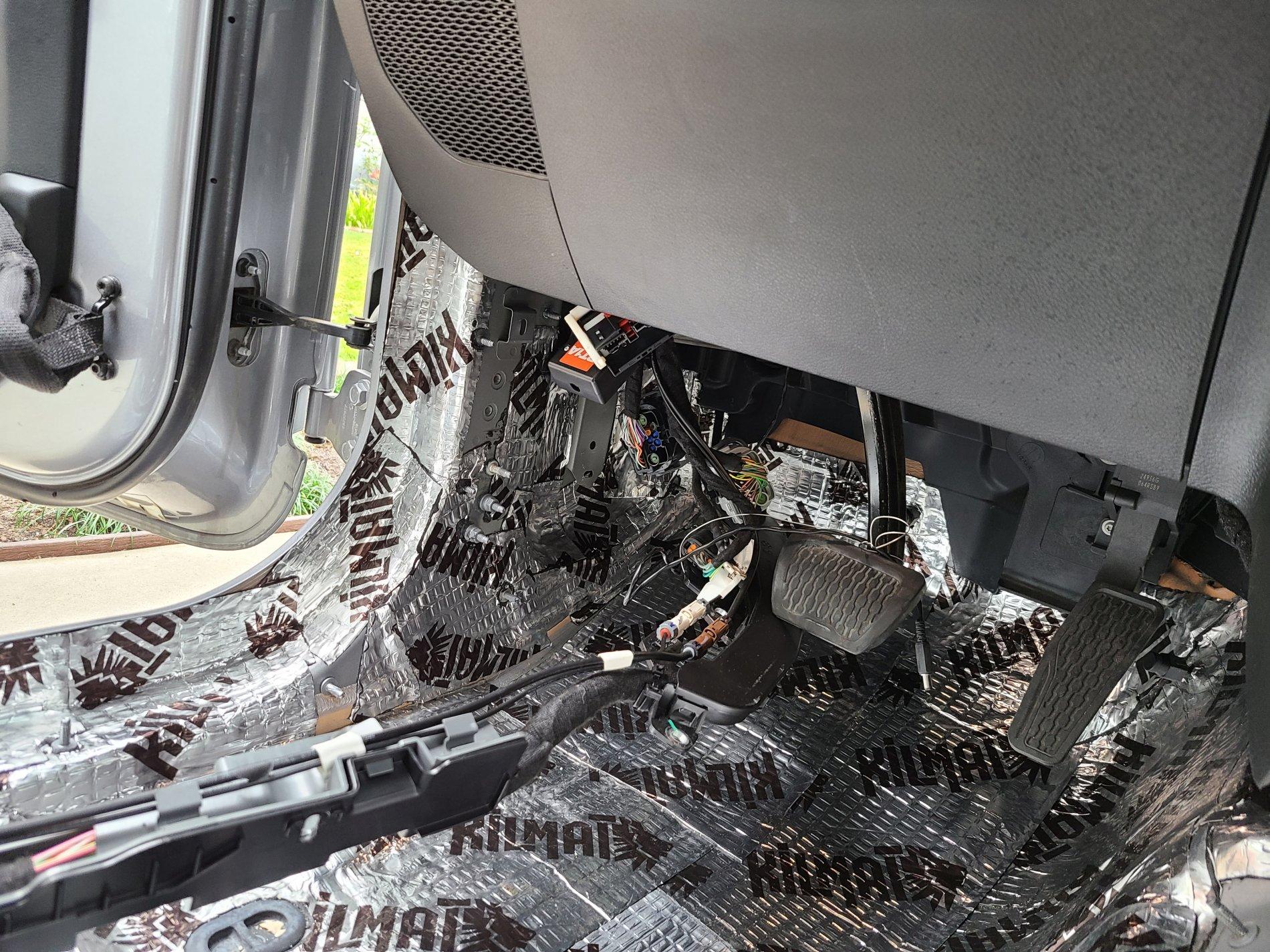

I'm on day 3 of actually laying down Kilmat. I have lined the firewall and front footwells over the tunnel, left front kick panel, left rockers back and up the rear fender, and left B pillar.
I went overboard and I'm blaming it on you. You mentioned the door seals seemed to let lots of noise in. I saw lots of noise with my meter around the door seals as well. After looking at the door jambs, I think they were worth insulating too. But man, what a pain. I removed the harnesses and all the components on the B pillar. Also, the front kick panel has a shape like a speaker cone that I'm sure is the perfect road noise resonator, so I lined it as well.

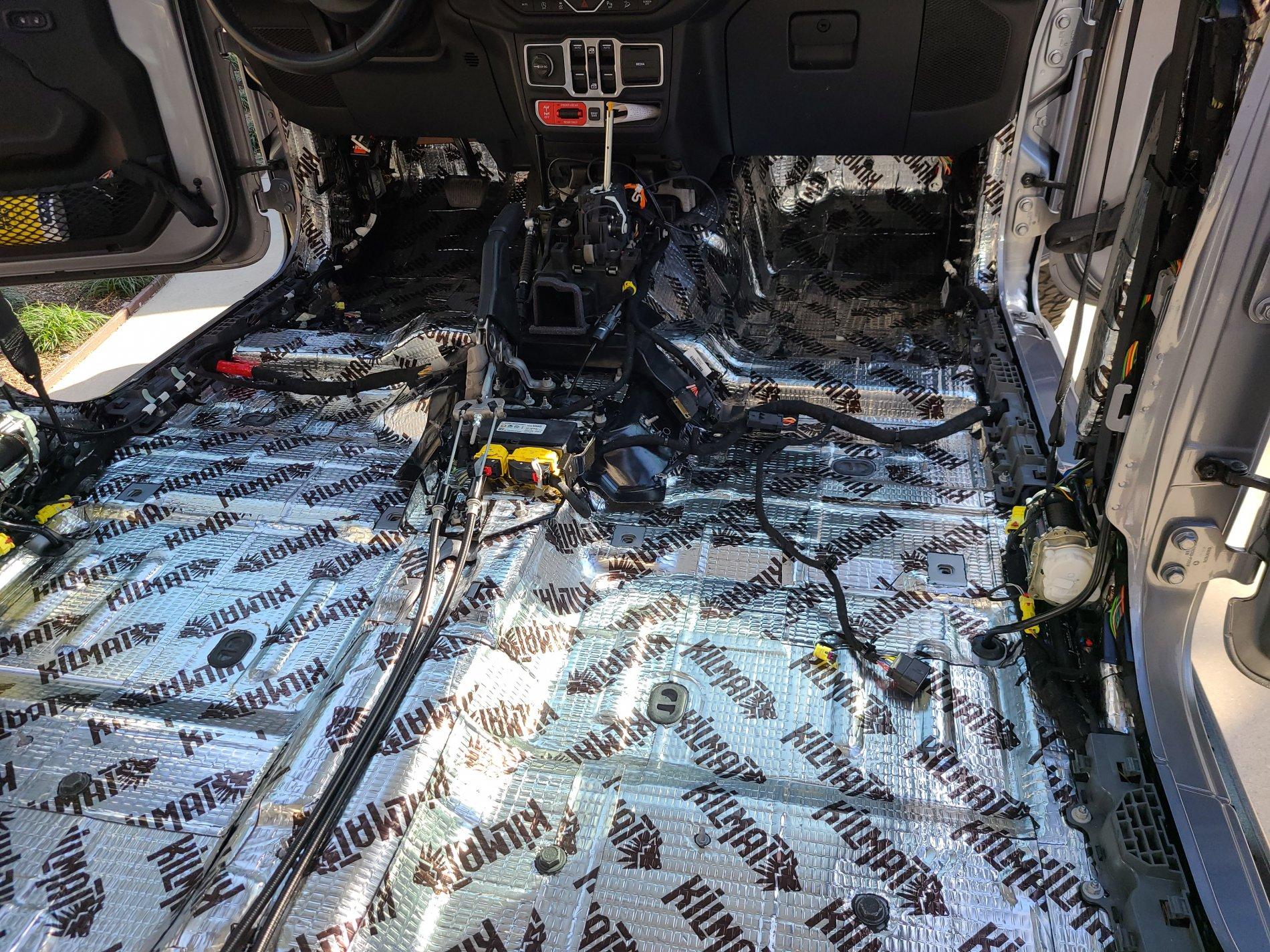

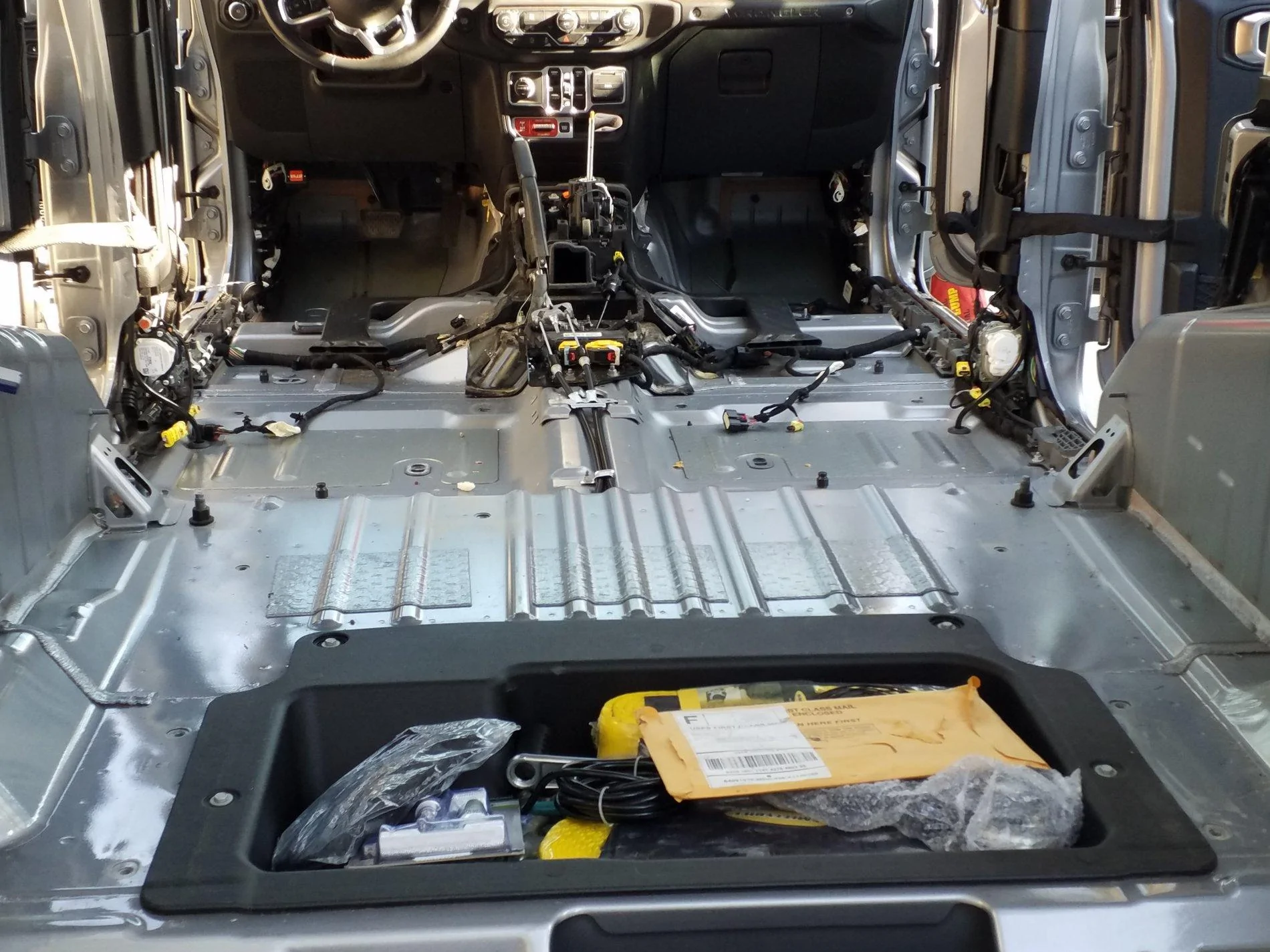

Well, this is going slower than I thought. I used to be sorta fast. Well, maybe half fast.
At almost 2 weeks. I'm within an hour of finishing the aluminum/butyl damping layer. But, I ran out of material. Some more should be here today.
I only have a few square feet left to cover of mostly flat in the cargo area. Then I'll cover in Dynaliner foam absorbing material.

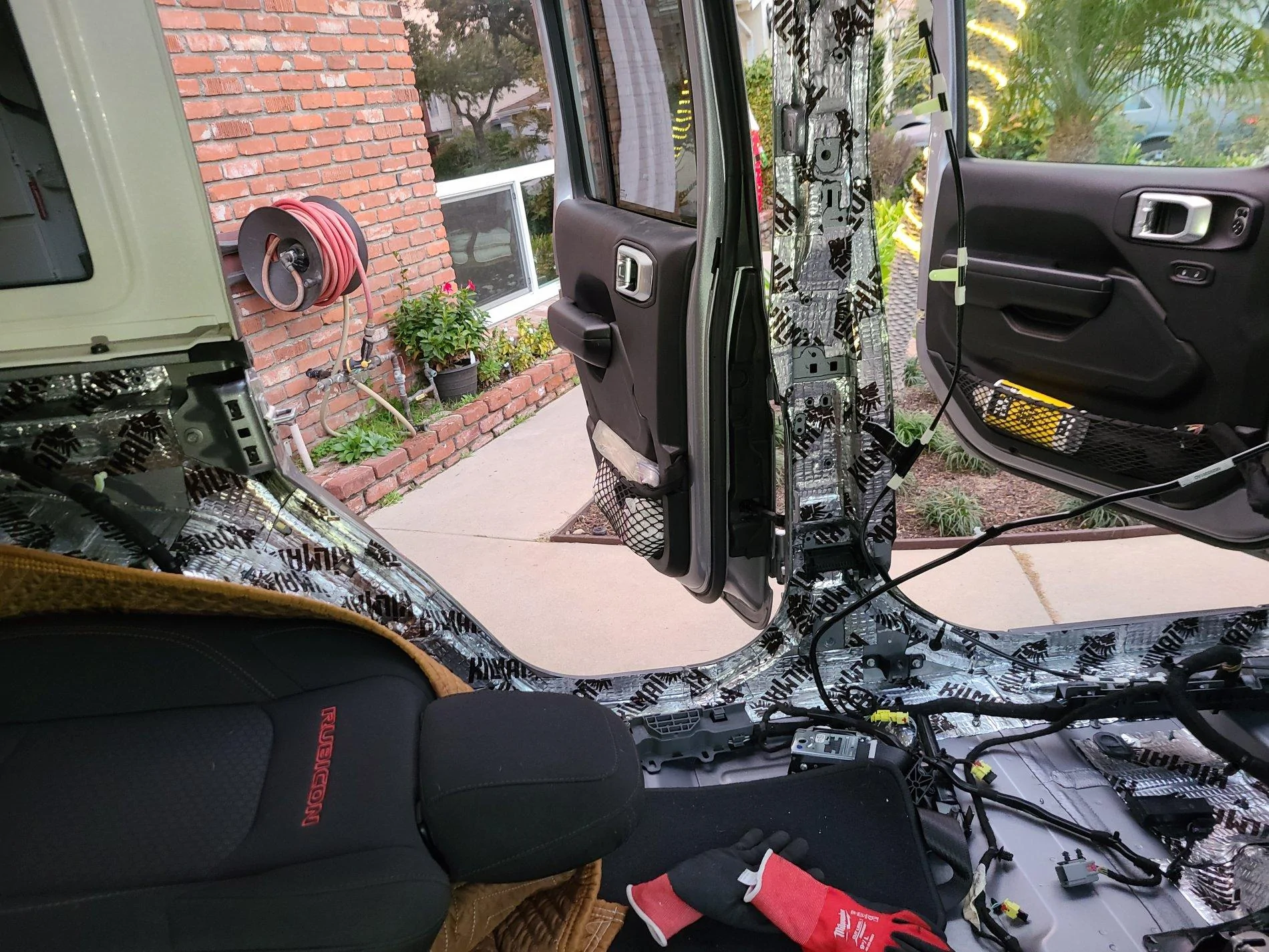

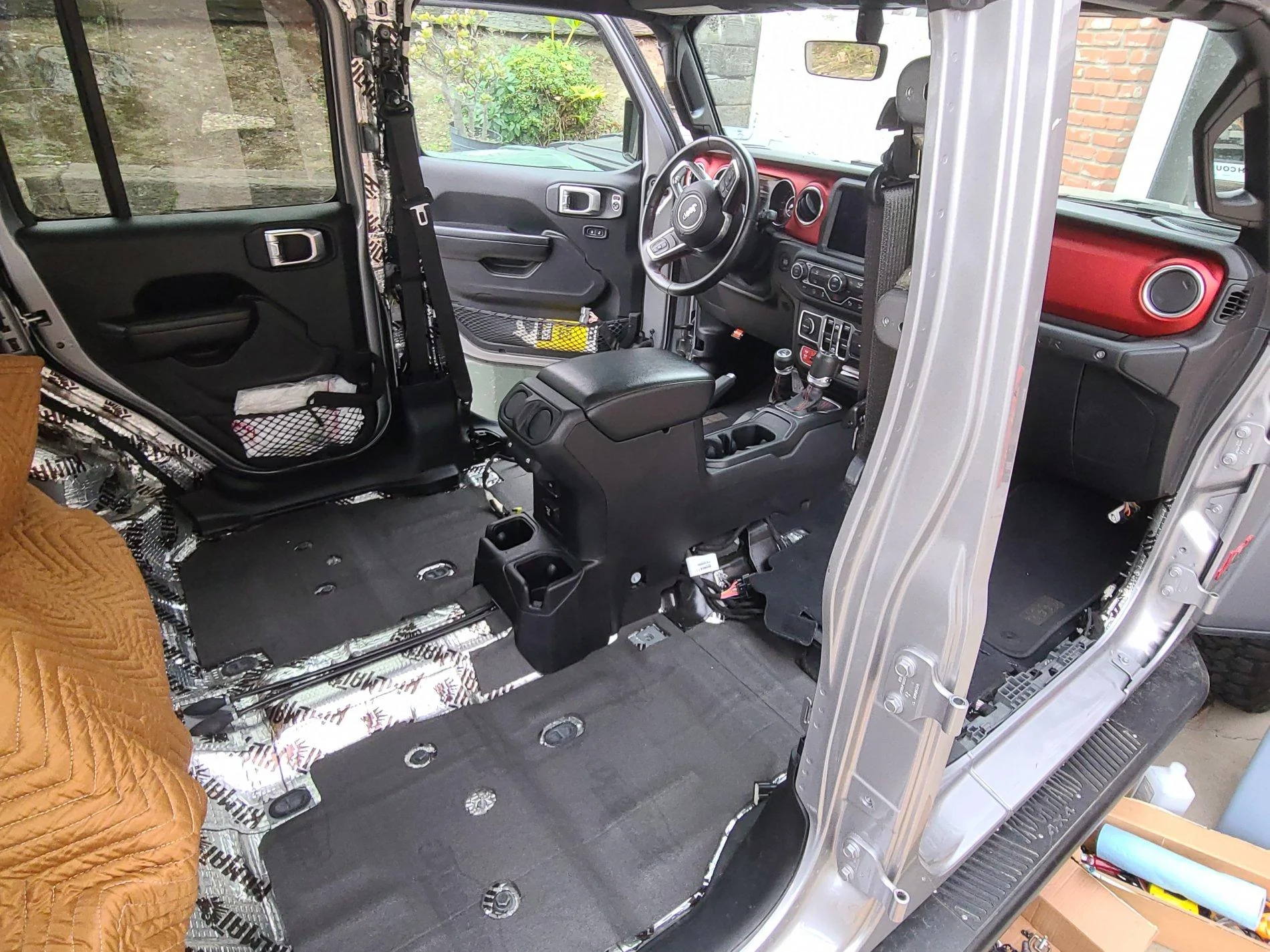

Good thing we're on a stay at home executive order. But I'm making progress.
I finished covering the tub with Kilmat about as close to 100%as I could.
The B pillars are reassembled and only need the covers installed.
All the wiring is reattached to the rockers.
I've covered the front footwells and tunnel with 1/4" Dynaliner and I have front carpet down and the console installed and wired.
The rear footwells are also covered with Dynaliner on the flats all the way back to the rise in the floor to the cargo compartment.
It should go pretty quickly from here.

Of course, I finished and have the JL back together. I have driven it a few hundred miles, including a couple hundred on a trip up the state a hundred miles or so. The noise level is noticeably lower. It was a comfortable level on the trip. I have not taken a meter reading to compare to the reading I took prior to modifying it. However, it is lower enough to begin hearing other noise sources. Most notably is the drumming of the hardtop from flexing in the middle, when bumps in the road trigger it. I'm working on a solution for that. I'm also considering the CoverKing hardtop liner.
