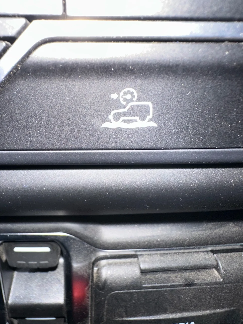

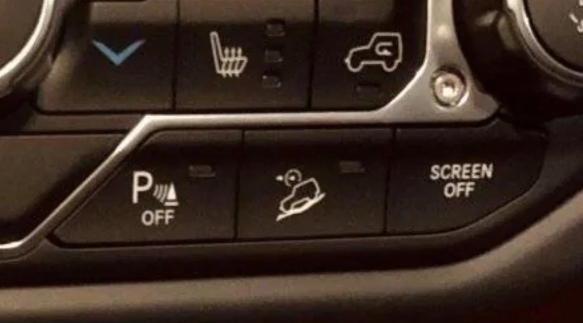

Well it appears there are two separate options with duck buttons depending on the year and model maybe
I have a 23 3.6 Rubicon auto with Selec-speed with a duck traveling horizontally as opposed to hill descent with a duck traveling downhill. I’m sure mine must be better somehow 🤓
