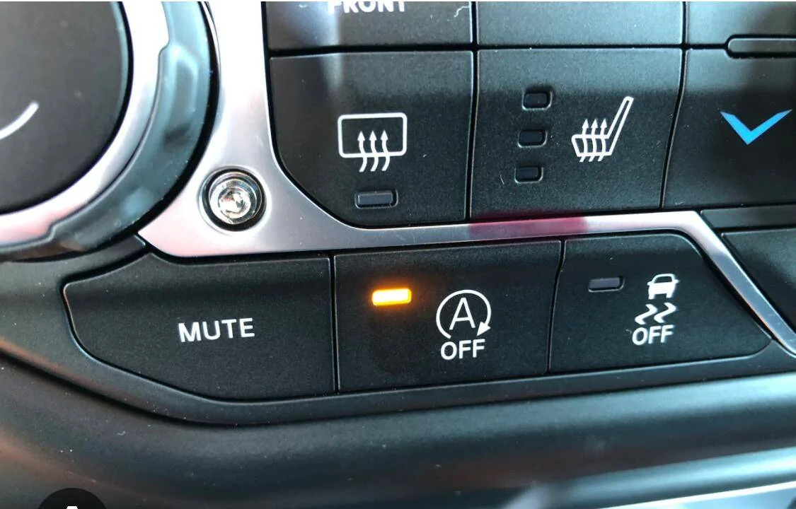

My Jeep was manufactured in Toledo, Ohio. It's a base model. That means I have roll up and down windows. Key entry. Basic radio (no gps screen). So it is not remote start. It is push button start. It is a 6 speed manual transmission.
When I go to exit the car I, stop, put the car in neutral, pull the emergency brake. Shut the car off. Open the door. Radio shuts off,I put my feet on the running board. The car turns itself on.
OminousSkitter
Aug 29, 2019
1,490
2,203
The Ether
Trek Bicycle
No manual has remote start—even with the cold weather package. Since manuals are rare, some people don’t realize this. Definitely disregard any advice talking about remote start. 🤷
To me it sounds like ESS (buggy software or software is performing as intended but not as expected). If it’s related to ESS (which all JLs have to the best of my knowledge, but I don’t know about diesels or 392s), it might be triggered when the seat detects you’re getting up. You could try disabling ESS before you turn off your Jeep (the A/circle arrow button, light on means disabled) and see if that helps.
Side note: unless you install something like a tazer (and change the setting) or Smart Start Stop, ESS defaults to enabled every time you turn on your Jeep.
Just to satisfy my own curiosity, how do you eventually turn it off? Surely it hasn’t been running for days?
Edit: picture of disable ESS button
