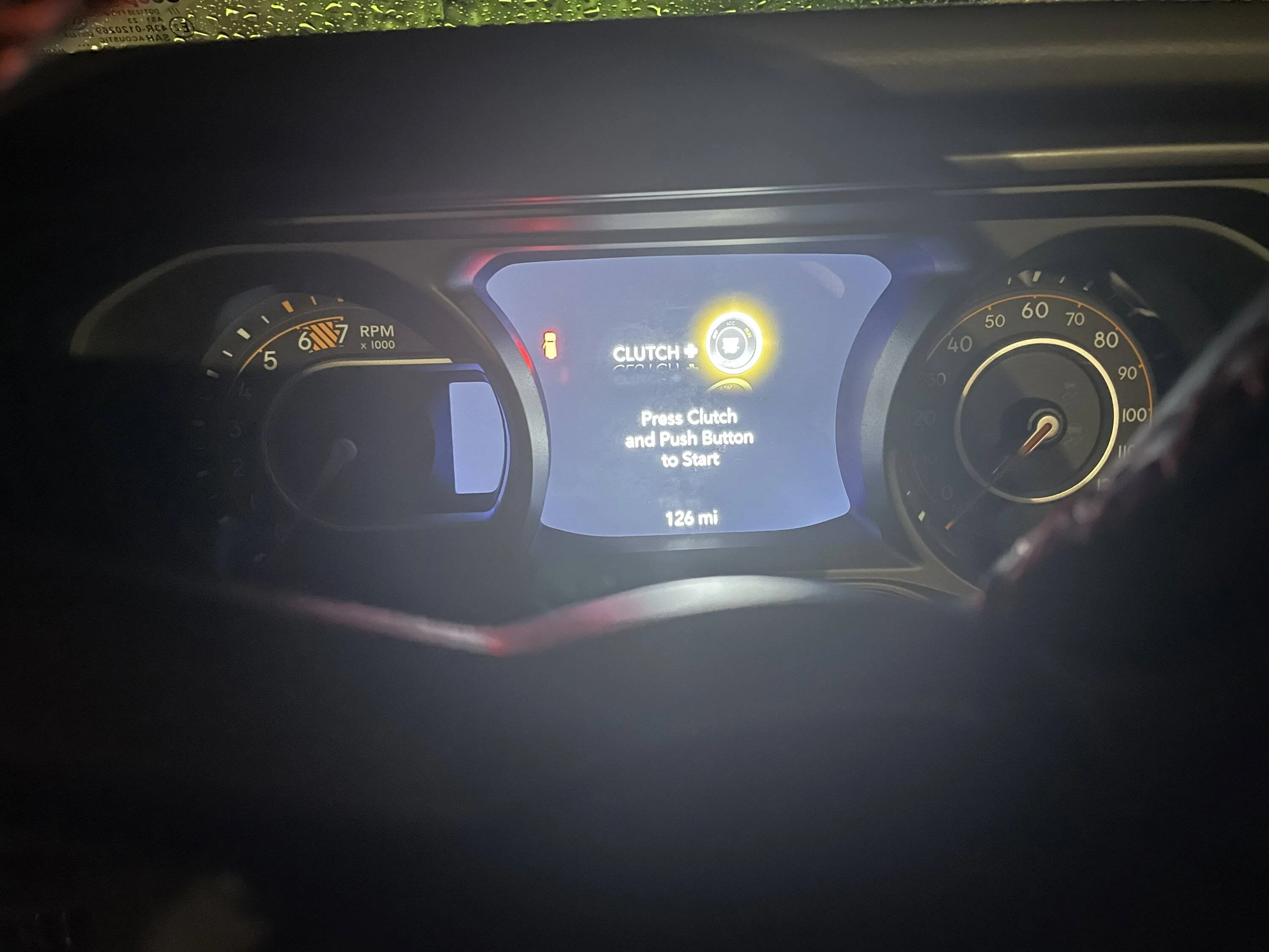

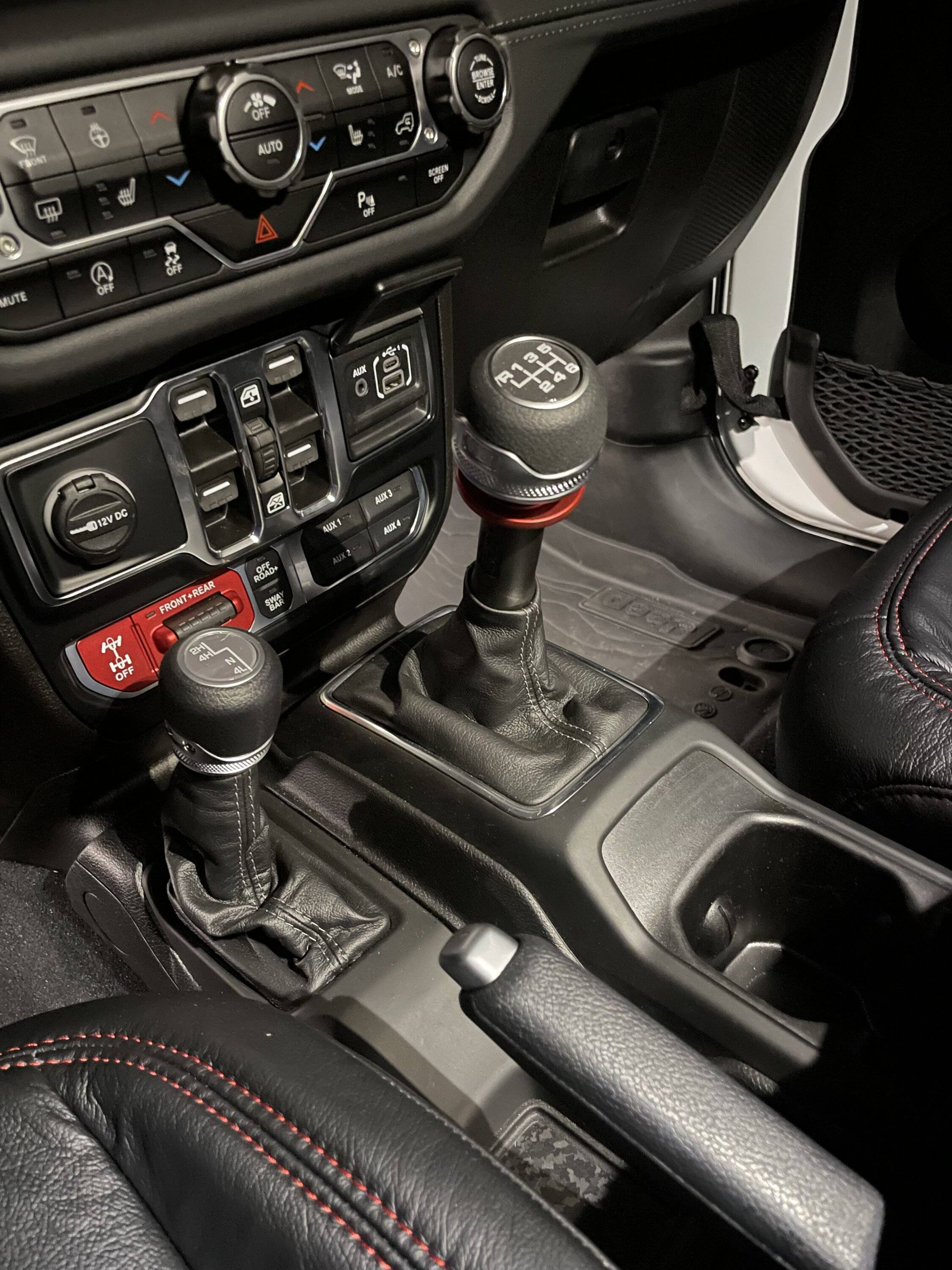

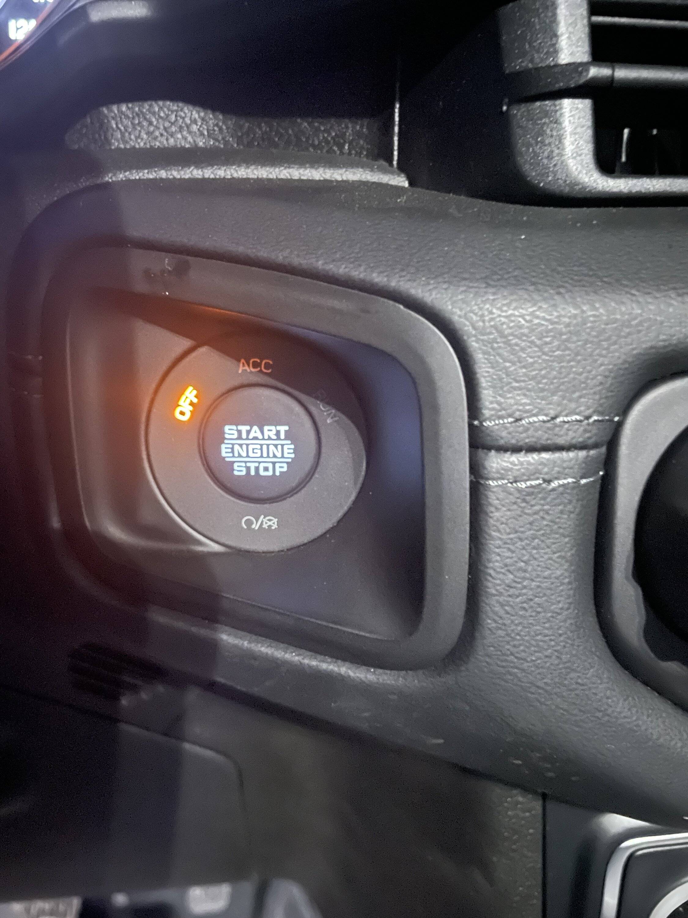

Post a picture of the cluster, the transmission shifter, and the start pushbutton, maybe a clue hiding.

Jeep Wrangler JL Press Clutch and Push Button to Start IMG_6535
Jeep Wrangler JL Press Clutch and Push Button to Start IMG_6534
Jeep Wrangler JL Press Clutch and Push Button to Start IMG_6533

Eh damn it’s a stick there goes that theory. Do the doors stay locked?
