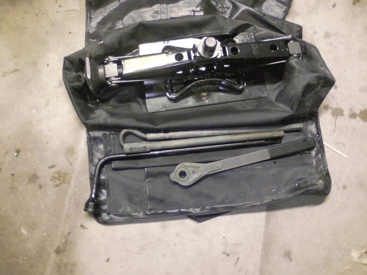

I have a HUMVEE 3.5 ton scissor jack that I kept in my Sportsmobile (it weighed right at 5 tons). It has never been used and is too big to lug around in the Jeep (in hindsight, I should have left it with the Sporty when I sold it). It is like this one, but new / clean. Agile Offroad at one time made adapters for the knob on this to interface with the Safe Jack pieces... I couldn't find it on their web site anymore, so that has probably faded into history - similar idea to the OP, but with a bigger jack.
Not sure what to do with this silly thing...
