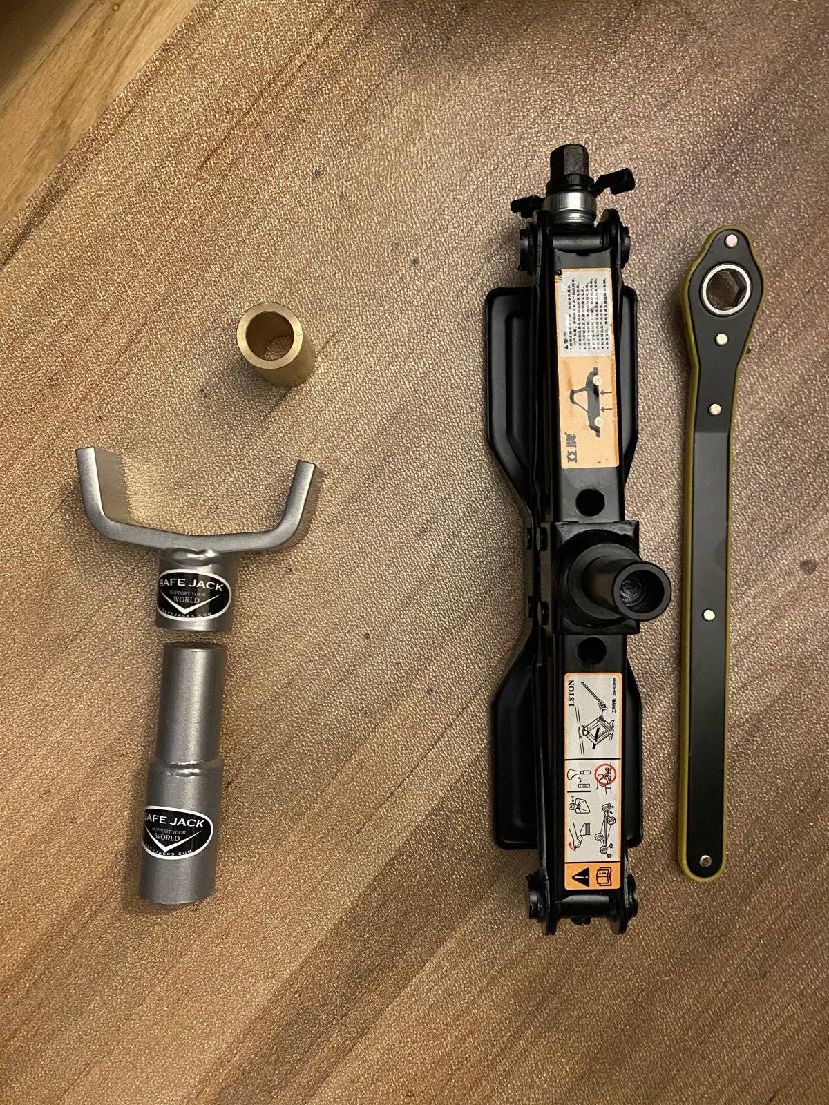

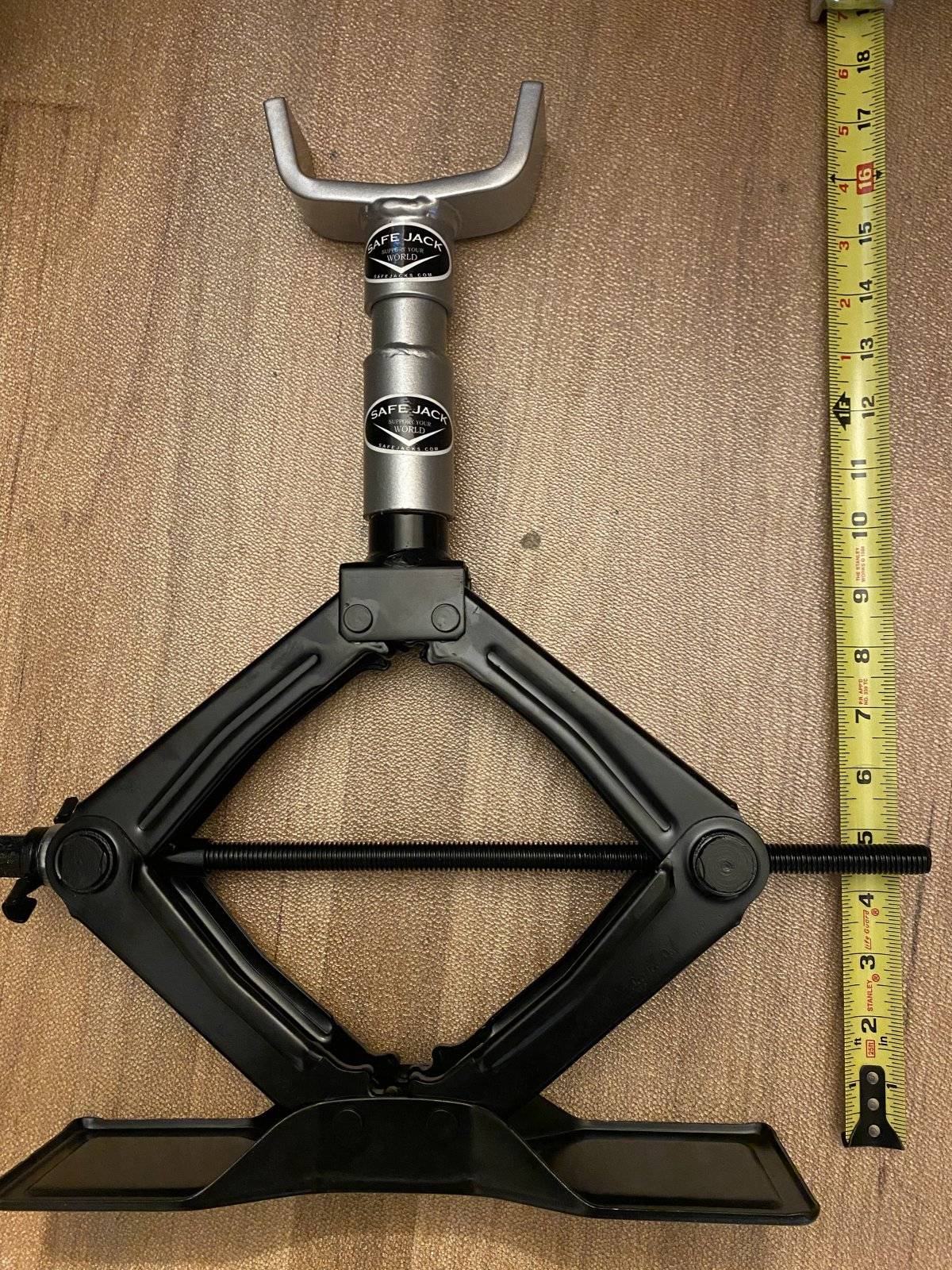

I bought this scissor jack from Amazon for two reasons which I prefer over the OEM jack:
1) has a wider base plate
2) has a cylinder on the top
OEM jack has to be cranked to the max and maybe with a 2x4 underneath to be useful for a Jeep with a lift and larger tires.
The aftermarket scissor jack comes with a ratcheting bar (11/16” hex). I ordered a 7/8” ID 1-1/4” OD 2” length brass bearing from Grainger which fit perfectly as a spacer between the cylinder at the top of the jack and the adapters from Safe Jack. With the scissor drive cranked about halfway, I am already achieving 17” lift.
scissor jack
https://www.amazon.com/gp/aw/d/B081H362TK?psc=1&ref=ppx_pop_mob_b_asin_title
Safe Jack extender adapter
https://safejacks.com/collections/bottle-jack-accessories/products/3-piece-starter-kit
brass spacer (pack of 3)
https://www.grainger.com/product/13...gucid=EMT:10376092:Item:CSM-329&emcid=NA:Item
All together it’s over $150 plus tax and shipping. But it makes for a nice compact kit. The jack comes from China but Safe Jack and the spacer are US made.

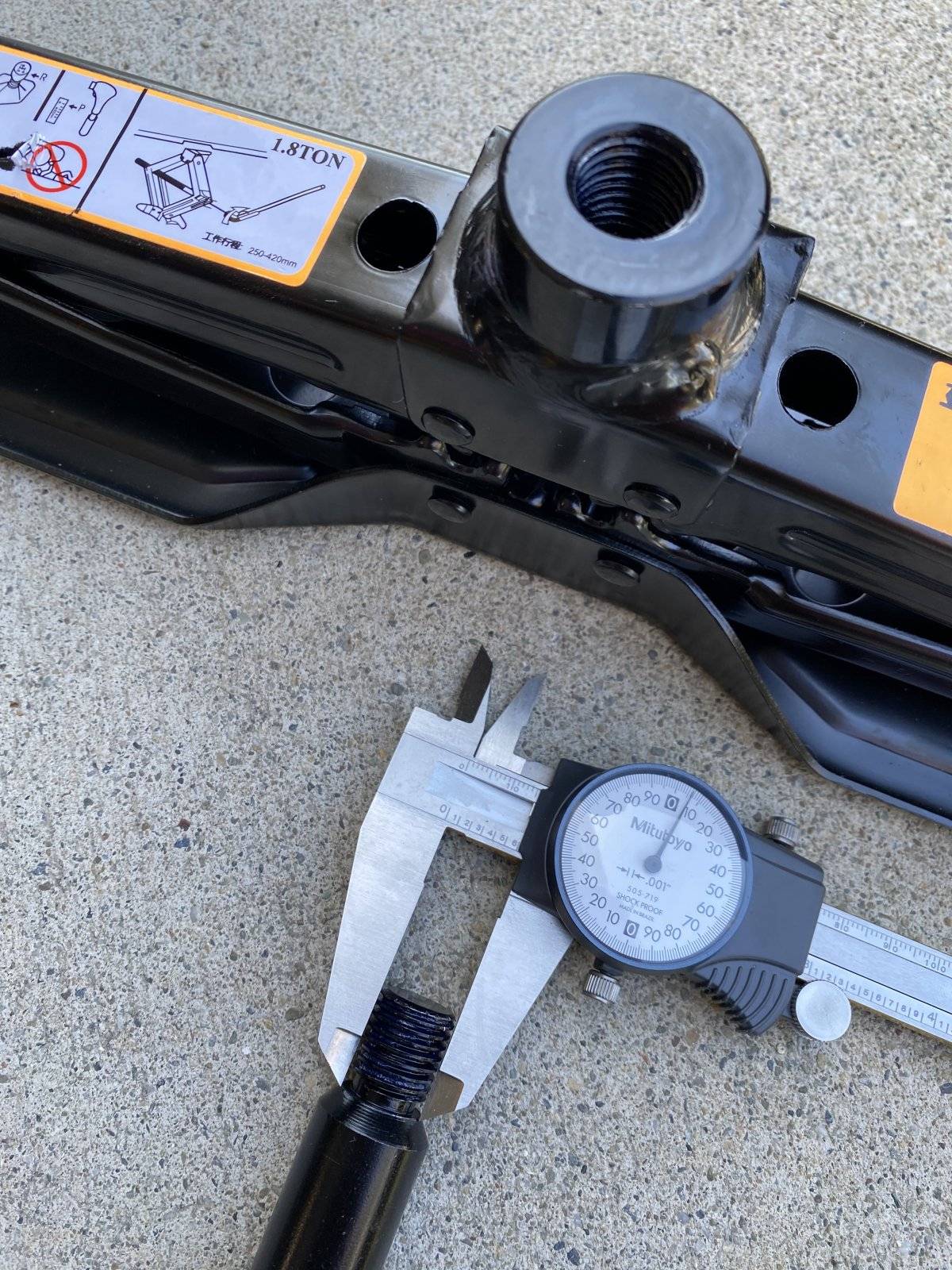

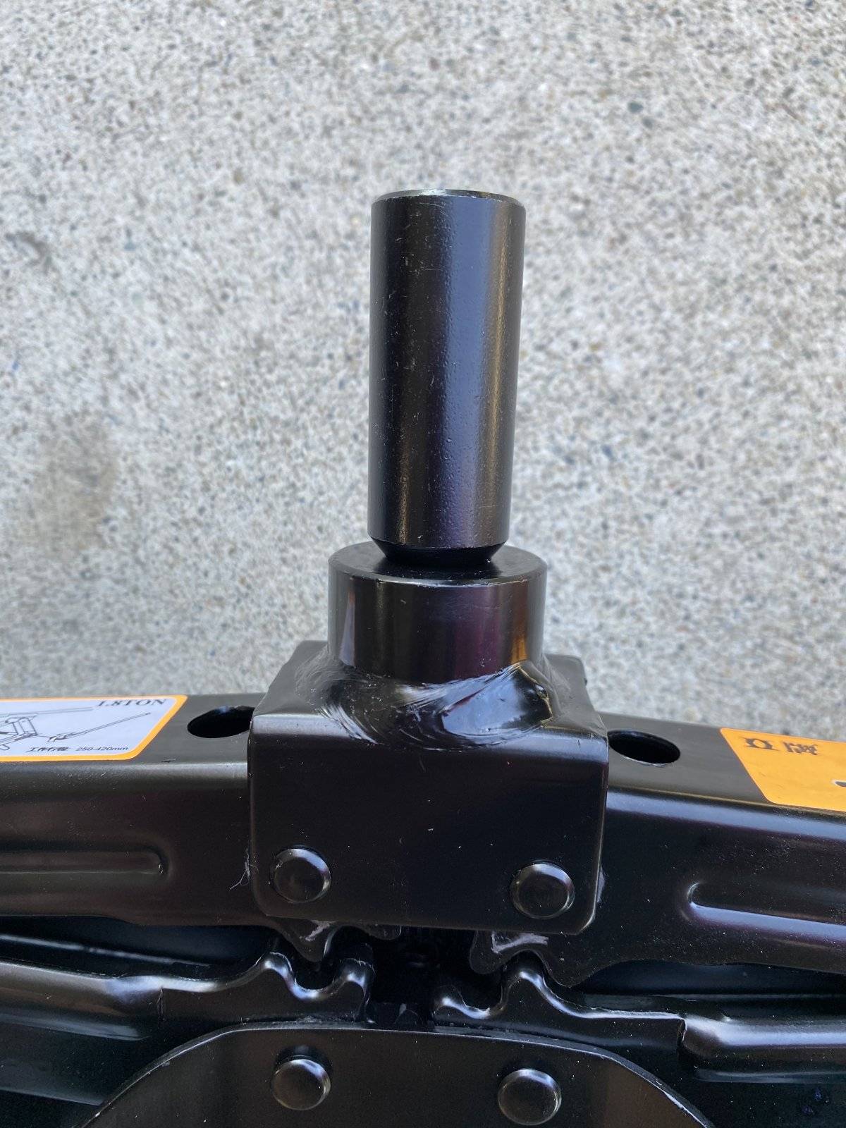

While I am enamored with this jack solution I do have a small concern. Since it is rare that you actually use a jack in a perfectly flat environment I am concerned that the screw in pin may shear/break off if there is the slightest angle and too much pressure.
Oncorhynchus
Oncorhynchus
Moishe
Aug 30, 2020
56
817
1,150
San Jose, CA
2018 JLU Sahara Sting Gray 3.6L

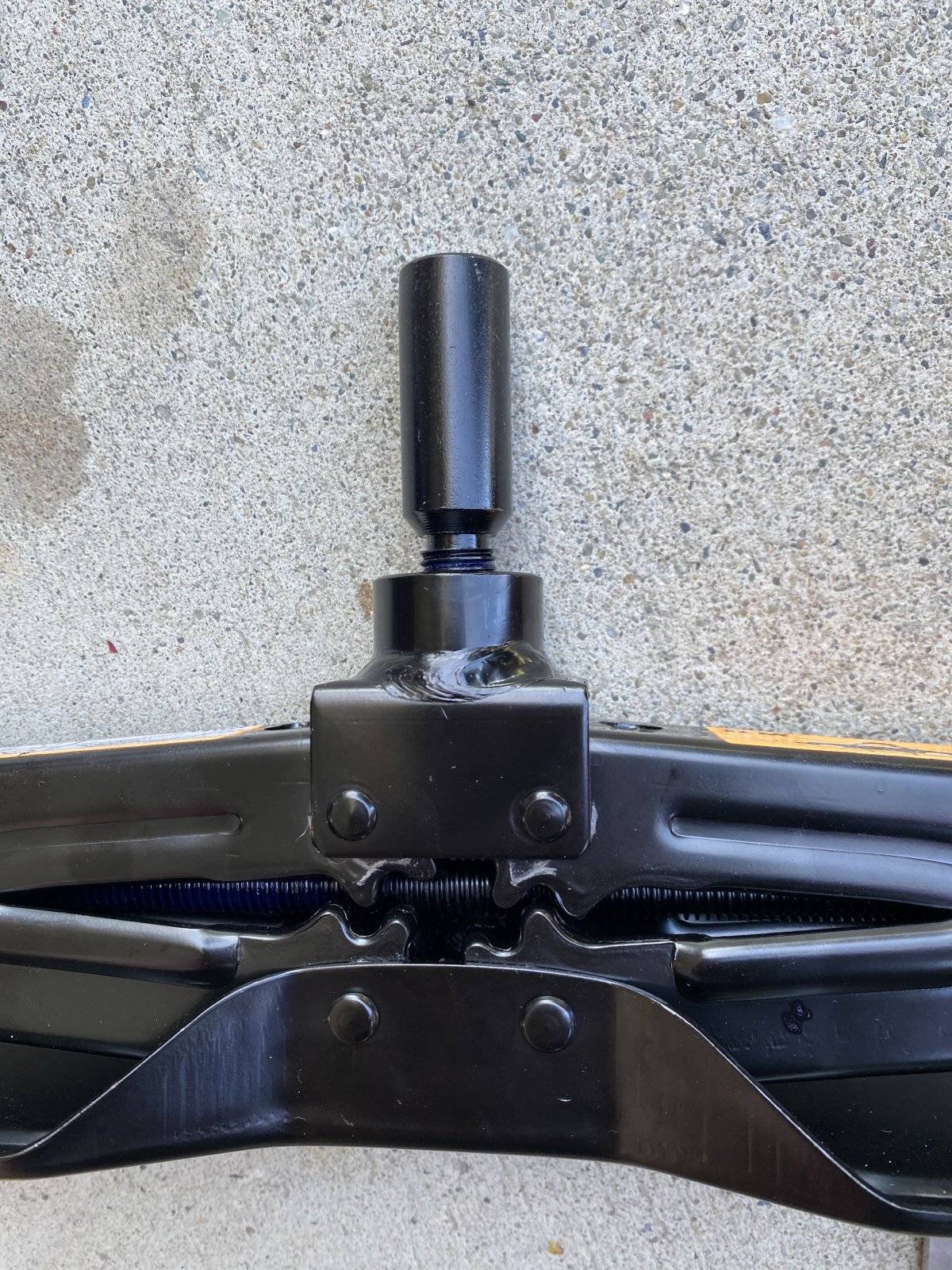

A valid point of concern. Here is a close up look at the parts. The OD of the threaded portion is 0.6 inches and the length is 0.65”. If the jack is not on level ground then yes there will be a torque on this threaded piece. However the threaded pin portion alone will not bear the entire load. The tapered section seats in place when you screw the piece all the way into the base which is made of a stout piece of steel welded onto the jack. If the piece is not threaded all the way into the base then the pin could become more vulnerable to exceptional stress when jacking on a non-level surface.
Time will tell. Or someone on the forum with FEA software who can do a quick stress simulation.

I like like this as an alternative to a high lift or bottle jack. However, with a 2inch lift and 37’s 17 inches just gets me to the frame. I am curious how high this set up will go. I would assume there is another 5+ inches left. Thanks for sharing

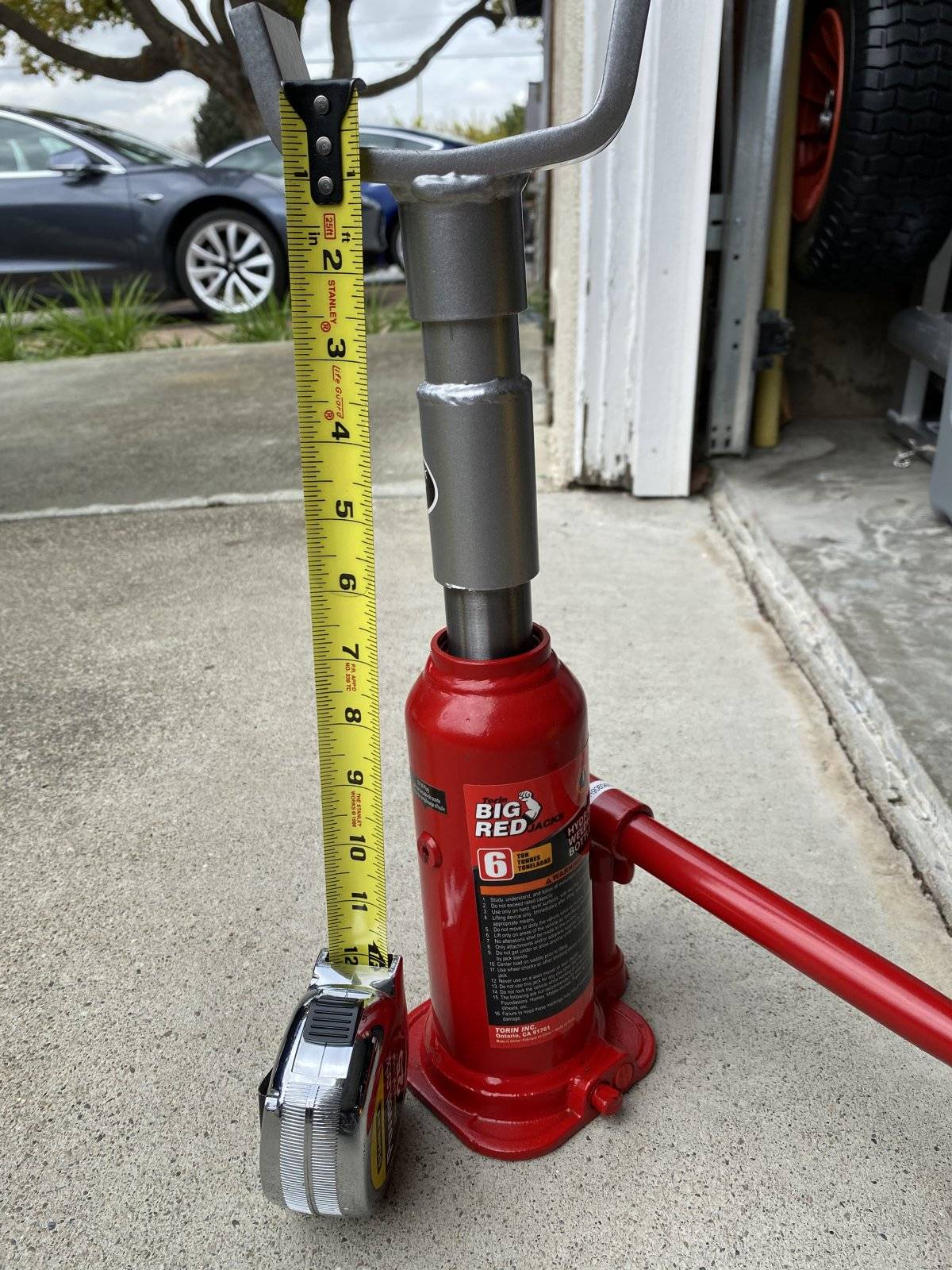

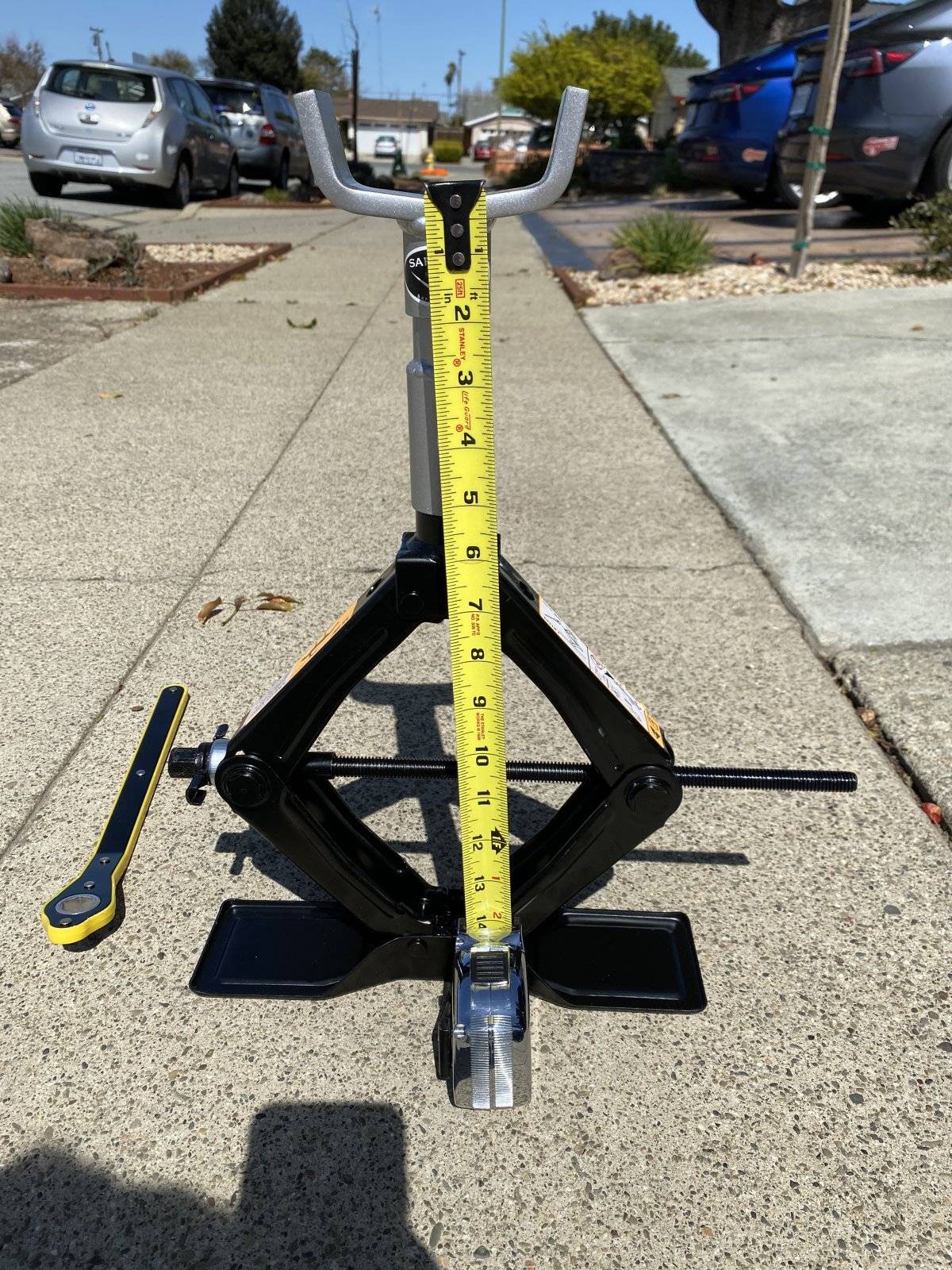

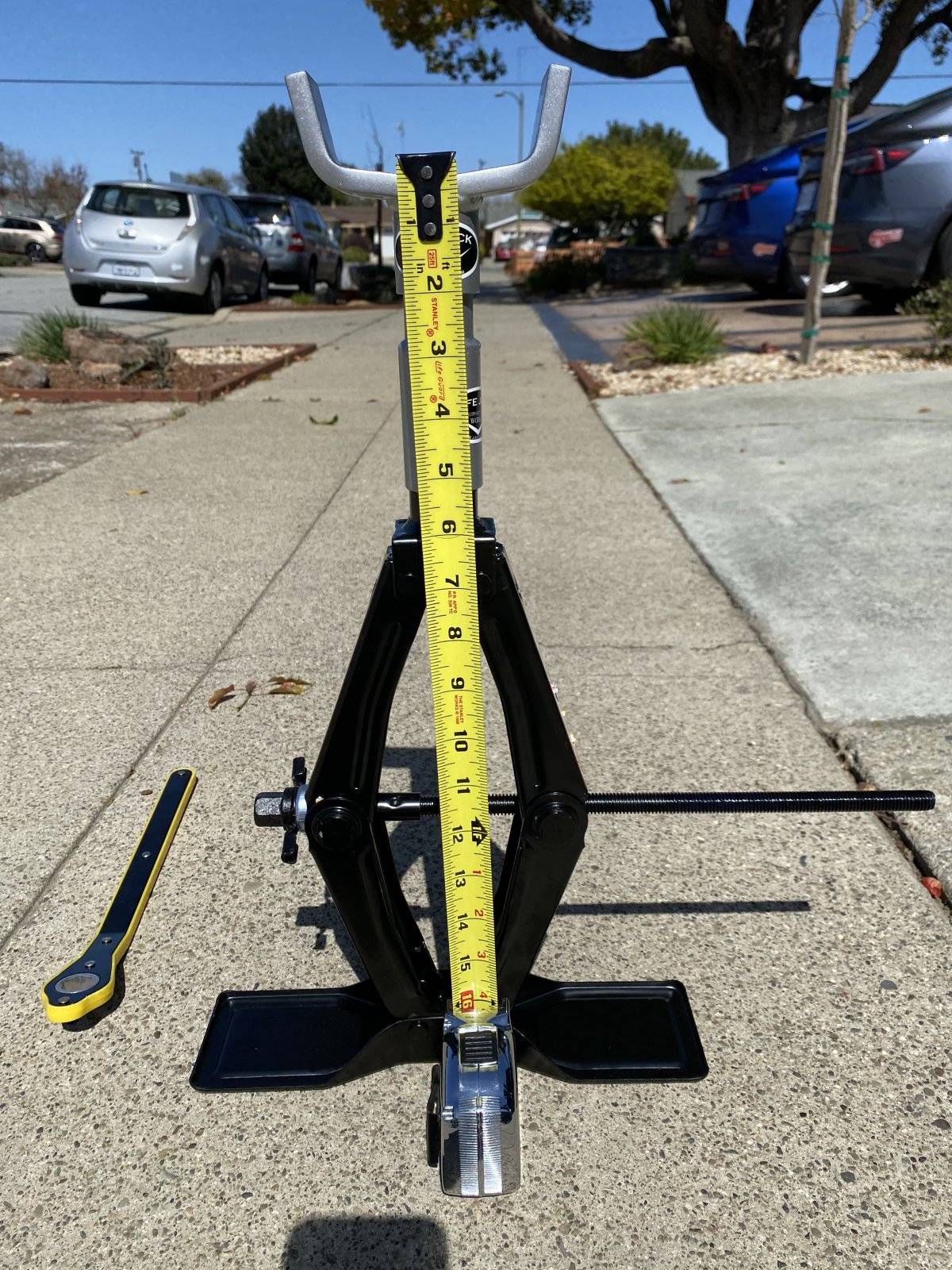

Here are two photos. One at 17” and one at 19” extension from the ground to the cradle of the Safe Jack adapter. At 19” extension the jack is getting close to its limit.
The Torin 6 ton bottle jack has a maximum lift of 16” which is about the same as this scissor jack. Unlike a scissor mechanism however a hydraulic mechanism has the same mechanical advantage throughout its entire range of motion.

Correct me if I'm wrong, but it looks like you have the cradle and the extension thing. Can you use just the bottle and the cradle without the extension?
Oncorhynchus
Oncorhynchus
Moishe
Aug 30, 2020
56
817
1,150
San Jose, CA
I’d be close to the limit of the jack’s range without the extension piece.
