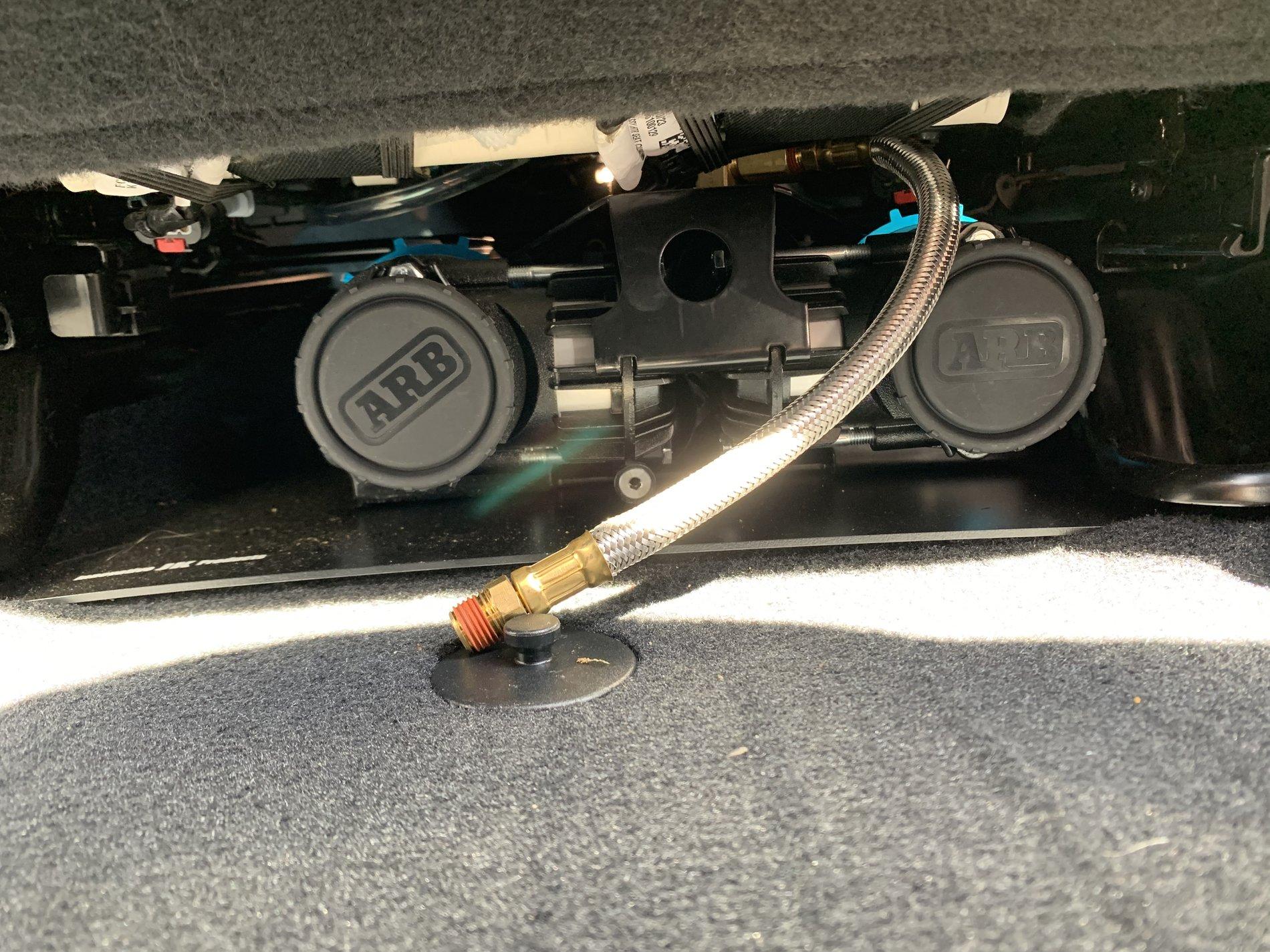

Mine is under the passenger seat. Bracket works like a charm. I believe it’s a JK modified bracket. Jesse at OC Motorsports did the install. Compressor is completely out of the way. Also got a 4-tire inflation kit. Amazing!
@chevymitchell installed mine. I’m pretty sure he said he ran the wiring to the drivers side firewall and through. Maybe he will chime in to give the details.

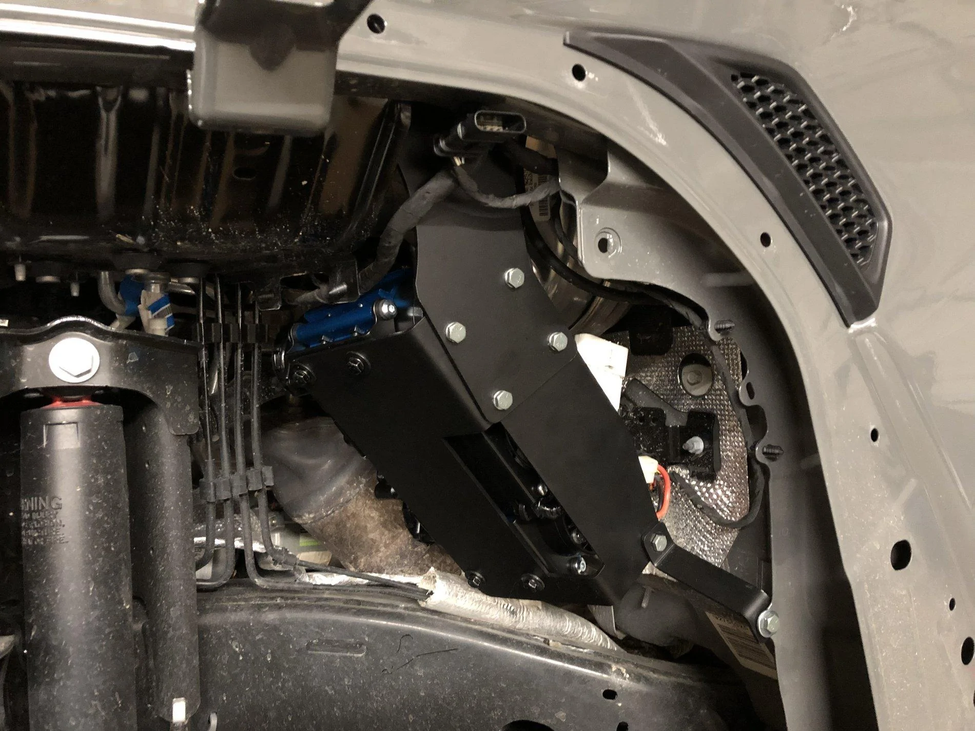

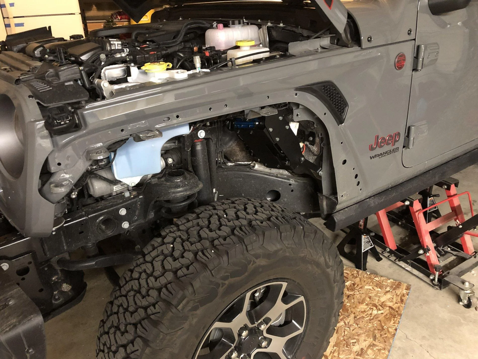

I installed the bracket @kanascoast developed, I’m pleased with the result. Installation was very simple; if you remove the fender first you’ll have plenty of room to work in there.
For removing the fender, I followed these instructions (leaving the fender liner attached):
Here’s a couple pictures after bolting the compressor in and before reinstalling the fender...
This is a terrible location. The compressor is not water proof AT ALL and will get destroyed.

there are reasons why Jeep's put heat shields there...

It’s a really tight fit but I don’t think there will be any issue.

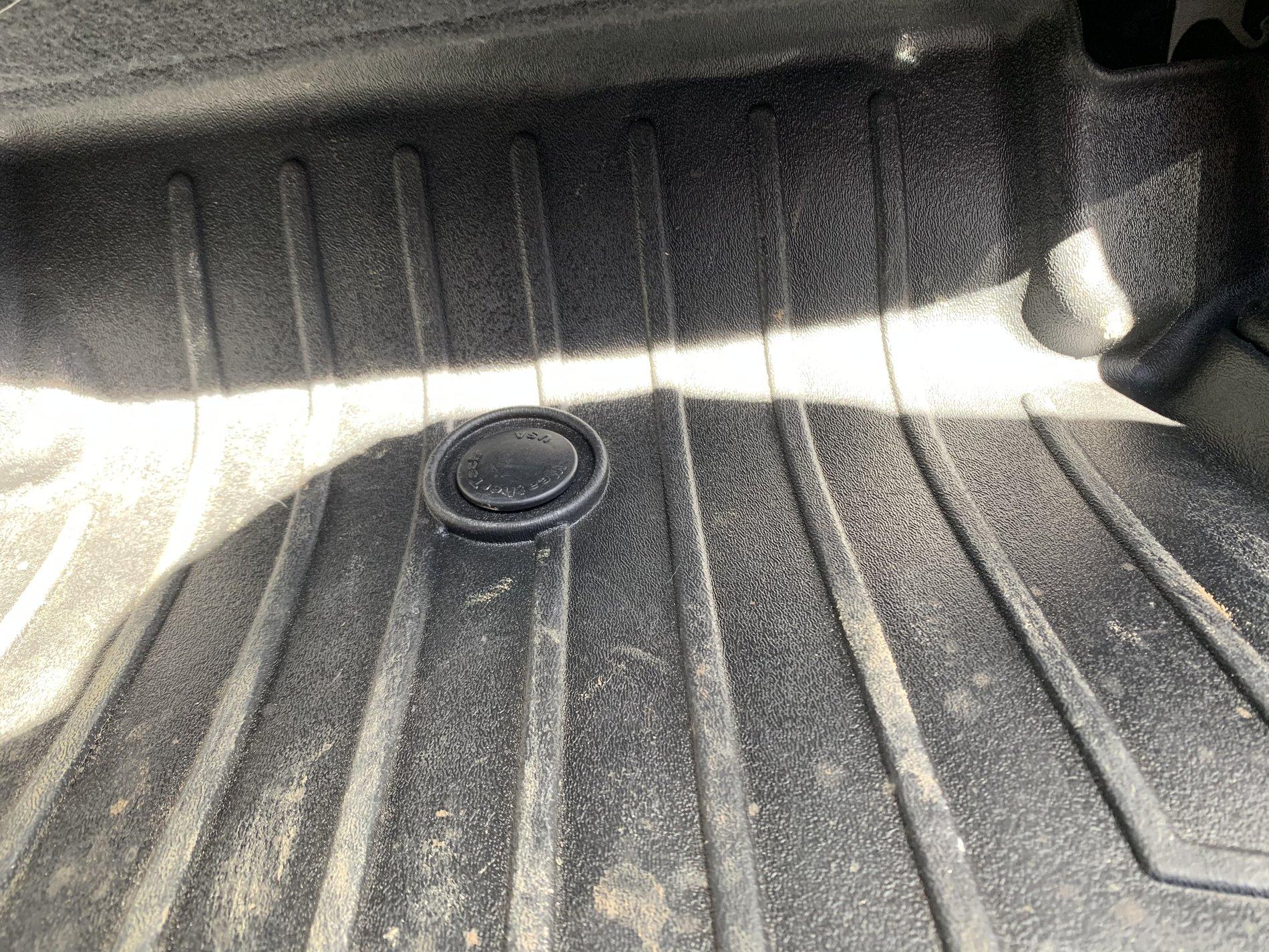

I’ve got the WeatherTech rear floor mat. The ARB prevents the mat from laying flat. The mat could be trimmed to fit but I’ve got 3 young children and I actually like that it provides some protection for the compressor, so I have just left it as is.
When I run the compressor, I’ll unhook the mat from the passenger side and lay it over until it cools off.
Any idea what the clear tubing under the seats is? I noticed it while hunting a petrified french fry and you can see it in your picture, my first thought was "man this thing has an aquarium, those fish are sooo dead by now".
