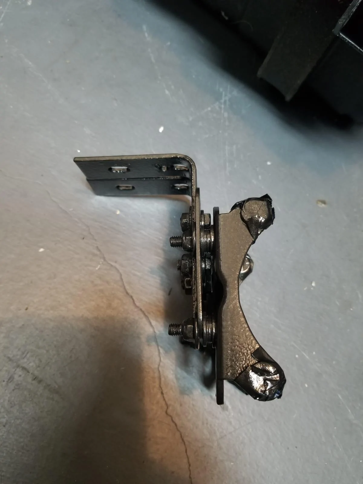

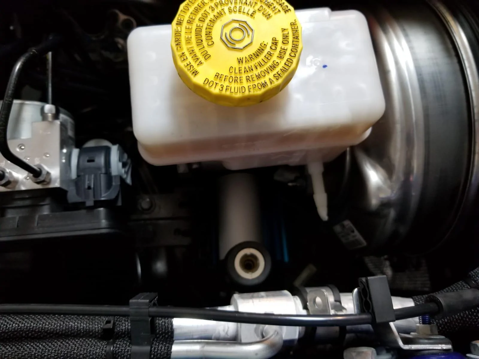

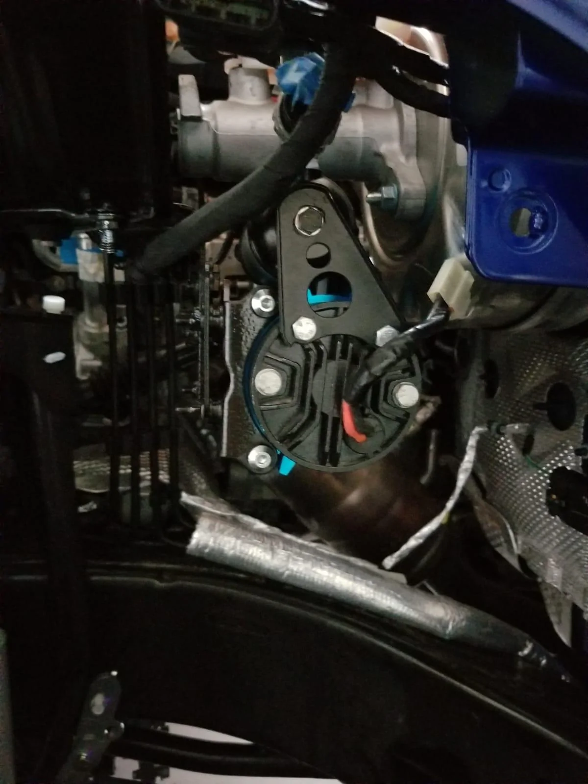

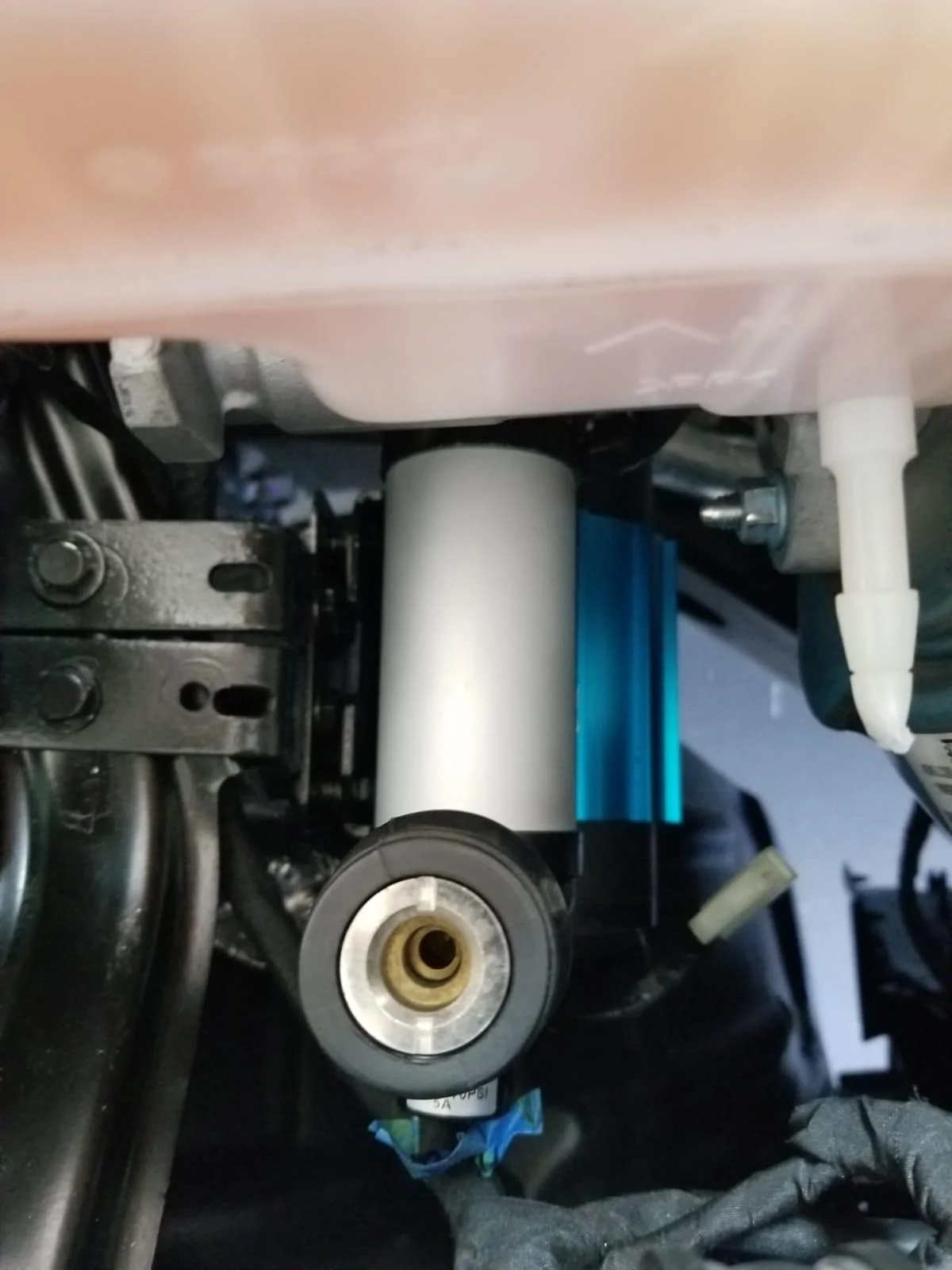

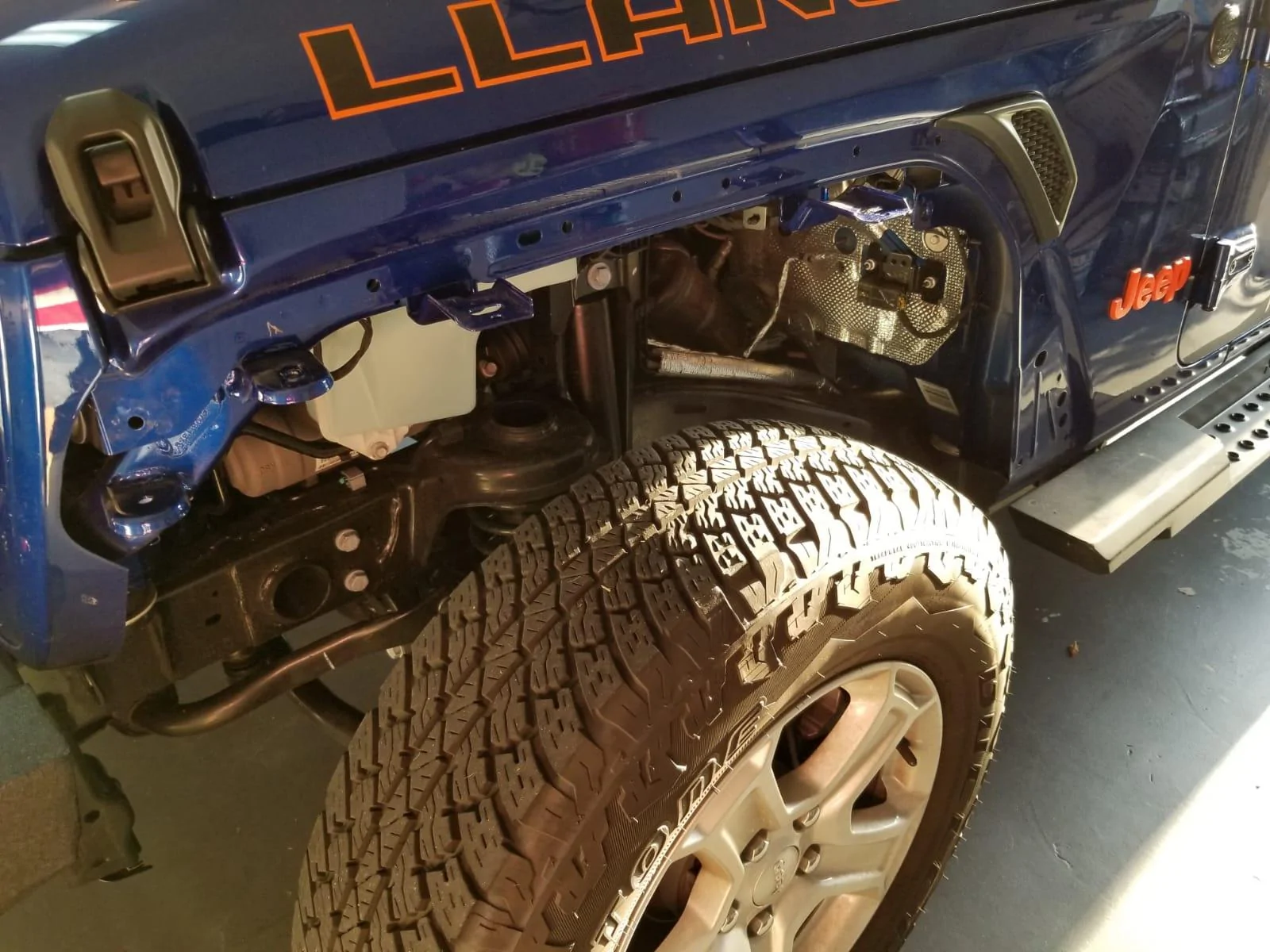

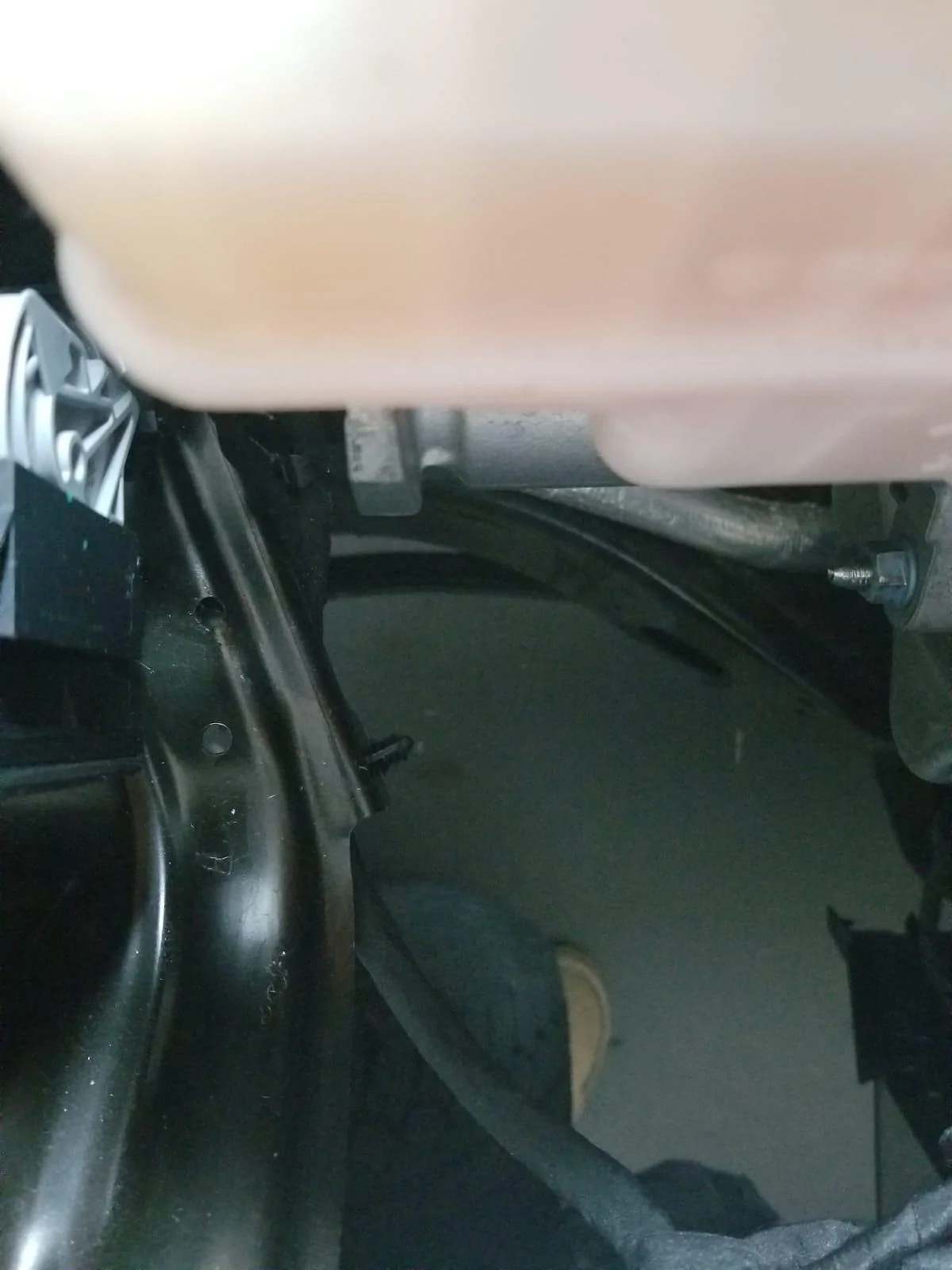

This is how I mounted mine. All you need is an L shaped bracket. Pics are with a temporary bracket I made, then I had a machine shop make a permanent one.
Jeep Wrangler JL Mounting ARB Air Compressor IMG-20181102-WA0011
Jeep Wrangler JL Mounting ARB Air Compressor IMG-20181102-WA0009
Jeep Wrangler JL Mounting ARB Air Compressor IMG-20181102-WA0007
Jeep Wrangler JL Mounting ARB Air Compressor IMG-20181102-WA0008
Jeep Wrangler JL Mounting ARB Air Compressor IMG-20181102-WA0005
Jeep Wrangler JL Mounting ARB Air Compressor IMG-20181102-WA0006

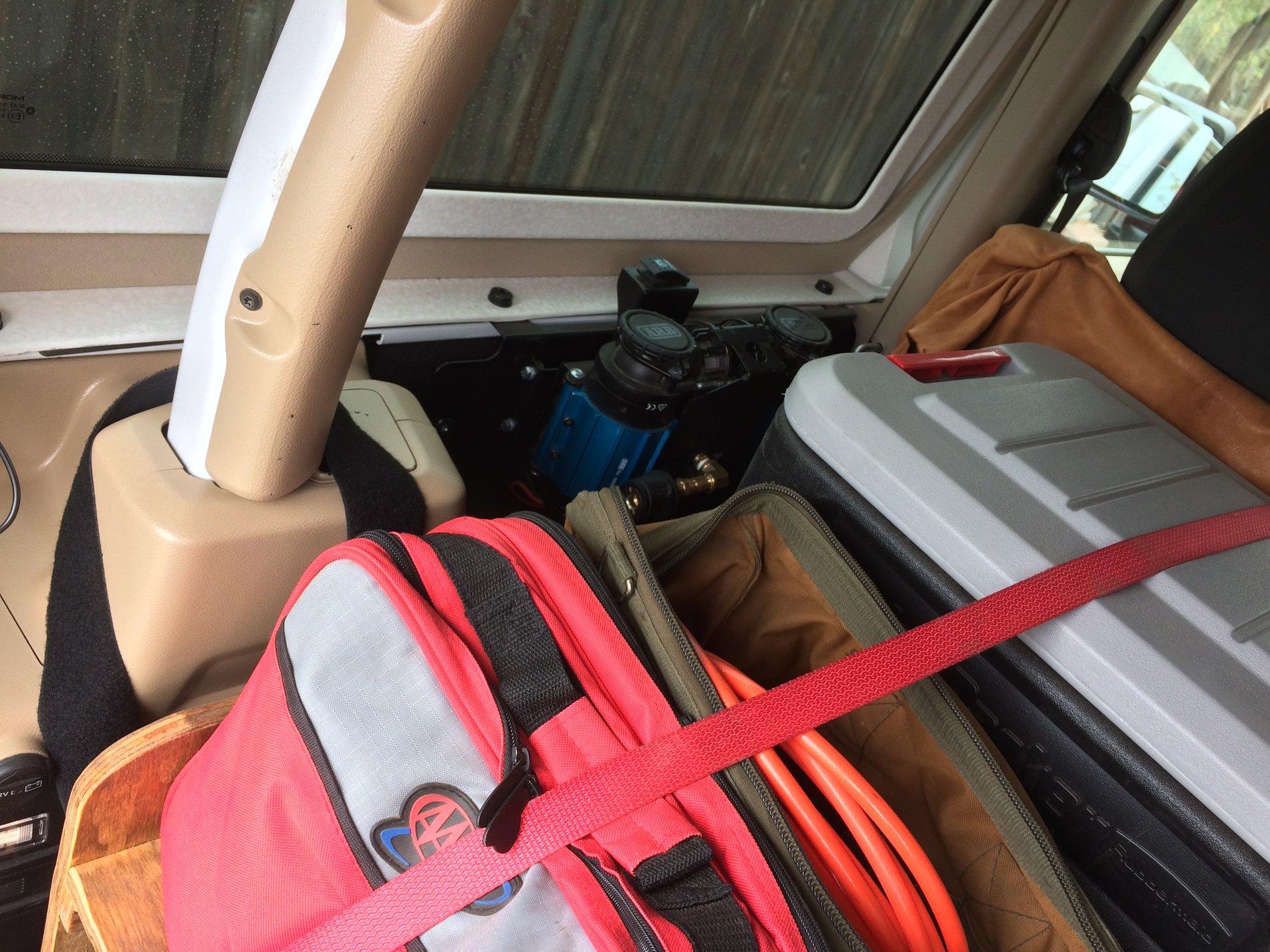

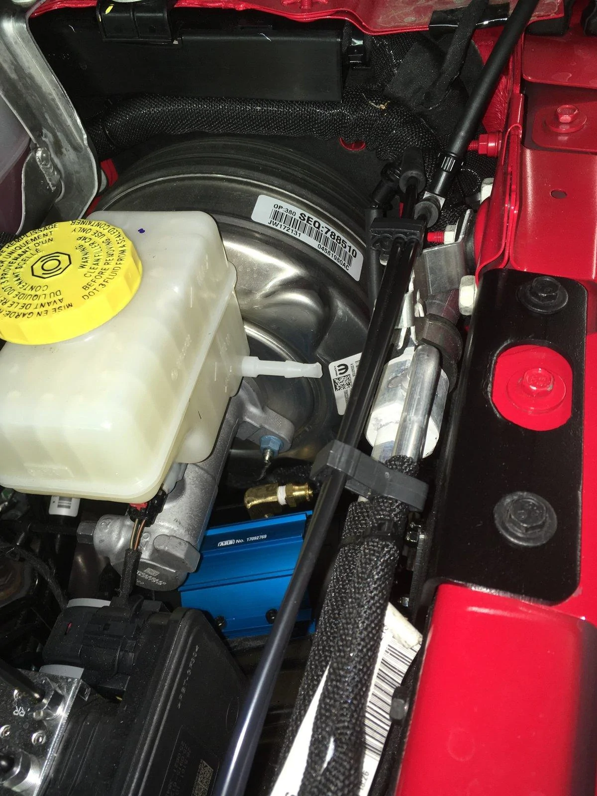

I had my ARB twin under hood. Had an air leak while at E.J.S. Moab and was happy to find ARB had a couple techs in town. They sourced the leak, hose fitting elbow on ARB. Problem was, nobody could get a wrench on it without unit removal. Neither they or I was going there, in the parking lot @ E.J.S. But, If that wasn't bad enough. Both techs said, "that was a bad location because it preheated(heat soaked)the compressor". They both said the ARB is a tuff little unit but that was a bad environment. I mentioned 3 inside locations I new about to them and a sales rep. They all said the M.O.R.E. location was the most preferred because of air flow. That is were my ARB is now, damn things are too expensive to install in a less than ideal location.
