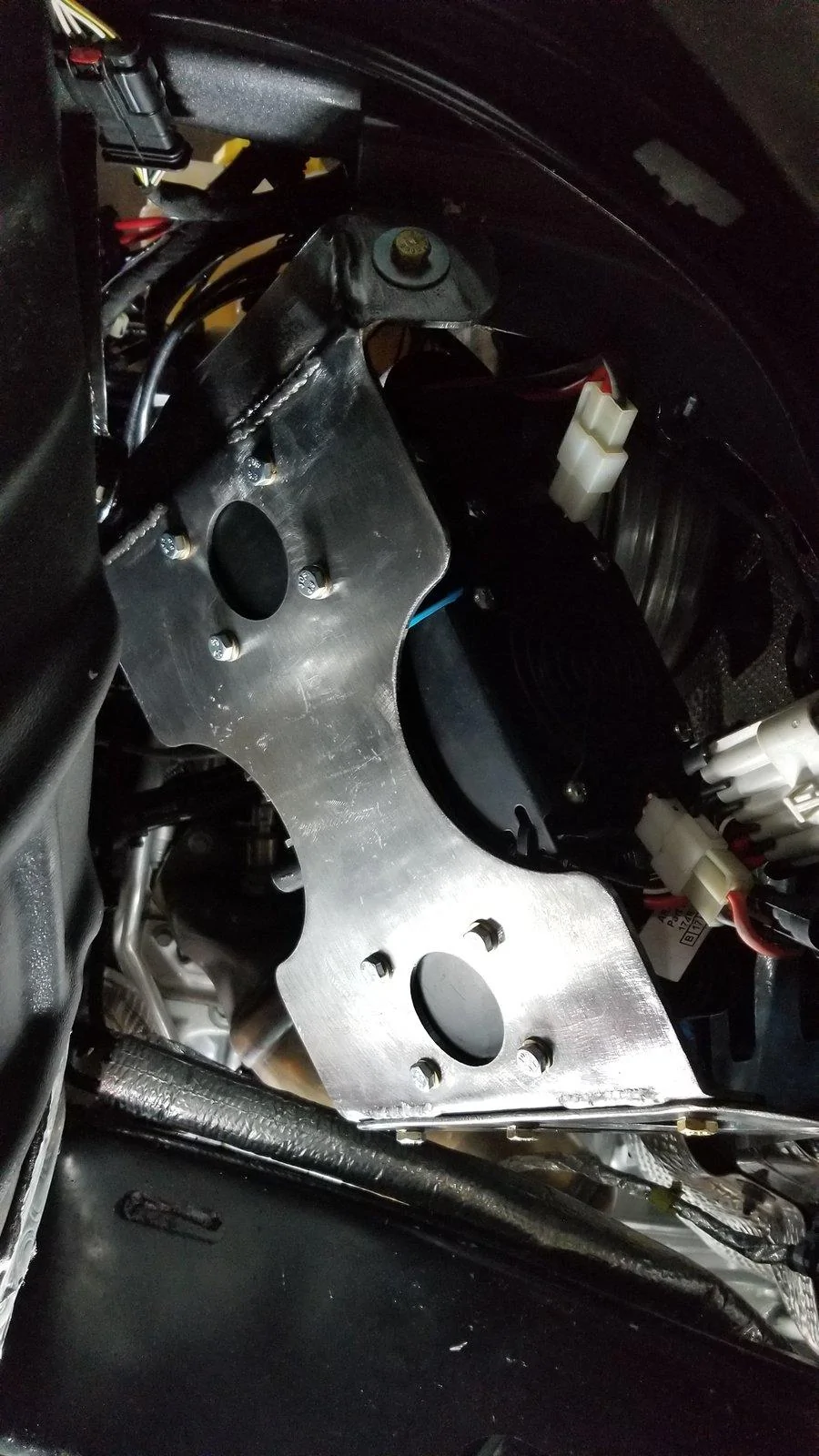

It will be interesting to see how the ARB compressor holds up to the high temps under the hood...but since its really the only good option for a spot on these rigs, I'm hoping that compressor is very heat durable. Any know of any issues yet on the JK's that mounted these under hood?
We shall see. I do not think this is any different than what was mounted into the JK's. I would also like to hear if they help up in the JK's.
I did mount one and for me it really is the best location, hands down. For as little as I will use it to have that big ugly thing in the back on the side or taking up the back storage spot, this was a chance I was willing to try.
I did however upgrade my air line as first time out the plastic air line could not handle the heat. It appears the new stainless steel/teflon line will do the trick.

Has anyone been able to successfully mount under the passenger seat?

Two problems mounting under the seat with the JL are 1) there isn't really enough room 2) there is an hvac duct right where you might want to mount it.

I have the underseat mount. It is a great solution. Very pleased with it. System works great

I too have a underhood mounting option same location different design different mounting, allready in a plasma cam, and working on a press jig.

I have an ARB Dual Compressor, I am curious how people are mounting it in a JL?
<EDITED WITH UPDATED THREAD INFO>
MORE bracket
Con: I am not that happy about the spot for when I have the hard top off...
https://www.mountainoffroad.com/jeep-jl/jl-accessories/air-compressors/815572023674.html
Up Down Air skid mount
Con: Mounts low and ARB compressor cannot handle being submerged in water
