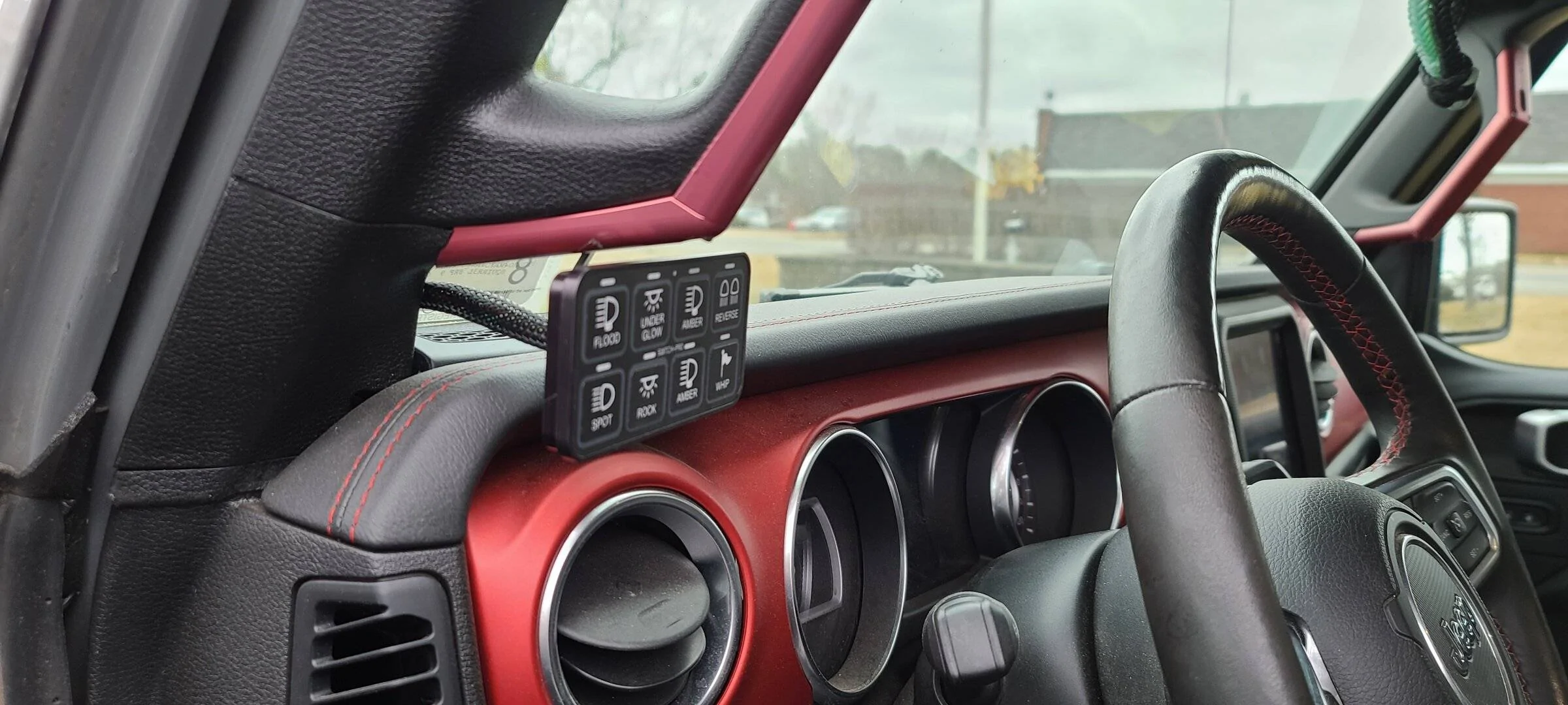

If there was an "elegant" way to have more aux switches, I might consider it. I really don't like the switch pod look, or a bank of non-factory stuff on my dash.
Feel the same way, but I feel like 4 just isn't enough and I haven't used one yet! Only hardwired my GMRS radio direct to battery from the passenger footwell.
Not to derail the thread, but I think you can get creative with a switch pros panel, 67 designs holder, 67d arm, and a CMM A-pillar mount for a relatively clean look. Not factory, but about the cleanest option I could come up with off the top of my head and you could move/remove it later and nobody would know it was there.
SwitchPros SP9100 system and their direct bolt on and easily reversible grab handle mount, which doesn't at all impede the use of the handle or any other factory controls.
Because of my aftermarket handle cover, I couldn't use the SwitchPros lower handle bezel that provides a pass through for the communication cable closer to the switch panel. Otherwise, the location of the panel is unchanged.

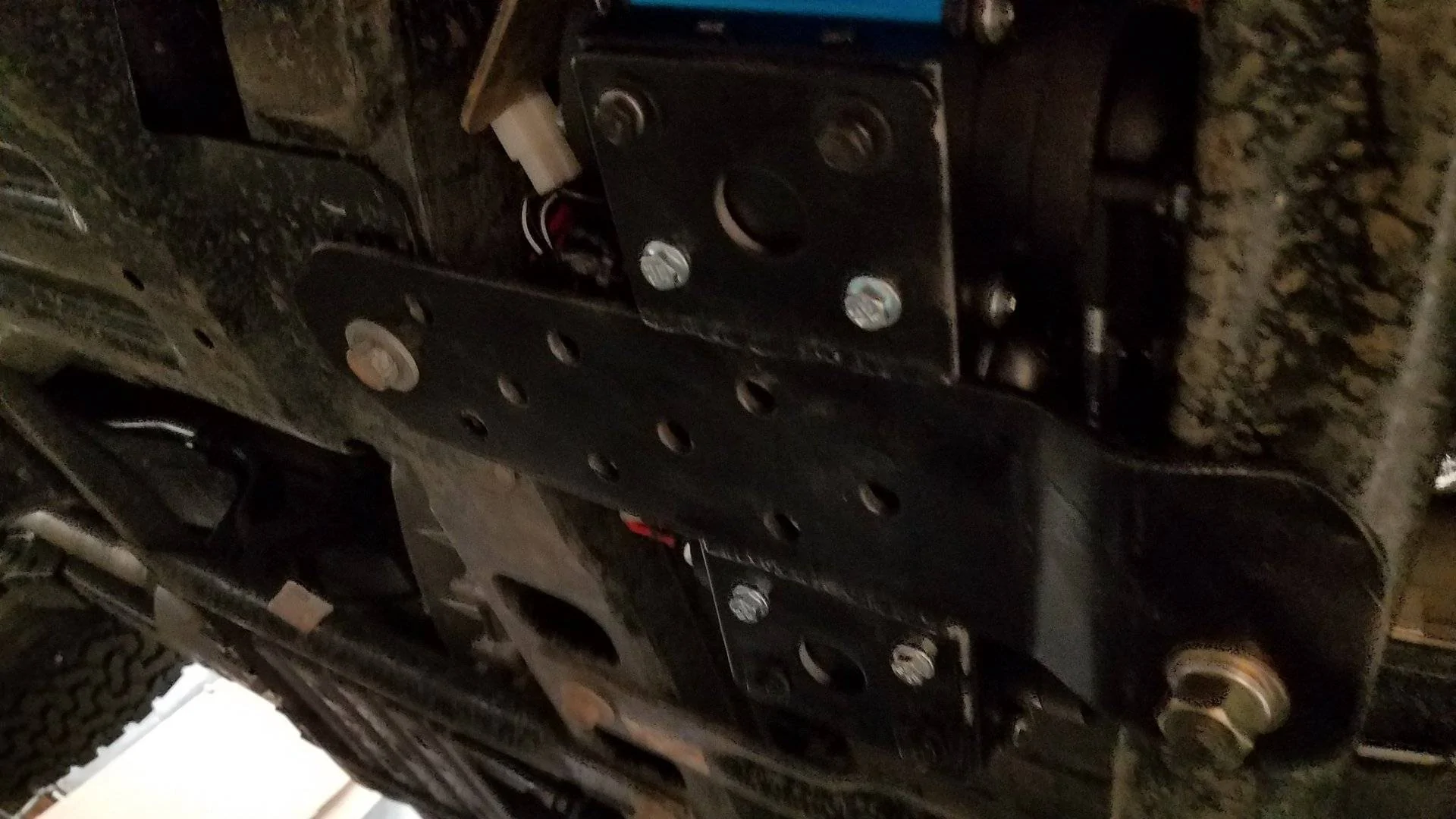

It has been done...but here is mine:
Parts laid out-
Jeep Wrangler JL Mounting ARB Air Compressor 20220304_142427-
Installed under the Jeep passenger side next to the tranny...used fuel skid plate bolt at the rear and utilized existing hole in the cross member under the tranny oil pan-
Jeep Wrangler JL Mounting ARB Air Compressor 20220408_155729-jpg
Hoses installed...insulated them re exhaust pipe nearby.
Jeep Wrangler JL Mounting ARB Air Compressor 20220408_155757-
Air filters installed next to the fuse box using existing hold down bolt in the cowl.
Jeep Wrangler JL Mounting ARB Air Compressor 20220408_155459-
Driver side switch and female quick coupler for air tap.
Jeep Wrangler JL Mounting ARB Air Compressor 20220408_155430-

Did you reference the ARB manual that gave the specs for extending the air filters and the hose size required for given lengths? You might be starving it for air.
Good point...I used 3/8" hose which is a bit on the small side for about 3' of hose length where the installation guide calls for .47"...I could not justify that size hose when I saw the 1/4 pipe threads on the twin intakes anyway...I'll revisit that as time goes on and I use it and track the heat signature on the cylinders...maybe I'll install 1/2" hose on one side and compare the temps.
Definitely go up to the 1/2" hose size. :like:
That's what the ARB engineer recommended to us when we were designing the Grimm twin compressor kit.
Thank you Tim, I'll do it.
