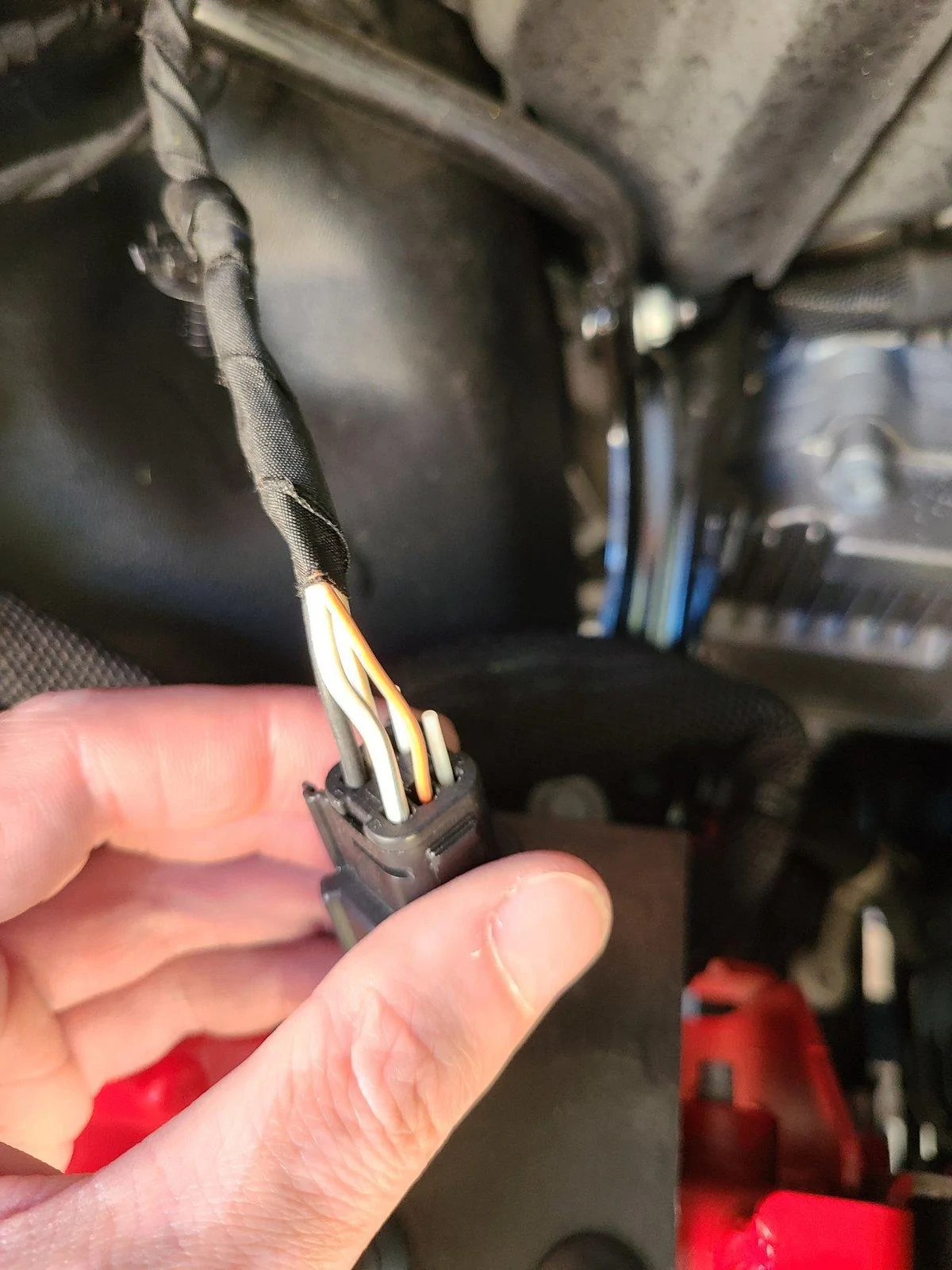

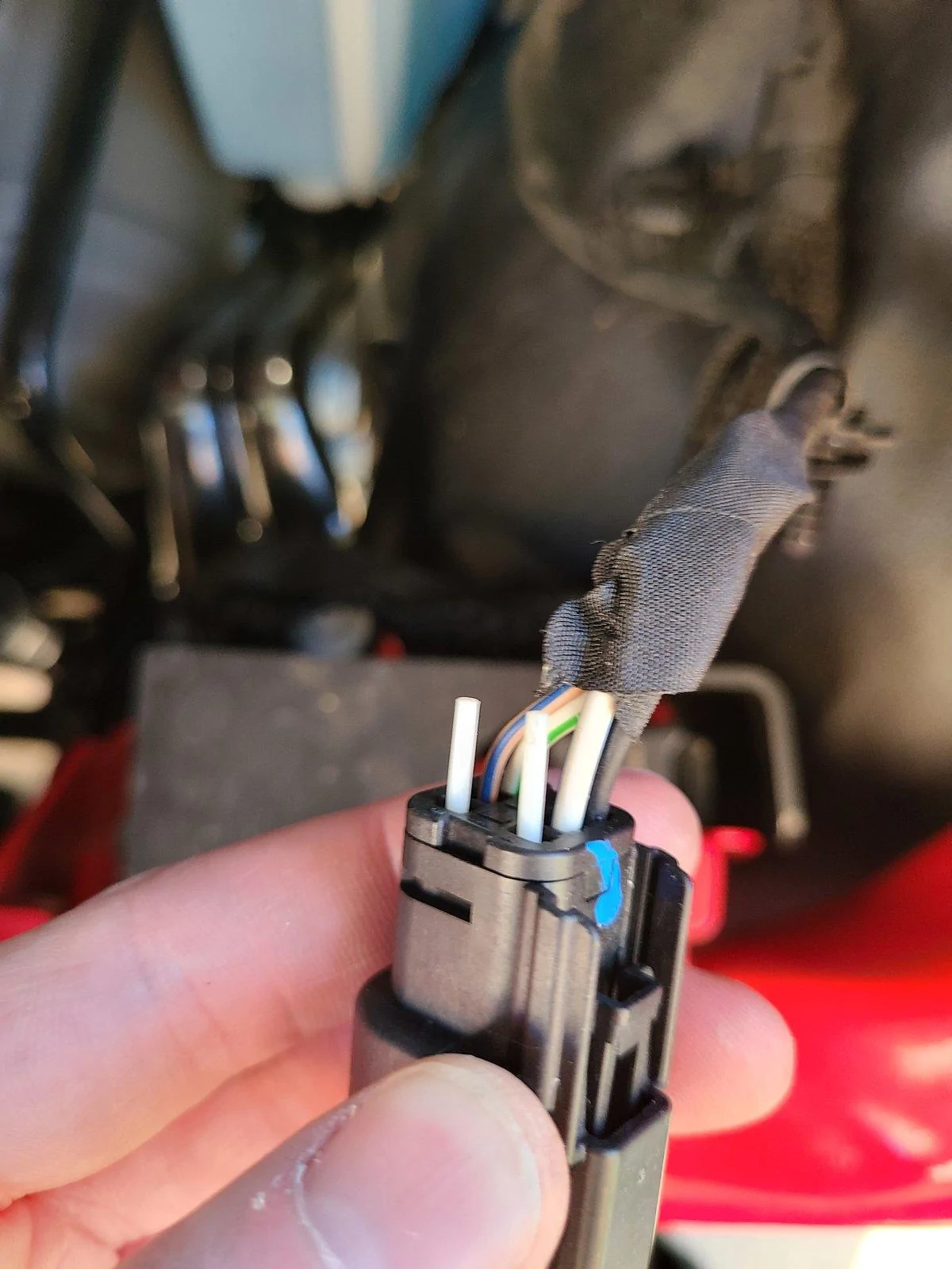

I did the install. I actually wasted my time running the supplied wiring harness for the Mopar LED headlights to find out after that my 2020 came with the wiring. It goes into a different pin configuration than the 5+7 cavities though. From what I've been told the headlights are completely separate than the LED parking lamps/turn signals.
It doesnt make much sense for me to be getting a turn signal out light unless the system is programmed for the LED parking lamps, and there clearly isn't any power going into the cavities for the LED parking lamp inputs.
So pro tip. Check to see if the extra wires are there before ripping off the fender. Doing mine today. lol
If the provided wires are there the headlight install is a breeze.
My extra wire was there... Just plug and play, shes at the dealer now getting a new steering box and a flash... I'll let yall know...
