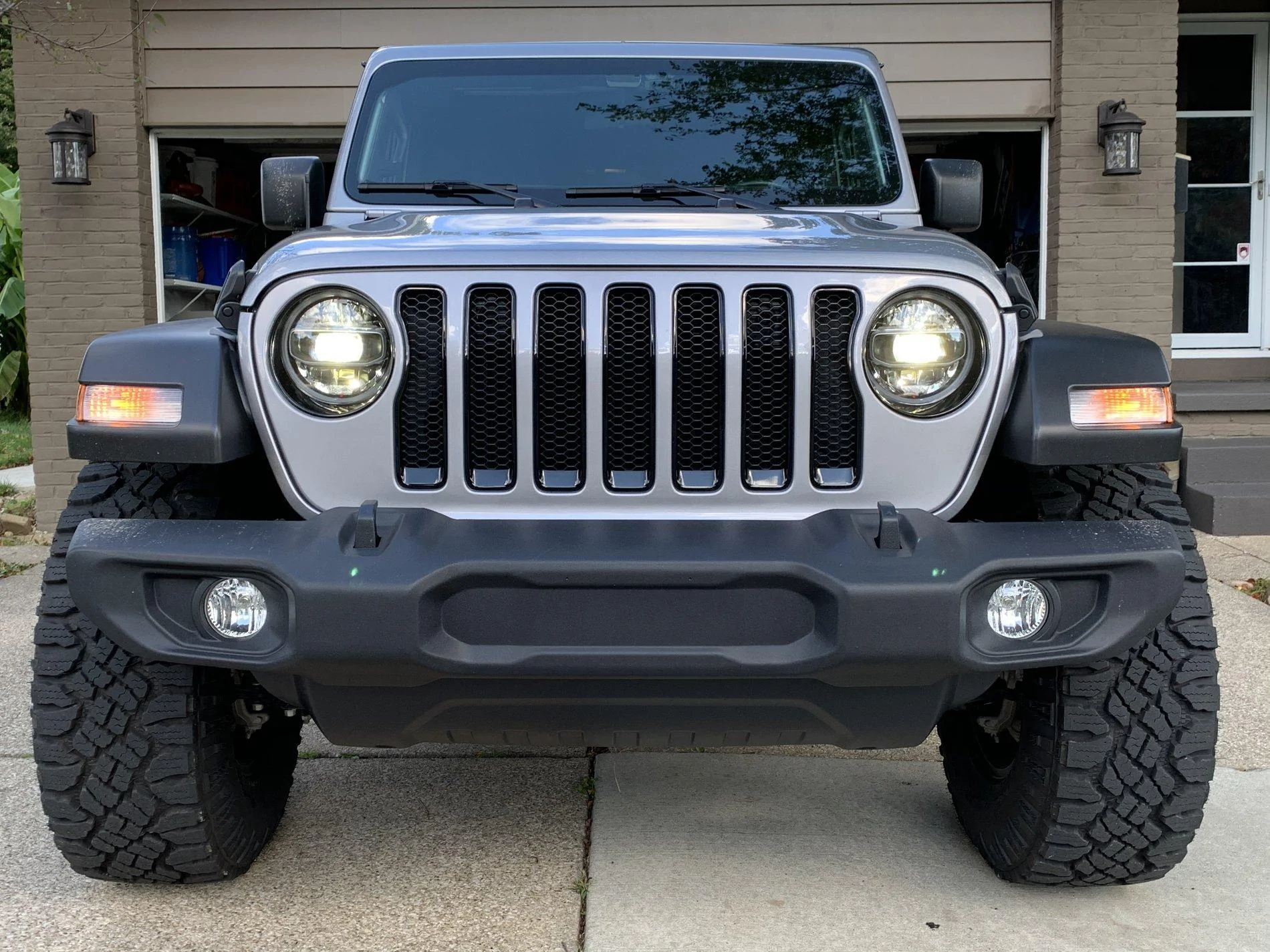

Can someone please validate the following three questions:
1. Can the OEM LED Headlamp replace the OEM Halogen Headlamp by simply connecting the existing plug? <Yes/No>
2. The above is "plug and play", halos will not work, low and high beams will work immediately without the need for a flash or Taser? <Yes/No>
3. Making the halos operational requires two things: a. Wiring harness Part# 68347117AB, and b. a dealer flash or taser? <Yes/No>
Yes, the plugs are identical, though you may be missing a wire in the jeep's harness that supplies power to the halos.
Halos will need the wire mentioned abave, as well as a flash to the jeep computer to enable the halos. The headlights themselves may also not work quite right since they require different power requirements from the jeep so you also need a flash to properly get them to work too.
Maybe. Some jeeps do come with the extra wire in the jeep harness, you need to check yours for the spare wire. I believe this is the same for both the JL/JT. If you don't have the spare wire, you need the harness. And yes, you need a dealer flash for the halos.

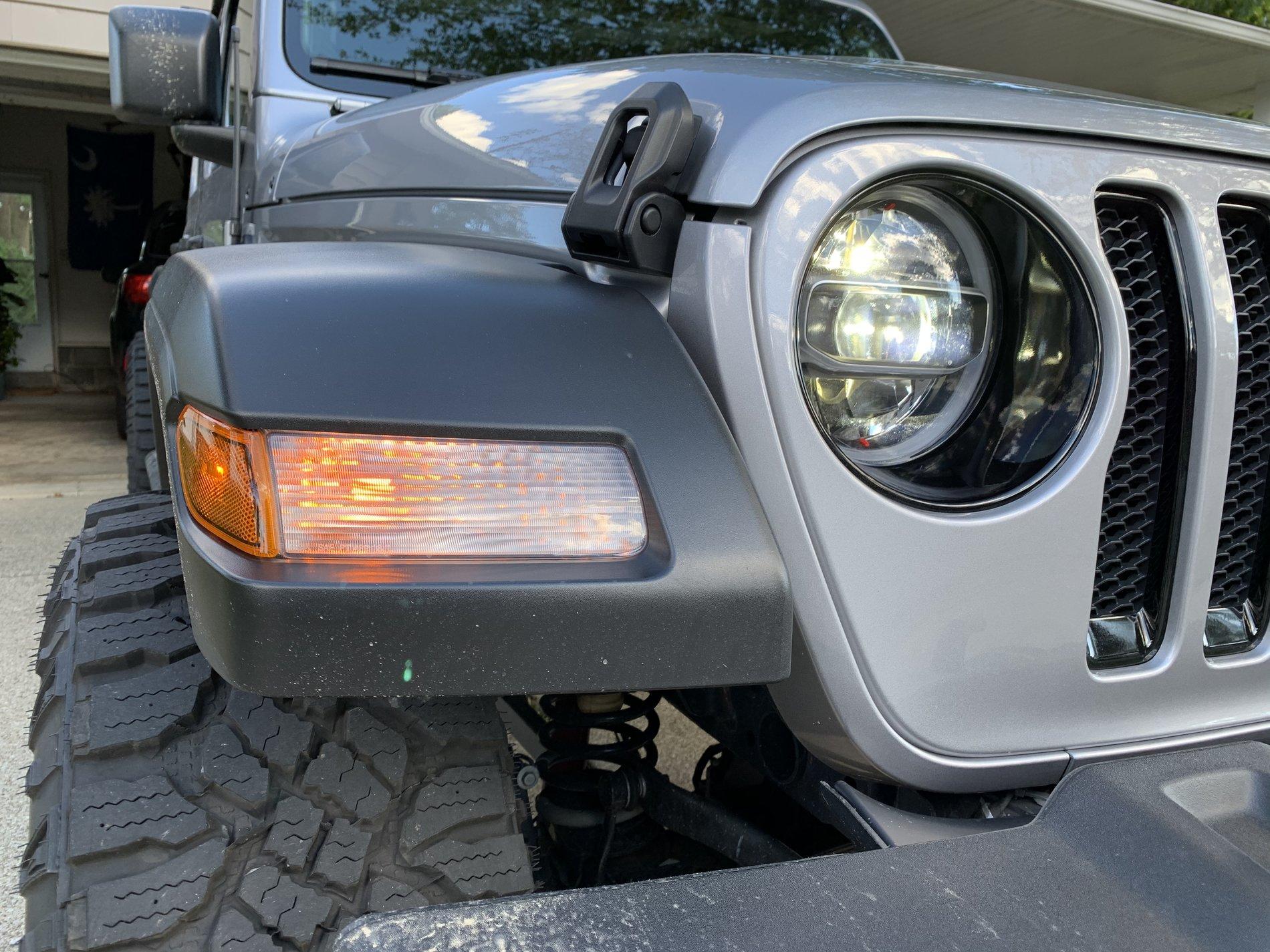

Need your help here. About a month ago I replaced the stock turn signal lights with OEM LED turn signal lights. Immediately I started getting an error message ”Turn Signal Lights Out” in a few seconds after I turned on the car, and then would turn off. After searching this thread for a bit I found the possible solution, the Tazer Mini JL. I bought one and installed it today. It “fixed” that problem, in that it does not come on after a few seconds anymore. Now it comes on EVERY time I use the turn signals, and not just once, constantly every 3 seconds! Any suggestions? Thanks!

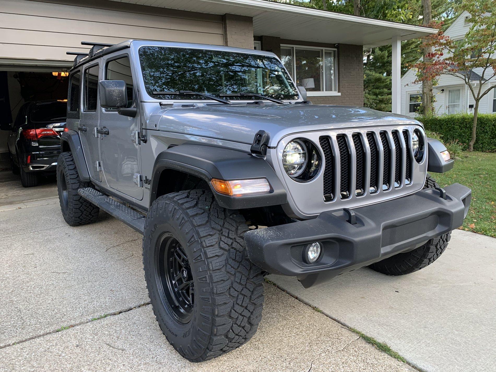

. Got em installed, no flash, low and high beams work perfectly, halos will be wired in the winter or spring.
