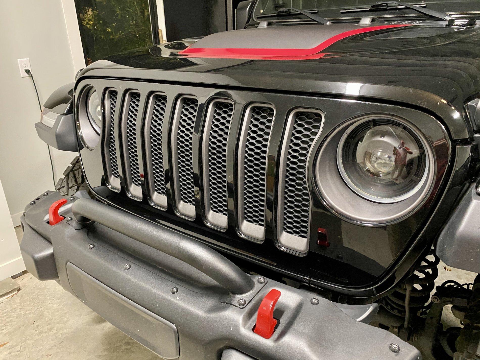

Mopar LEDs installed, had the dealer take care of it and no issues. When I tried myself I had a bunch of issues.
Jeep Wrangler JL MOPAR LED FACTORY UPGRADE KIT E633F68B-BBE1-456C-89BD-AC5296798AB0
Jeep Wrangler JL MOPAR LED FACTORY UPGRADE KIT 58C7D4B1-C8E5-46A6-8785-61FD20E9792E

Thanks, maybe i'll just keep the stock and save myself more $$ and headaches. did the kit come with a connector harness or wires to connect to the connectors? Hate to pay almost $800 bucks and then pay the dealer more to make them work....lol
Yea the kit came with everything needed. If the dealer installs it will be rolled under your factory warranty too, with the extra piece of mind and no headaches with a self install that still required dealer flash to be right. I tried other brands BTW, you’ll find my post here, not a good experience.
