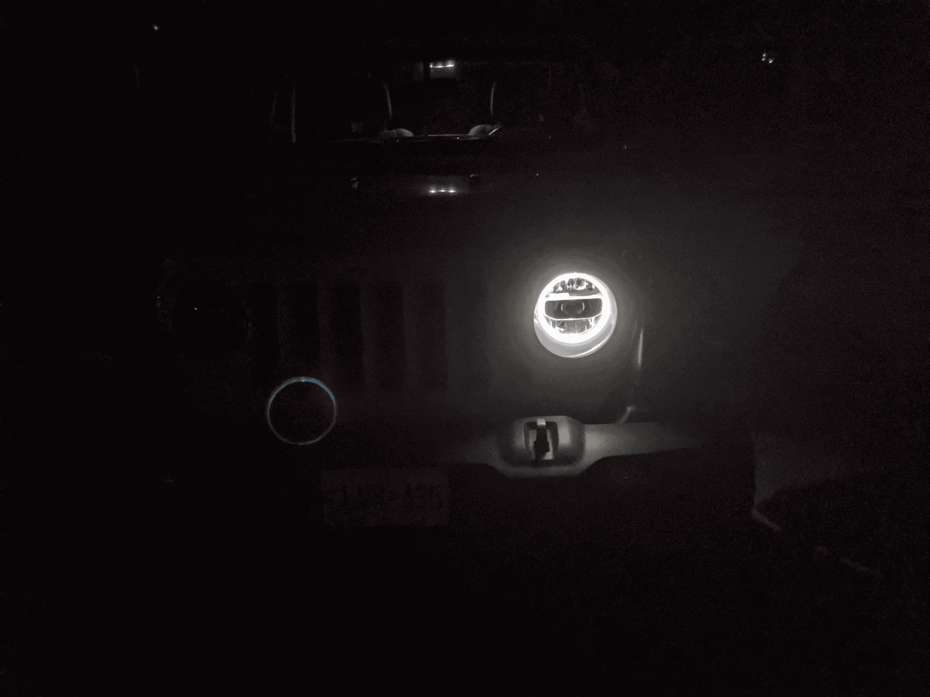

I have this EXACT problem right now. Can you tell me what you did to fix it ?
I've checked the wiring and I've turn halos on and off countless times. Still same problem. They sort of "flicker" when you press the unlock button .
Just FYI.
Basically when I click the "open lock" button on the keyfob, the headlights come on as expected, but the driver side halo is OFF and the passenger one sort of "Flickers".
If I start the car, the drivers side Halo is ON and the passenger one is completely off.
I've turned / cycled / rebooted my Tazer Mini countless times to try to get this to work. I'm using the Mopar "Wiring-Jumper Part #68347117AB" as well as OEM LED Lights hooked in the BCM. I checked the wiring as well as the pins.
If I swap the pins, it does exactly the same thing but swapped, so I don't think it's a wiring issue.
I get the impression that the Tazer doesn't fix this, (and why did I drop $480+ CDN on it if it doesn't!)
This is a Late 2019 Sport.
I ended up connecting both wires to the side that works. It works fine and I've been running it this way for months. No error codes or lights at all. Lights all function as they should.

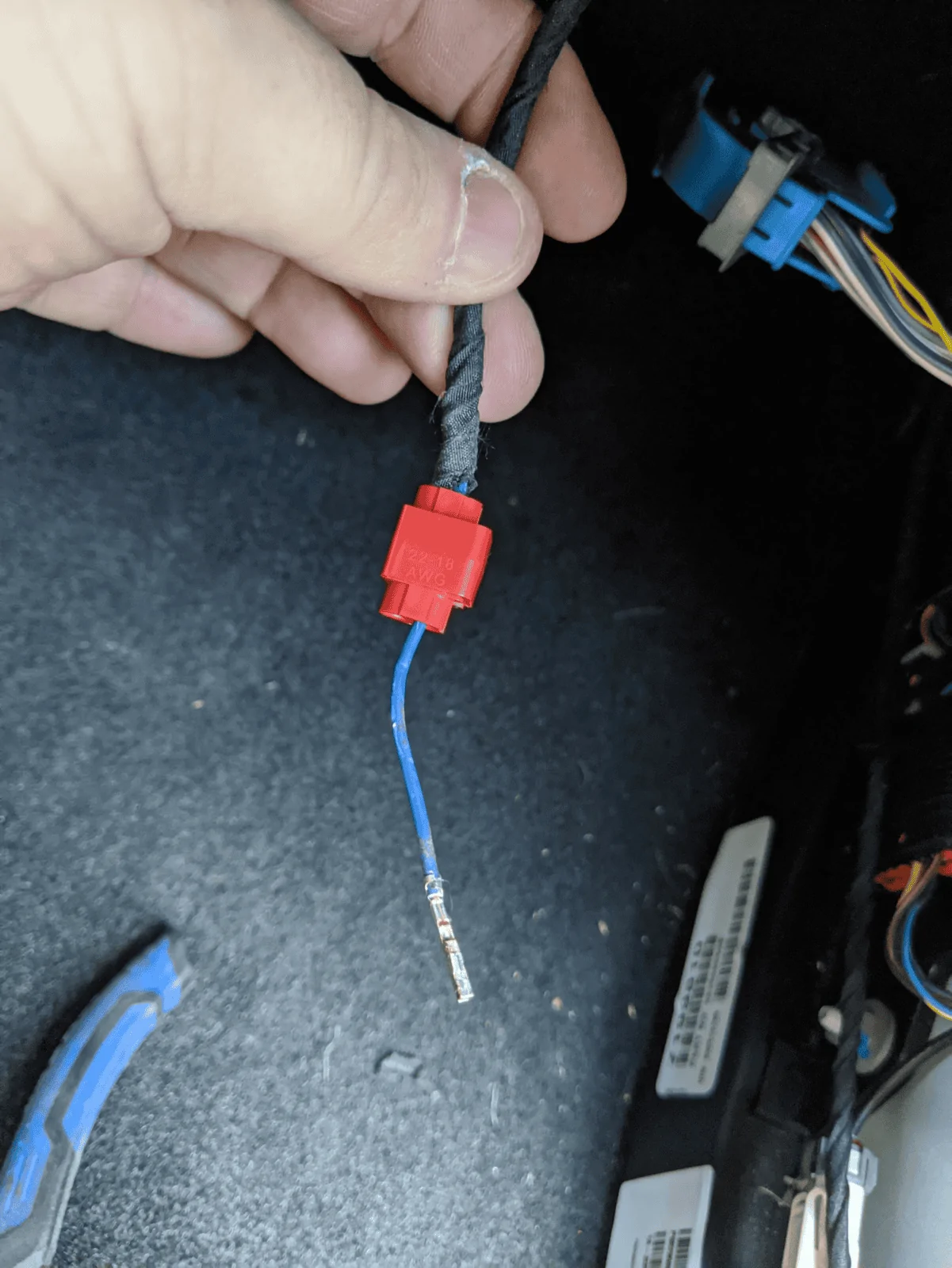

Thanks for this. I just did the same and it "fixed" it.
On that note - Paying $140 for a harness that doesn't work and having to splice wires is insane. I could've made that harness for literally $10.. The only reason I bought it was because it was "MOPAR" and "OEM". but it doesn't even work.
I took to dealer to try them having to code it, but it also didn't work. Your fix resolved it, for now..
Incase anyone is wondering... snipped off the connector for pin 7 and tapped pin 5 connector. I saved the end piece in case someone fixes this in the BCM in the future.
I'm happy to hear that and I agree 100%. There is almost zero need for the harness. I ordered because wanted everything to be OEM as well, but in the had to improvise and thus making your own harness would've been better. Oh well. Would be good for someone to take all the info and make an updated thread for future readers lol.
