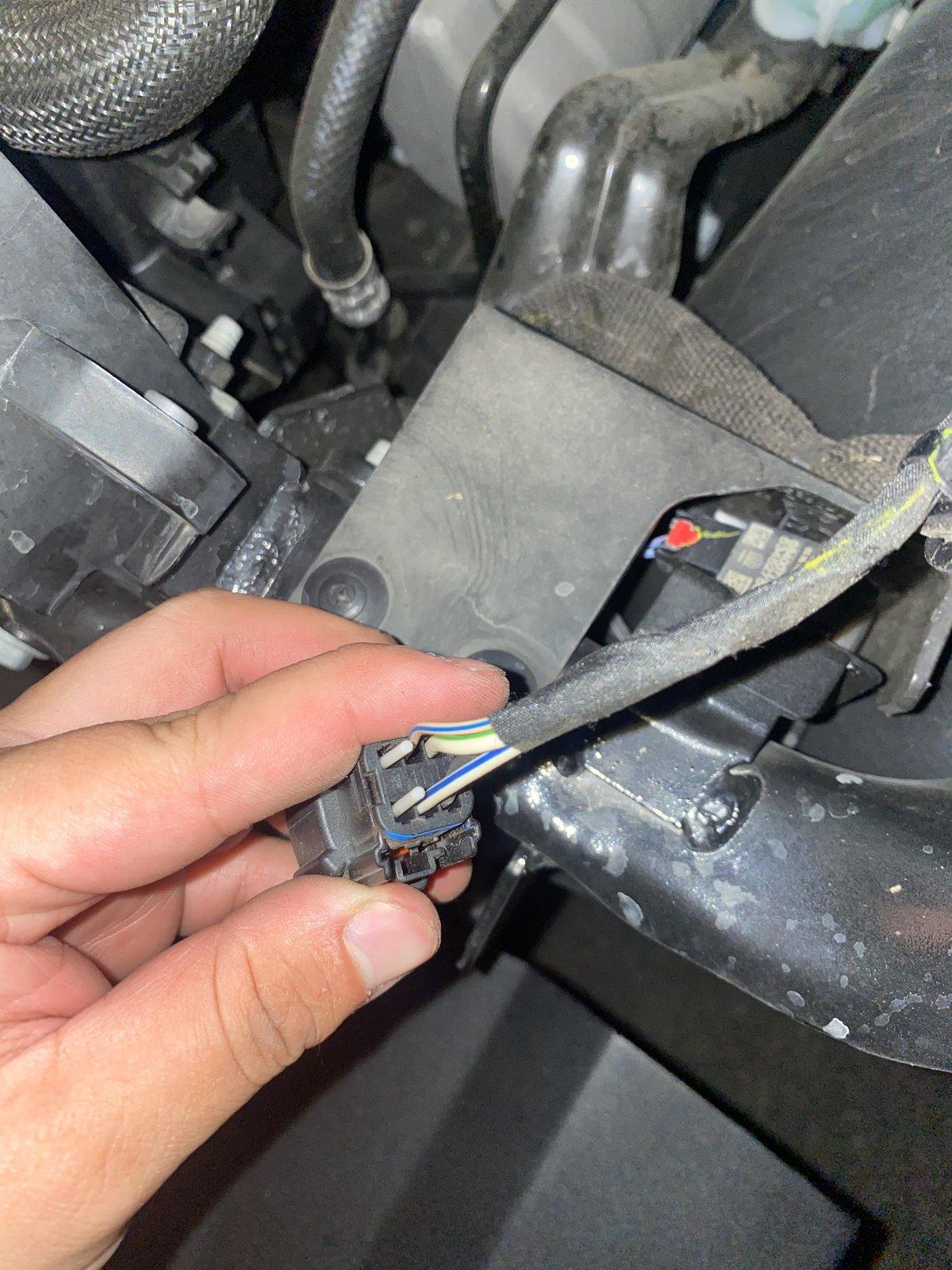

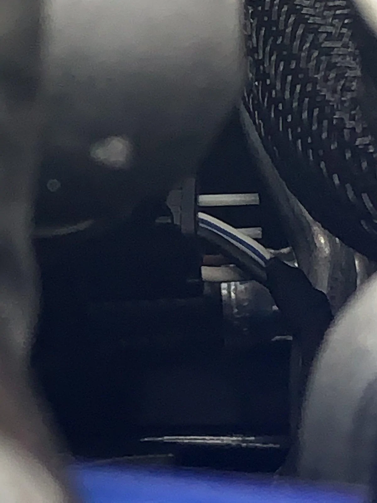

I can confirm my 2020 Jlu sport S came pre wired for halos ! I was happy until I realized the headlights I got have a angry eye mod and look dumb as hell lol about to
Open them up and tilt them back
Awesome so I have a 2020 JLU sport and it looks like I also have the proper wiring for halos on mine as well.

If there already is a wired pin in that location (cavity 5 at the headlight) you don’t need the halo harness; otherwise you'd see a white plastic pin there.. And at the BCM end, I suspect you'll find connector C1 already has wired pins occupying cavities 5 & 7.
There’s a fair amount of misinformation/confusion out there but after a lot of searching it appears that any JL optioned with LED tail lights was built with a full LED wiring harness.. (which includes conductors for the halos and different circuitry between the BCM & DRLs..
Lucky you! That means not only is the halo harness unnecessary but also front OEM LED turns/DRLs are plug and play (a dealer flash may be necessary but you won't need a Tazer)
If you check the Electronics, Electrical, Uconnect, Nav, A/V, CB, Cameras tech forum there’s a sticky thread with a link to download complete wiring diagrams..
Good Luck!!

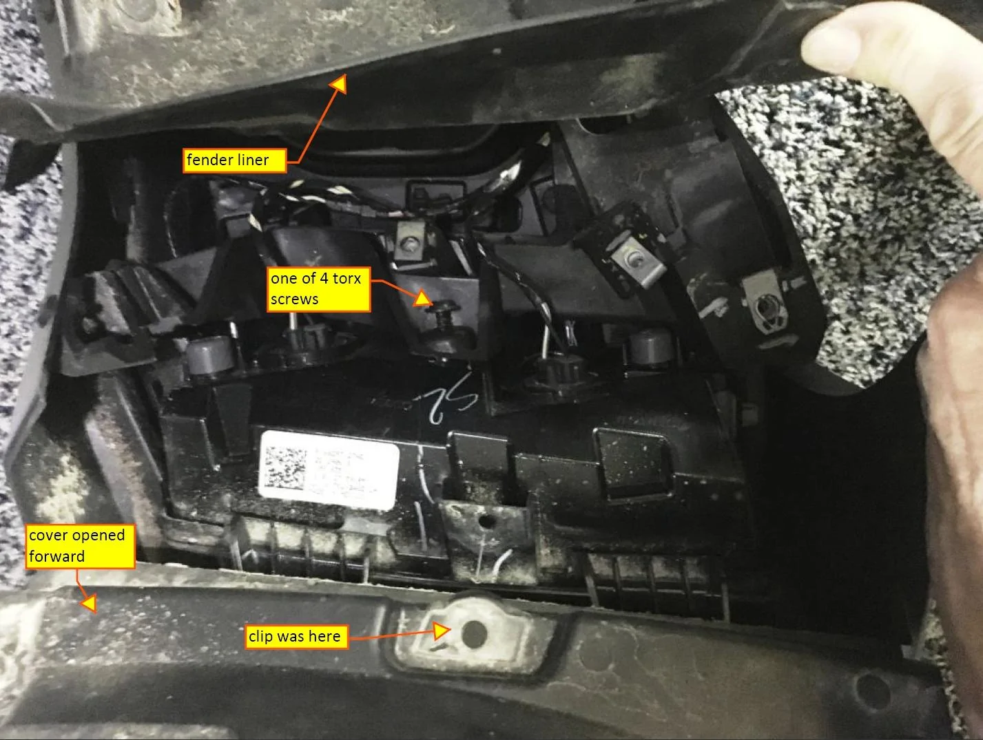

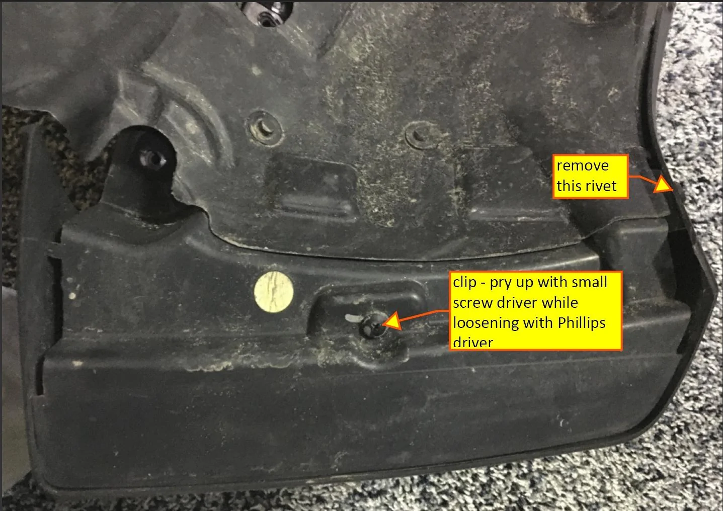

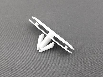

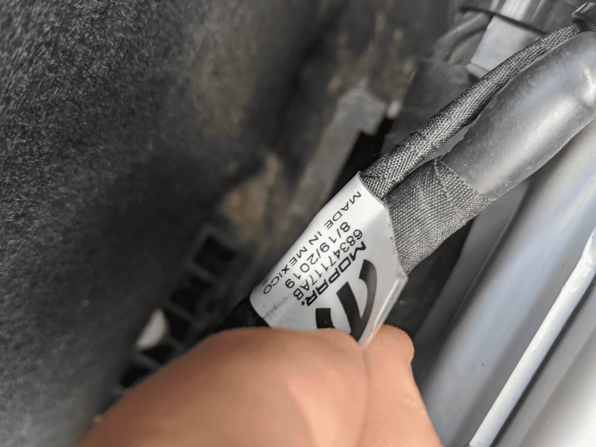

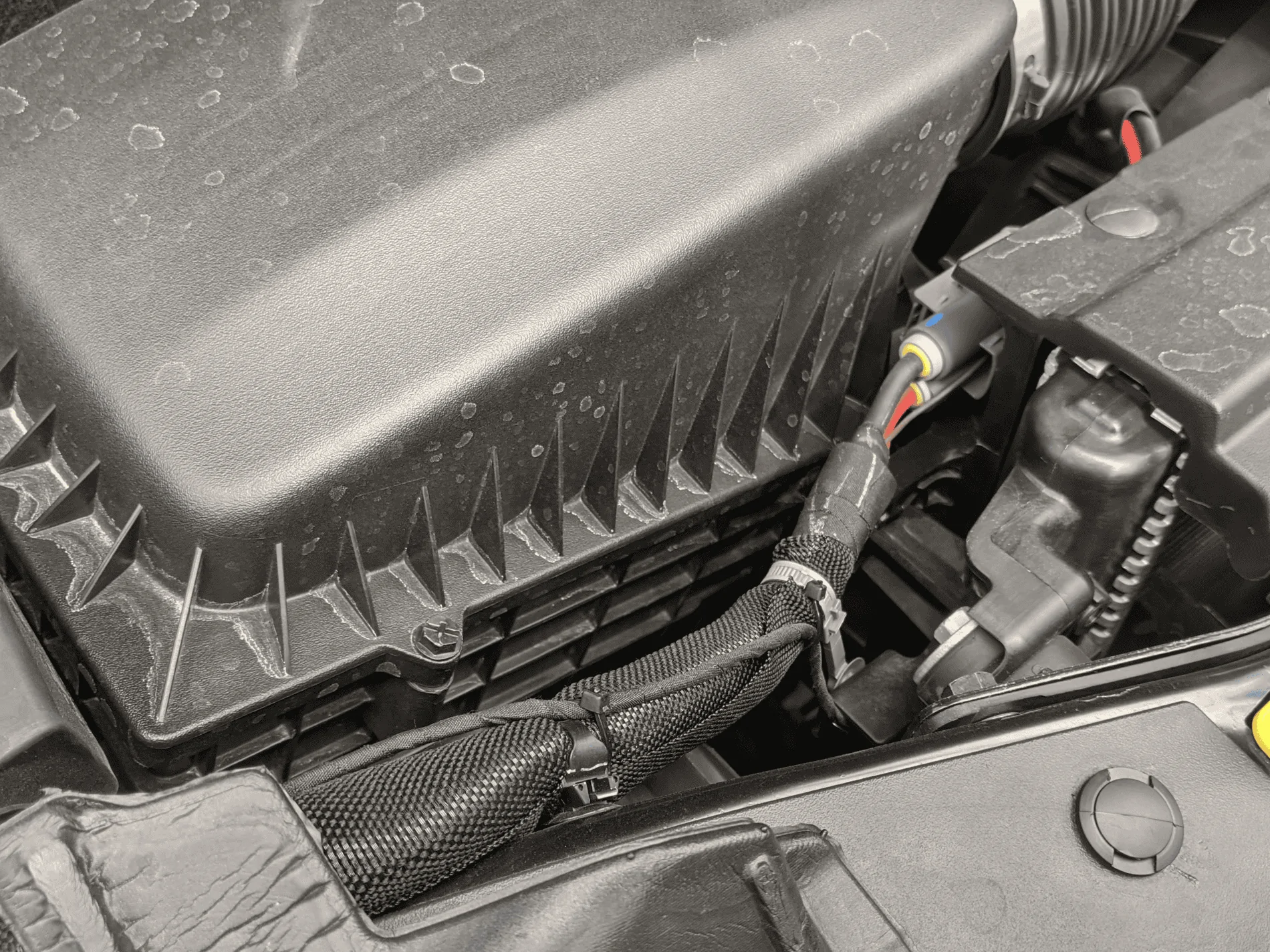

Installation is a bit tedious but fairly straightforward.. you'll want to purchase some new fender
clips
Jeep Wrangler JL MOPAR LED FACTORY UPGRADE KIT jl-wrangler-wheel-flare-clip-36
(PN 68395634AA / $2.25 each at the dealer or $0.67 each online) as you'll likely break a few on each side taking the fenders off. (taking the fenders off??) Yup, way easier than trying to do the switch-out with the fenders on..
This video is a good overview of the process
The fender harness unplugs from the body harness near the top of the rear of the wheel opening.. once you have the fender off you should only need to remove the first (front) rivet on the fender lip and the clip (looks like a Phillips screw but isn't) in the center of the signal housing cover to gain sufficient access to remove/replace the signal housing..
These photos are of opposite side fenders..
Jeep Wrangler JL MOPAR LED FACTORY UPGRADE KIT IMG-4574 clip notes
Jeep Wrangler JL MOPAR LED FACTORY UPGRADE KIT IMG-4572 open cover notes
You may have received two new rivets with your headlight kit, if not you can buy them but you'll also need a rivet gun to install them.. since the gun is around $25 to $30 I had my dealer install the rivets when I went back for my BCM reflash..
Don't do this! I placed my fenders top-down on carpet to (I thought) protect the paint.. didn't occur to me that messing around inside the fender liner would dislodge some grit; it did, that grit went onto the carpet and eventually under the fender..
Fender reinstallation is easy.. (don't forget to connect the fender harness to the body harness) just line up the clips in their respective holes and using your hand, pound around the fender to set each clip. If you break a clip, best to pull the fender off, replace the broken clip and then reinstall..
