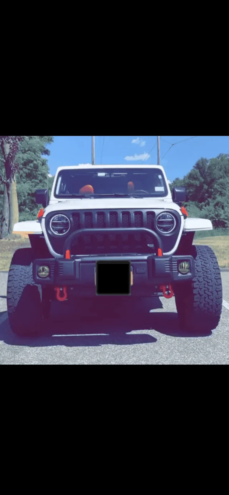

Jeep Wrangler JL MOPAR LED FACTORY UPGRADE KIT D7067608-FB4F-434F-808C-5BEABBAD206D
OEM LED headlights
LED fog lights with amber covering
American Adventure Lab highline LED sequential fender lights

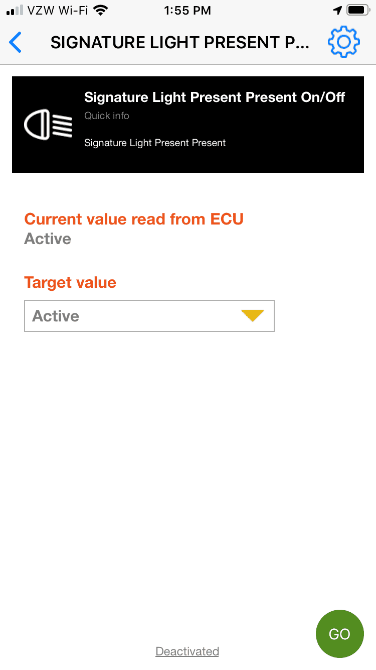

Hi all. Just wanted to report that the latest update to the JSCAN app (v7.8) has allowed me to get the Halo's to turn on that I wired to the BCM with the Mopar kit. I had done a full front-end Halogen-LED factory conversion and this was the final piece. Here are the settings that are in the Adaptation>DRL menu. Note the OE values are on the bottom of each image.

While I'm at it, these were the other settings.
Headlights:
Fogs:
Fenders(coming from Sahara dual-bulb halogen):
