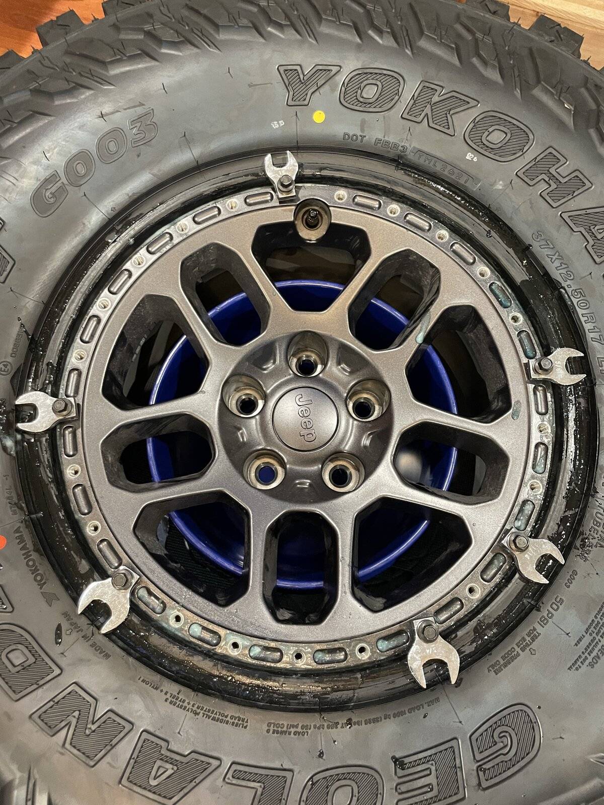

Here’s a photo of the mopar beadlock without the ring. This is when I was mounting my beadlocks. Just so you have an idea of what it looks like without a ring on it. The bead of my tire is mounted as a beadlock in this picture. Yours will be mounted inside the wheel as opposed to on top.

thanks for the photo description,. it doesn't look too too bad until i can find me some rings. i appreciated it man.
