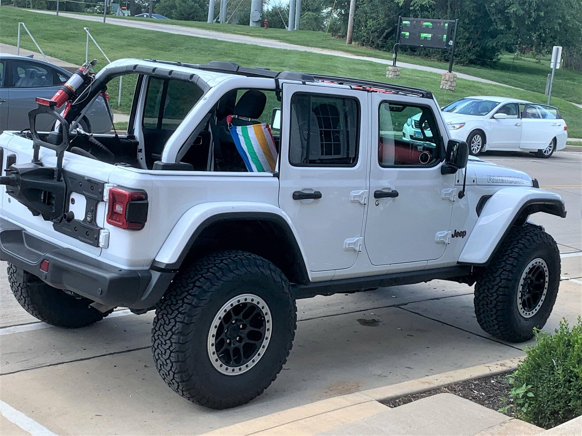

I'm running BF Goodrich T/A KO2 37X12.50R17 on Mopar Beadlock capable wheels with no problem and i have a Mopar 2' Lift and no spacers:
Jeep Wrangler JL 37x12.5 on Mopar Beadlocks? lautaro mods
Jeep Wrangler JL 37x12.5 on Mopar Beadlocks? 1659825437704

That’s promising, have you flexed it out?
Edit: I just noticed your rubicon badging, that looks real slick

i flexed it as much as i can given that i live in the Midwest...lol. Having said that, just because i can does not mean i will be going rock crawling and risk damaging my now +$60K Jeep..

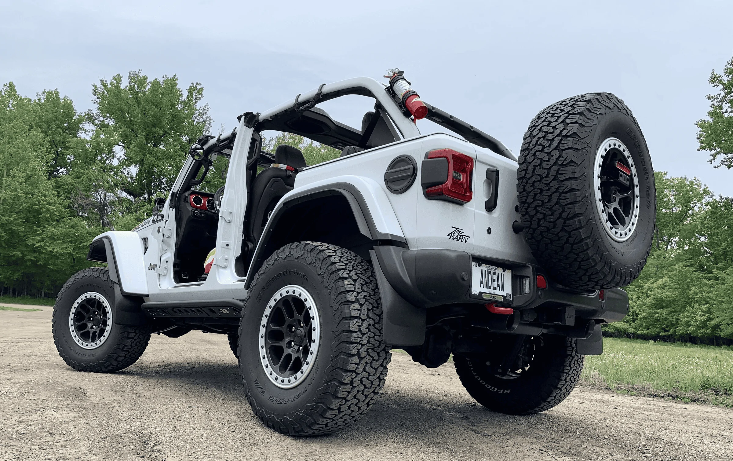

Tire Rack shows the BFG T/A as an overall diameter of 36.5
Jeep Wrangler JL 37x12.5 on Mopar Beadlocks? 1629828527994

Unfortunately, the real diameter is with BFG KO2 much smaller. I don't know why it's so much different but you can easily find the real values here at this forum. I have BFG KO2 315/70R17 which should be 34.4" but they are 33.5".

Thanks! I usually rely on Tire Rack's dimensions, but this is good info and disappointing.

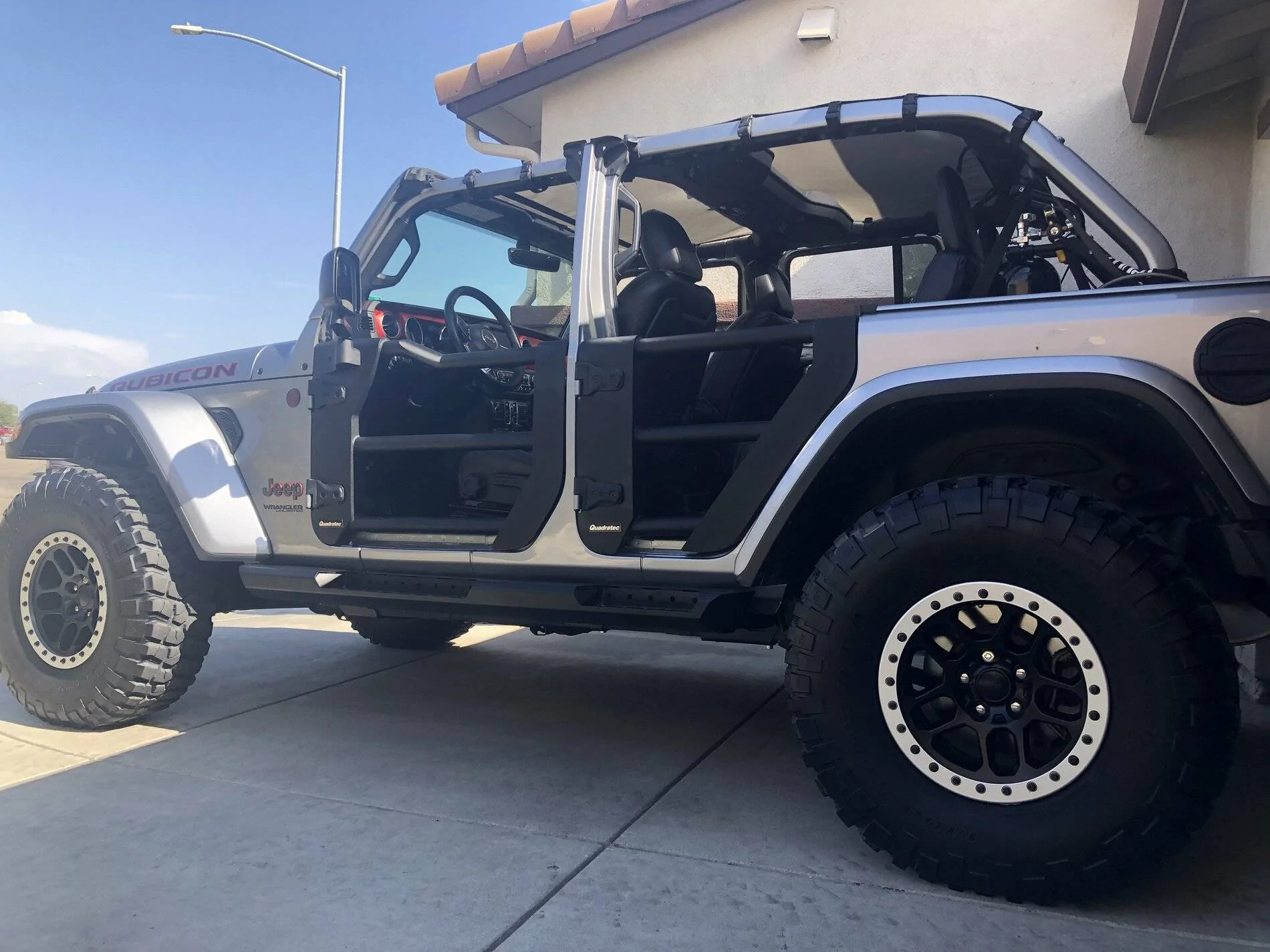

Yep Mopar beadlocks stick out a bit more. No rub - been on the Rubicon and aired down to 8psi on the Pismo dunes just ripping it…still no rub
Jeep Wrangler JL 37x12.5 on Mopar Beadlocks? 02CB56AB-ABD1-4247-A74A-1C1C3F9A9B56

Are you rims mopars? I have the XR wheels that are 17x8. Am I good to put 37’s with a 2” lift?

yes of course. i try to stay OEM whenever i can and i think these wheels along with perhaps KMC beadlocks look the best on these jeeps.
